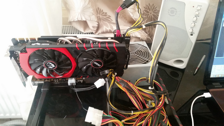

hello, i have an Asus K73SV
-i7 2670QM 2.2Ghz
-8GB of RAM
-Intel HD Graphics3000 + Nvidia GeForceGT540M
-Windows 8.1 Prox64
eGPU:
Exp gdc Beast v6
750W power supply
GTX 980 MSI Gaming
For the connections look at the picture :
So i want to use my GTX 980 but there are many problems
-I tried with de mpcie plugged in before boot but i had a blue screen, windows can't boot.
Edit : (ACPI BIOS ERROR)
-I tried with de mpcie plugged in after boot, while windows is running but the laptop freezed
-I tried to put the laptop in standby, plugged in and switch on, no problems, the eGPU fans accelerate but stop after some seconds and the eGPU isn't detected.
I don't know what to do if someone can help me please ?
(PS : sorry for my english, i'm french redface.png.pagespeed.ce.dPV5Cxx82c.png)
Help ??
