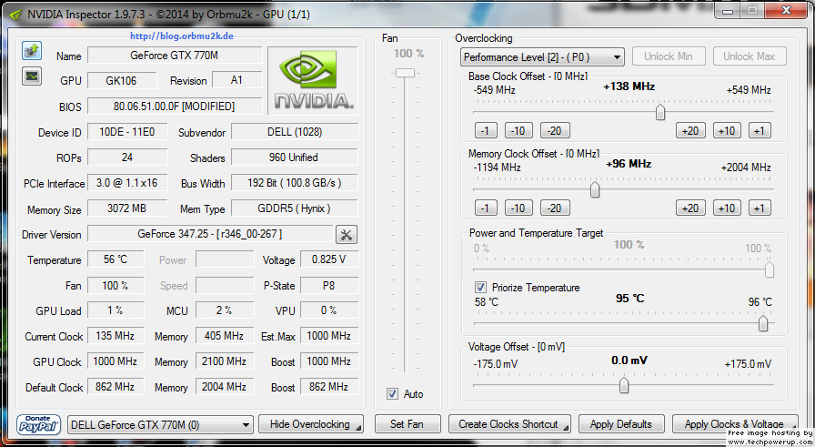

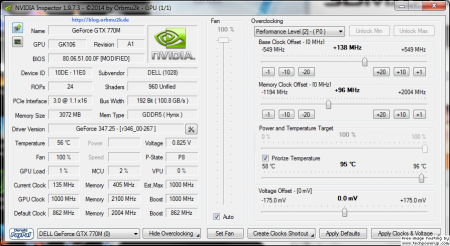

rslatara Posted February 8, 2015 Share Posted February 8, 2015 DELL GTX 770M 3GB with svl7 BIOS. BIOS A12 PRIMARY DISPLAY PEG SATA AHCI ALL OTHER SETTINGS OPTIMAL (yes don't disable audio) Download latest NVIDIA drivers. - Extract driver with 7-zip/winrar - Display.Driver folder -> open nvdmn.inf (notepad) Edit -> Replace -> Find What: 05AE Replace With: 0490 -> Hit 'Replace All' -> Save. - Extracted 334.67-notebook...International folder\ -> run setup.exe. Allow unsigned driver thingy! :Banane53:ENJOY! ______________________________________________________________________________________________________________________ M15X - Extract driver 7-Zip/winrar - Display.Driver folder -> open nvdmi.inf (notepad) CTRL+H -> Find What: 05AE Replace With: 02A2 -> Hit 'Replace All' -> Save. - Nvidia 337.50...International folder\ run setup exe. ______________________________________________________________________________________________________________________ Might work with other 700 series cards as it was for a 765m. ______________________________________________________________________________________________________________________ [ATTACH=CONFIG]13981[/ATTACH] Link to comment Share on other sites More sharing options...
