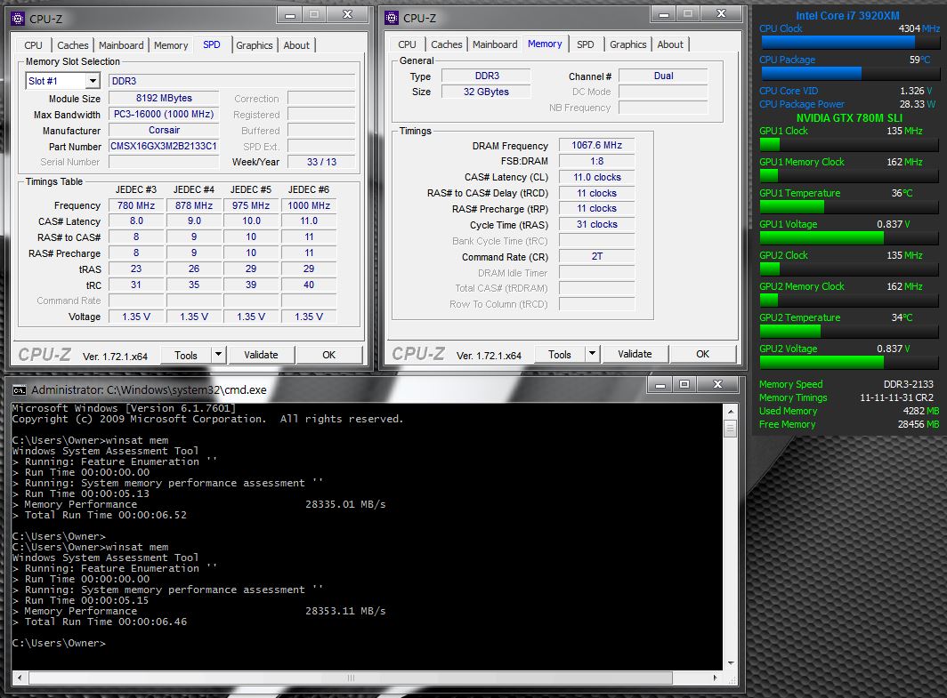

Its the bios/motherboard loads some of the automatic or XMP timings 0-3 lower on some latencies than programmed. So if you have 2133 11 11 11 31 it is loading like 10 10 10 29 and even other timings like that. So as you would figure this causes them to destabalize. I had pc issues yesterday will get you xmp for your P570 by tonight, very sorry I didnt get them made and sent yesterday. Ill try to make 2133 and 2400 so you can load the stock 2133mhz without manually setting those timings. Cheers buddy maybe we can together fix anyones Panther 5 with memory issues. The way mine loads is just like yours without modification. 1867 and its not even the right 1867 timings as a result. Working right on my system with modified settings. Hope truly to help you get yours where you want it. My p570 is my workhorse so am trying to get the most out of it as my Alien 18 is a sad excuse for a workstation due to the cooling. My 4940mx w/880m SlI in that system doesnt mean much the way Dell/Alienware left the EC. Corsiar Vengence/HyperX Impact/Samsung chips all ram I swear by. I have and used sets from each of these.

M18xR2 is booting with a 2400 XMP profile, but only running 2133, so probably one or two of the timings needs to be tweak. Thanks to @mw86, the P570WM is running 2400.

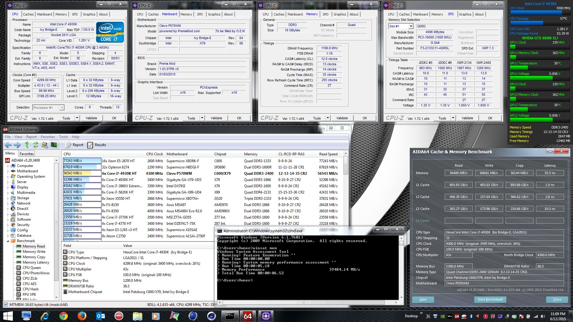

Hey bud just PM me we can email each other or Ill mention you in the thread here I had posted the XMP profiles to. they were posted the other day :) cheers bro. Your getting the chips I am using? That would be sooooo cool if so buddy. I bought mine from Amazon. have 3 pair lol of those kits 2 for quad channel on panther and 1 pair for dual channel on Alien 18.
[ATTACH=CONFIG]15234[/ATTACH]
Congratulations bro I knew together we could get it accomplished. Wow what nonsense in the ram timings on the Panther 5 lol right? In future if other Panther 5 users want my help I would offer to help program their stock timing to an XMP profile. As well as if they want to try 2400 or 2133 if it is higher than their stock ram speed. Cheers just glad to help and contribute to this great community. Love all my friends here :D You guys are all awesome!
