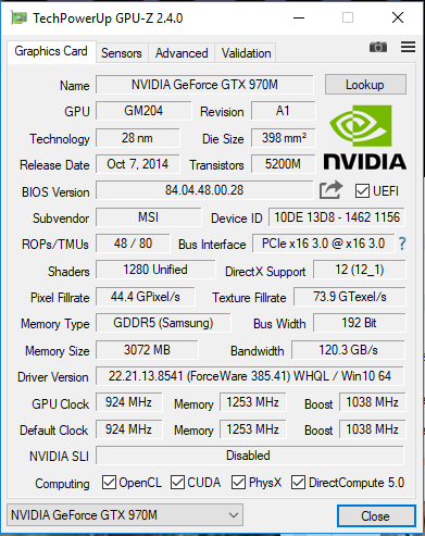

overclockerq9550 0 Posted September 18, 2017 Hi @Klem! I'm in the same situation, like the guys before me :'D I have a GT72S 6QD, with 970m 3gb, and I was wondering if you could help me with unlocking my vBios. I like my laptop, it's nice, solid and cool (i mean, my GPU never runs warmer than 68 celsius), and it would be nice, if I could overclock it a littlebit, to get the most out of it. I hope you can help me, that would be fantastic! Best wishes, and many thanks; Mark GPU-z screen of my GPU and last but not least my rom: GM204.rom Quote Share this post Link to post Share on other sites
Klem 754 Posted September 19, 2017 (edited) On 18.09.2017 at 11:42 PM, overclockerq9550 said: Hi @Klem! I'm in the same situation, like the guys before me :'D I have a GT72S 6QD, with 970m 3gb, and I was wondering if you could help me with unlocking my vBios. I like my laptop, it's nice, solid and cool (i mean, my GPU never runs warmer than 68 celsius), and it would be nice, if I could overclock it a littlebit, to get the most out of it. I hope you can help me, that would be fantastic! Best wishes, and many thanks; Mark GPU-z screen of my GPU and last but not least my rom: GM204.rom Ok. Check PM. Edited September 20, 2017 by Klem Quote Share this post Link to post Share on other sites
