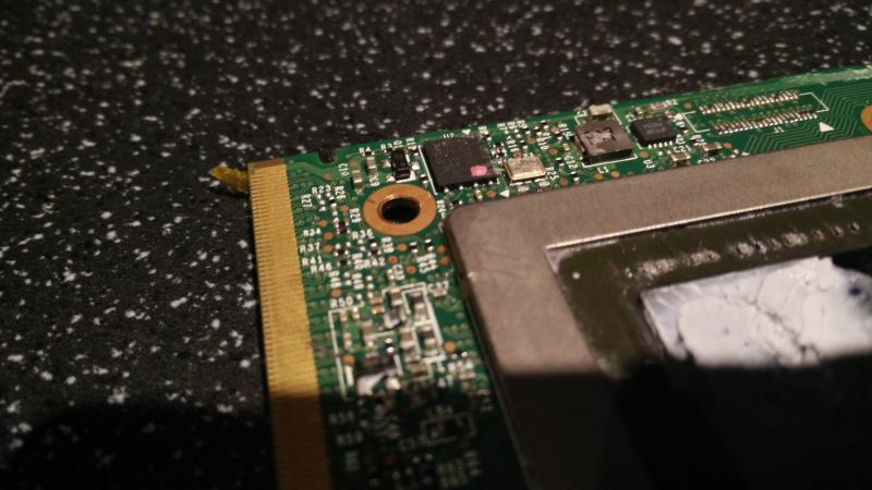

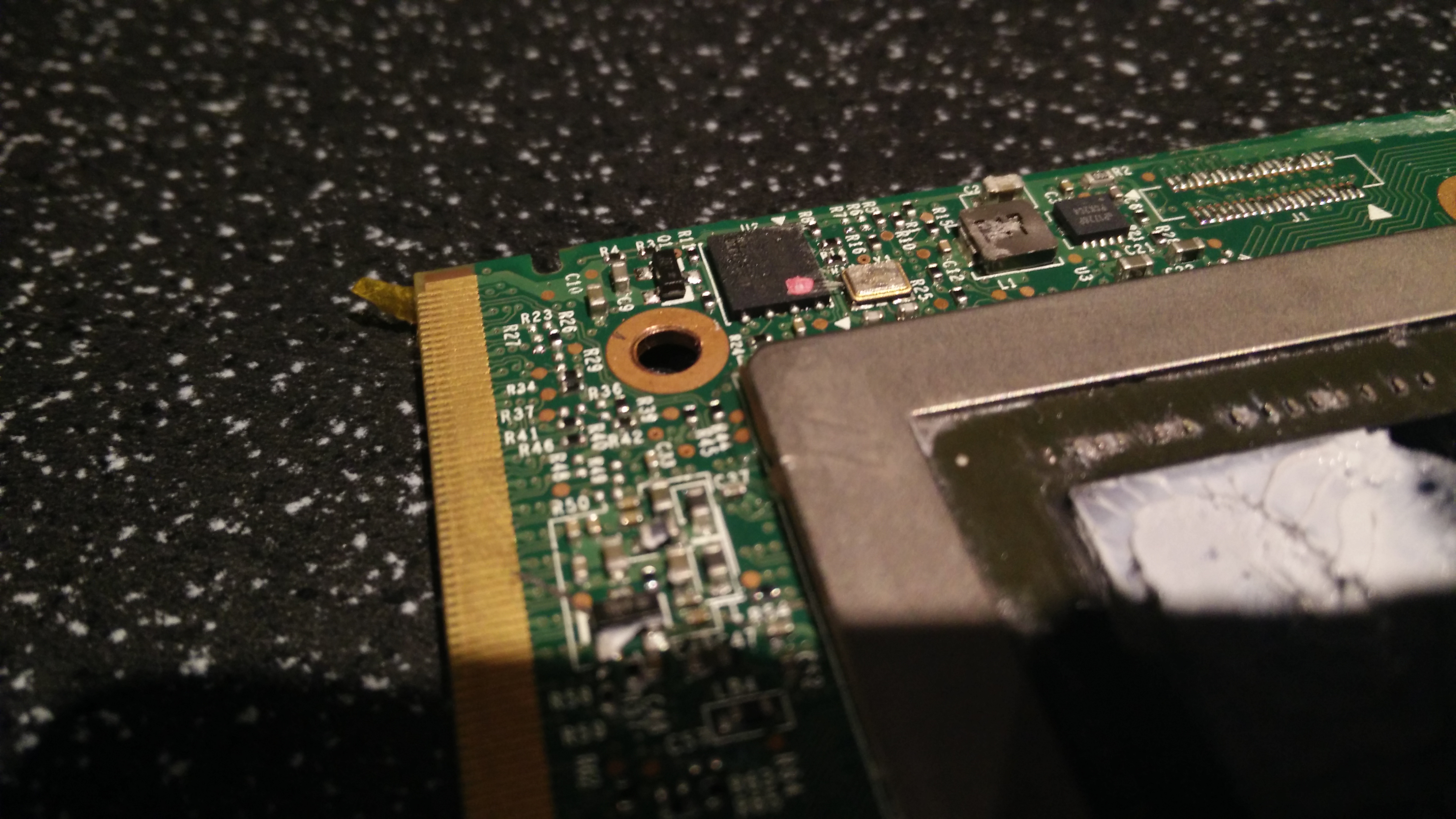

  2. I think this is the chip. Anyone can confirm ?

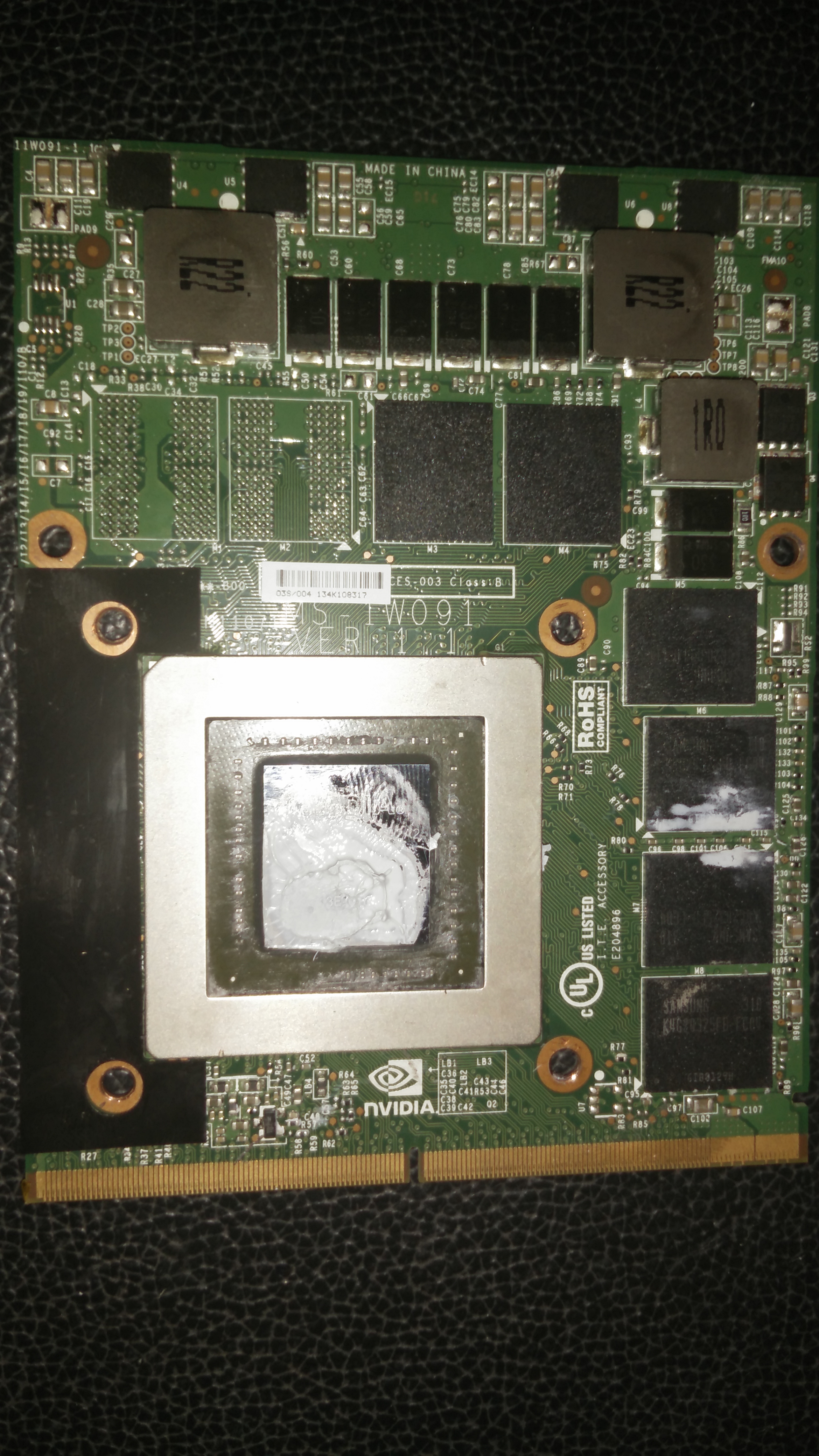

  4. Vbios is stored in eeprom memory which chip is on board but which one is it ? This is called Hard Flash....
  5. Please help me search for vBios EEPROM module on this card where is vBios stored. I bought Programmer but i dont want to flash wrong chip.
