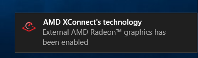

FricoRico Posted September 3, 2016 Share Posted September 3, 2016 (edited) Well here is my foolish attempt to get an eGPU working based on the RX480 in combination with a MacBook Pro Retina 15" (mid 2015) that has the R9 M370X dGPU. So far my attempts have been mediocre to say the least. The rMBP that I use has a variety of flaws that keeps me from accurately testing the eGPU right now. Flaw 1: The internal dedicated GPU Everyone around here knows that everything is much easier if you use a MacBook without any dedicated GPUs so that you can utilise either Optimus or some other AMD equivalent that is used under macOS. One would rather disable the dGPU when an eGPU is attached, but this is simply not as easy as it sounds for 2015+ MacBooks (see flaw 2). Luckily I got the eGPU working under macOS 10.12 while still having the dGPU enabled and functioning completely (3 GPUs, yay!). Windows is another story though, disabling the dGPU is possible only by using @goalque his experimental EFI USB application. Disabling the dGPU does not bring the profit that I was hoping for, as I run into the infamous error code 12 in Windows when the R9 RX480 is attached. Solving this is still under my attention but sadly I am not able to use @Tech Inferno Fan 'DIY eGPU Setup 1.30' (see flaw 2). I'm not sure if it is even possible to enable PCIe compaction without it or from an UEFI boot loader. Flaw 2: UEFI only bootloader With releasing the new MacBook Pro Retina, Apple thought it might be wise to update it's firmware so that it would support UEFI boot only. This means that I'm unable to boot from any MBR source, albeit Bootcamp or USB applications. This is a complete disaster and is devastating for my eGPU setup, as I have to reinvent the wheel every time and can't rely on great solutions like 'DIY eGPU Setup 1.30'. This also means that I can't use Windows so far to actually test or adjust the eGPU for the moment. Right now my eGPU is not running stable (see flaw 3) and I would very much like to under clock it to see where the cause of the problems lie. Flaw 3: Akitio Thunder 2 This flaw is the worst of them all and is the cause for my headache's the past couple of days. As many of you may know the Akitio Thunder 2 is a relatively cheap and fine Thunderbolt 2 enclosure, but it has one major flaw: supplying enough stable power. AMD cards are very power hungry over the PCIe slot (especially the RX480), this upsets the Akitio very much making it very unstable under load. So far I've tried several solutions to try and fix the stability (under macOS as Windows is still not working for me): Barrel plugging the Akitio Thunder directly to a PCIe power header on my PSU, without any changes to the Akitio board (freezing at scene 1/16 in Valley benchmark). Soldering two thick wires from the missing J6 header to the 16x lane PCIe ports as described here, while also using the manufactured barrel plug (freezing at scene 7/16 in Valley benchmark). Soldering two thick wires from the missing J6 header AND soldering the two missing capacitors at C4 and C3, while also using the manufactured barrel plug (freezing at scene 10/16 in Valley benchmark). Soldering two thick wires from the barrel plug positive pad to the 16x lane PCIe ports without using C4 and C3 anymore (freezing at scene 8/16 in Valley benchmark). Using a quality powered PCIe 16x riser connected to molex connector on PSU while using custom barrel plug for Akitio, without changes to the Akitio board (freezing at scene 7/16 in Valley benchmark). Using a quality powered PCIe 16x riser connected to molex connector on PSU while using supplied Akitio power adapter (to avoid 12V power rail instability), without changes to the Akitio board (freezing at scene 8/16 in Valley benchmark). So far I've tried everything I could find or come up with, but maybe there is one other solution to get the Akitio to work or maybe I should just give up on the Akitio all together, hoping that another affordable box is more stable. I would very much like to under clock the RX480 or even test it under Windows (as their drivers have fixed some of the ridiculous PCIe power draw). But flaw 2 is keeping me from it and this pisses me of my now. The Akitio supplied power brick outputs a steady 12.28V under all circumstances. Using the multimeter I was able to make the following readings on the 12V rail when only having the GPU and PCIe riser attached: Under idle: 12.02V Under load: 11.90V Under crash: 11.97V I'm really hoping that posting my findings will help others, but maybe someone on the forums have successfully dealt with AMD eGPU power problems before (without spending a $1000 on a Netstor). I use the following hardware for my setup: Akitio Thunder2 PCIe Box XFX Radeon RX480 XXX OC Backplate (RX-480M8BFA6) MacBook Pro Retina 11,5 (R9 M370X version) Corsair SF450 Any help is more than welcome! References: Edited September 3, 2016 by FricoRico Quote Link to comment Share on other sites More sharing options...

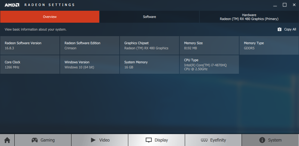

FricoRico Posted September 4, 2016 Author Share Posted September 4, 2016 Thanks @goalque! I tried that before but you convinced me to try it one last time. I payed extra care on the soldering used Chipquick for an extra clean soldering result. Also soldered in C4 and C3 as suggested in another post. I come with great news! I managed to get the RX480 working and 'stable' in Windows 10 using the latest Crimson drivers (16.8.3). I used the supplied steps above, using your application to boot into Windows. As before the eGPU gave me a whoosh and also a screen (booting 10/10 into Windows now). Then went for the 3D Mark 11 Advanced test and hoped for the best. I was rewarded generously with a great score and no crashes: http://www.3dmark.com/3dm11/11550574 I couldn't be more excited! For now, I haven't tested Valley on Mac OSX yet and went straight for a Windows test. I suspect that I will still see freezes and crashes under Mac OS because I suspect that their driver does not incorporate the PCIe power draw fix like the Linux Kernel and Windows drivers do. Hopefully AMD will fix that in the future, but that is pure speculation. For future refrence by others, these are the steps I took: Soldered in C4 using 10uF 16V capacitor and C3 using a 100uF 16V capacitor that I had laying around Wired two thick wires from J6 to A1 and B2 on the PCIe 16x lane Created a barrel plug with a double ground and a double 12V wire Used insulation tape to isolate the PCIe points A1-3 & B1-3 on the Thunderbolt board I will disclose the software side later if @goalque allows me to. I'm not sure if we want to keep the procedure confidential for now as well. Thank Bizon Box for this non-sense, this should be open-sourced! 1 Quote Link to comment Share on other sites More sharing options...

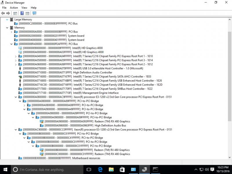

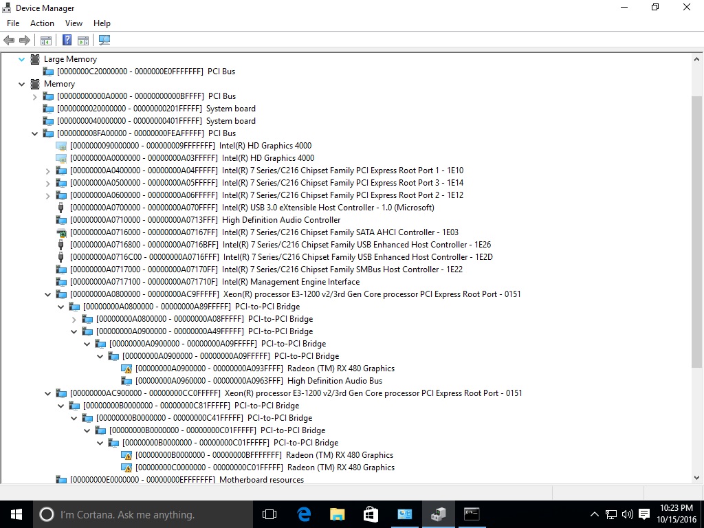

boeonoz Posted October 16, 2016 Share Posted October 16, 2016 (edited) Just now, FricoRico said: For me the iGPU is also not showing, this seems to be correct behaviour. The fact that it crashes soon after seems to be a PCIe power issue to me. Other than that, 16.10.1 should also work, have you tried doing DSDT Override with these drivers as well? I am not sure about the Highpoint Rocketstor 6361A, I've seen it on the forums before and indeed the molex seems promising. Not sure on the components that come after the molex power though, these must also be rated for the right amount of power. The R9/RX series are really hard to please when it comes to powering them. I am trying to change ULPS/PCIe Power Management but haven't read it thru. OH I didn't know that your iGPU won't work too. Anyway once I get both to work but with Error 31 on Rx480, So I have HD4000 and Rx480 (Error 31) display multi screen. I don't know how I did it, just try many thing around it happen during I try to fix system crash. I didn't use goalque script now since I only have DEMO it cannot boot Windows/OSX. EDIT. Just add PCI BUS , is it wrong? Currently is Error 43, I will switch to 16.7.1 to test it again. Edited October 16, 2016 by boeonoz Quote Link to comment Share on other sites More sharing options...
boeonoz Posted October 16, 2016 Share Posted October 16, 2016 (edited) OMG! I got it to work!! I have to salute you @FricoRico and @Tech Inferno Fan It really Rx480 PCI-e x16 BUS power issue. Power 8pin LED stable so I think overall ok, but it's not. Now I change my setup a bit by separate Power rail to X16 Board and X4 TB Board, now it work. I have seen other setup user 1 rail for both. Really thanks. Gonna benchmark now. Anyway I still confuse, card can pass stress test on macOS LuxMark 3 with 1 rail power. Edited October 16, 2016 by boeonoz Quote Link to comment Share on other sites More sharing options...
FricoRico Posted October 16, 2016 Author Share Posted October 16, 2016 4 minutes ago, boeonoz said: OMG! I got it to work!! I have to salute you @FricoRico and @Tech Inferno Fan It really Rx480 PCI-e x16 BUS power issue. Power 8pin LED stable so I think overall ok, but it's not. Now I change my setup a bit by separate Power rail to X16 Board and X4 TB Board, now it work. I have seen other setup user 1 rail for both. Really thanks. Gonna benchmark now. Anyway I still confuse, card can pass stress test on macOS LuxMark 3 with 1 rail power. Make sure you pass the 3D Mark 11 Physics Tests a couple of times. This is a good indication for a stable eGPU 1 Quote Link to comment Share on other sites More sharing options...
boeonoz Posted October 16, 2016 Share Posted October 16, 2016 (edited) 1 hour ago, FricoRico said: Make sure you pass the 3D Mark 11 Physics Tests a couple of times. This is a good indication for a stable eGPU Ugh, it died half way thru benchmark. There is no compatibility mode setting in 16.7.1, because of Xconnect? I cannot reinstall driver, system will freeze. After I taking riser card out, system a bit more stable. Complete a few benchmark, some got higher score than my old desktop (i5-750). Got P12761 in 3Dmark 11 Performance Complete 2 benchmark, but problem is I need a riser to fit in case. This is critical hit! 9999!! Edited October 16, 2016 by boeonoz Quote Link to comment Share on other sites More sharing options...
Tech Inferno Fan Posted October 16, 2016 Share Posted October 16, 2016 59 minutes ago, boeonoz said: After I taking riser card out, system a bit more stable. Complete a few benchmark, some got higher score than my old desktop (i5-750). Got P12761 in 3Dmark 11 Performance Complete 2 benchmark, but problem is I need a riser to fit in case. This is critical hit! 9999!! Didn't see mention of a riser before. Yes, a riser degrades the gen2 signal and explains your instability. If you need to use it in a chassis then consider transplanting your TB enclosure internals into your chassis. 1 Quote Link to comment Share on other sites More sharing options...
boeonoz Posted October 16, 2016 Share Posted October 16, 2016 Just now, Tech Inferno Fan said: Didn't see mention of a riser before. Yes, a riser degrades the gen2 signal and explains your instability. If you need to use it in a chassis then consider transplanting your TB enclosure internals into your chassis. Sorry, I get same result of error and system freeze with riser and without it, I forgot to mention it. T_T But now everything is stable Thanks to you both, I think I will start a benchmark setup thread soon. Only problem is driver issue, but I will try it later on. Thank you again. Quote Link to comment Share on other sites More sharing options...
