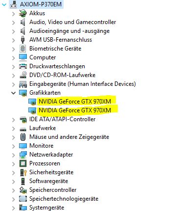

Windows 10 and nVidia stopped support and close down the new driverssupport for your machine.
First you have to modify your new driver, nvidia does not more support older clevobooks with new graficadapters. Only machines support, who get the rare Prema V3 Bios Versions (only for high cash from Eurocom).
Modify
http://null-bin.blogspot.de/2015/08/how-to-modify-nvidia-notebook-driver.html
Second you have to instruct Win10 to accept your moddified drivers.
Deactivate Windoze checksystem
https://www.deskmodder.de/wiki/index.php/Treibersignatur_deaktivieren_Unsignierte_Treiber_installieren_Windows_10
That are the problems.
Sorry for my bad english
Here is a example mod file for the Clevo P370EM and a nVidia GTX970XM
nvcvi.rar
