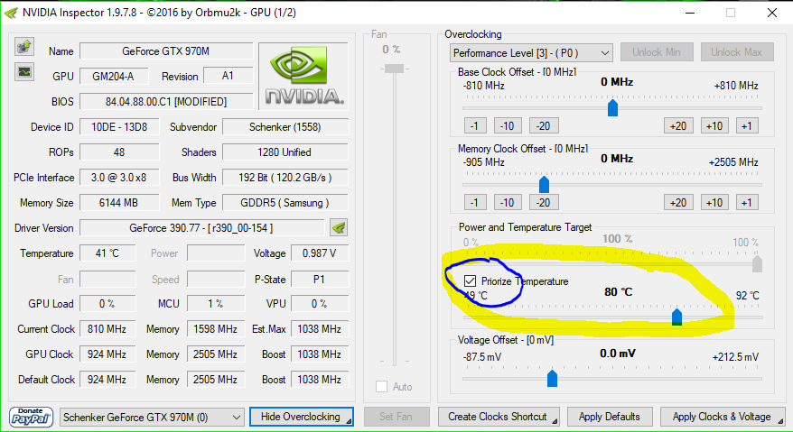

  1. Check your machine with the nvidia inspector and look if you can use the temperature controller to priorize the temps. Look at pic... Next use Liqiud Metall for your cooling system beetween die and the heatpipes...u will see, its works fine. The best is CoolLaboratory LIQUID Pro, alle others are bullshit. This is tested with 80 others pastes and liquids. Regards
