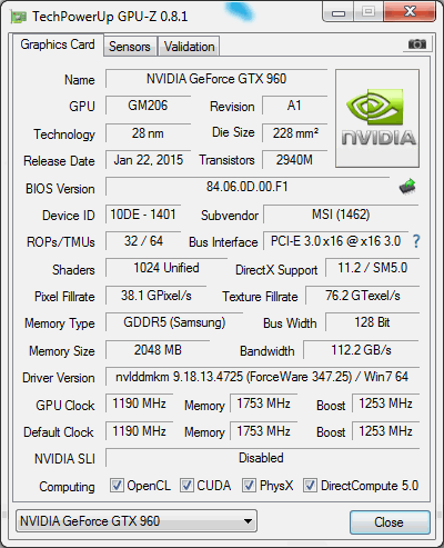

@Chevrotine669 You cannot checked. It shows what's your GPUs capable of and read / detected by the system or Driver.
Here's the example of other's MSI GTX960 i've found on the net

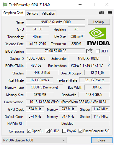

and here's my eGPU with Quadro 6000:
Is it possible to check your 960 on a desktop computer? or use other PCIe cards on your eGPU just to make sure both are OK. Since you have mentioned in first post that it worked without Error 43.

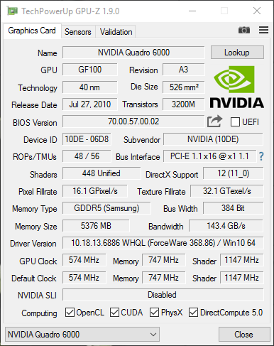

[EDIT] My mistake, PhysX System Software must be Installed in order to run properly and detected by GPU-Z. The rest feature is by default Installed by the Driver.
Download PhysX System Software: http://www.nvidia.com/object/physx-9.16.0318-driver.html
Download PhysX FluidMark to test: http://www.geeks3d.com/20130308/fluidmark-1-5-1-physx-benchmark-fluid-sph-simulation-opengl-download/
I just installed it and it's greatly improves PhysX benchmark.
Edited by ssamydla
