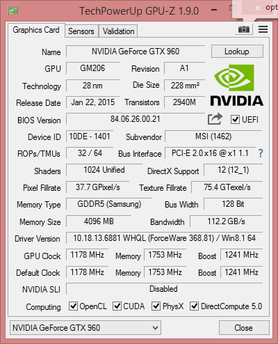

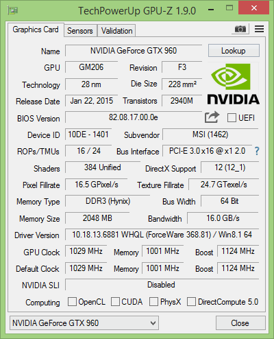

  1. I just discovered the following: The code 43 is still my main issue, but I can get rid of it after RE-installing the proper driver. But there's a catch. If I restart my laptop, it's here again. Code 43 appears once again... At least I got it to work (even for a short period), which means that it's at least functionnal. And here is the GPU-Z after the re-instal: So that seems to be good news isn't it?

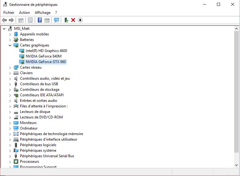

  3. I actually have: My intel graphics (obviously) A Nvidia 840M (iGPU) And my Nvidia 960 (eGPU) So .. Anyways. I left everything like it was when I opened it. You're telling me it's supposed to be checked? does checking it by myself work? Wait! Would be too easy, right?

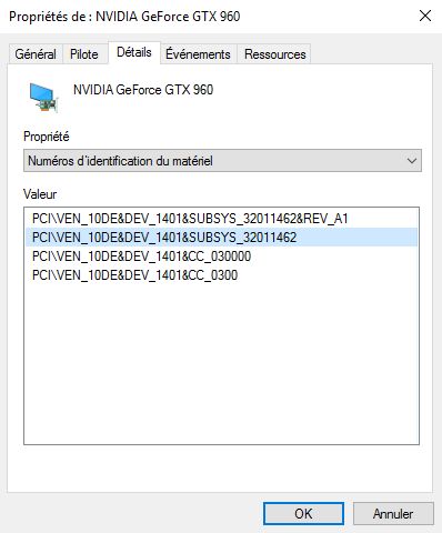

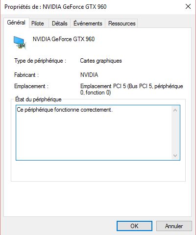

  14. Yes, it fails while trying to install the driver. have a look a these screenshots: no warning sign on the 960 line (little triangle...) And "ce périphérique fonctionne correctement" means "this device works properly". Oh, and here are my hardware IDs just in case you wanted to be sure.
