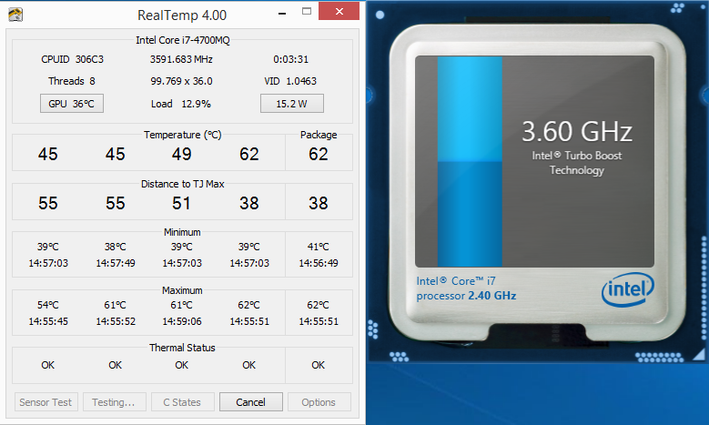

Core Temperature = TJ Max - Digital Thermal Sensor (DTS) reading All software uses the same formula to determine the core temperature of any Intel Core i CPU. All software reads the exact same temperature sensor. To convert that data to a core temperature, software must use the correct value for TJ Max. Since November 2008 when the first Core i was produced, software has been able to read this value from each core of each and every Core i CPU. Almost 6 years later and SpeedFan is still not doing this correctly. It is using a value of 85C for TJ Max. That is wrong. RealTemp and ThrottleStop read the correct value from the CPU and that is 100C. That is why SpeedFan is reporting the wrong core temperature. There is a way to go into the SpeedFan configuration file and change this from 85 to 100. If you do this, SpeedFan will start reporting the same temperatures as every other monitoring program will report for your CPU. It would probably take 80 watts or more when running Prime 95 on a typical 4th Generation Core i7 Quad core CPU. The 4700MQ has a TDP rating of only 47 Watts. That is not nearly enough to run Prime 95 at full speed so the CPU throttles by reducing the multiplier. The screen shot you posted here http://forum.techinferno.com/lenovo-ibm/7204-need-help-y510p-tempreture.html#post98923 shows that your CPU is at 47.1 Watts. The multiplier has been automatically reduced to 27 to keep the CPU right at the power limit. You can not use ThrottleStop or any software that I know of to overcome this limit. With a modified bios, you might be able to run this CPU long term at over 47 Watts but then it is likely that your CPU temperature is quickly going to become the limiting factor. Edit - ThrottleStop also shows TDP Throttle. That means your CPU is throttling because it has reached the TDP power limit, 47 Watts. I am slowly working on a new version of ThrottleStop. It has a few more features like overclocking and CPU voltage control for the 4th Generation CPUs like you have. ThrottleStop 7.00 beta 2 https://www.sendspace.com/file/xrar30
