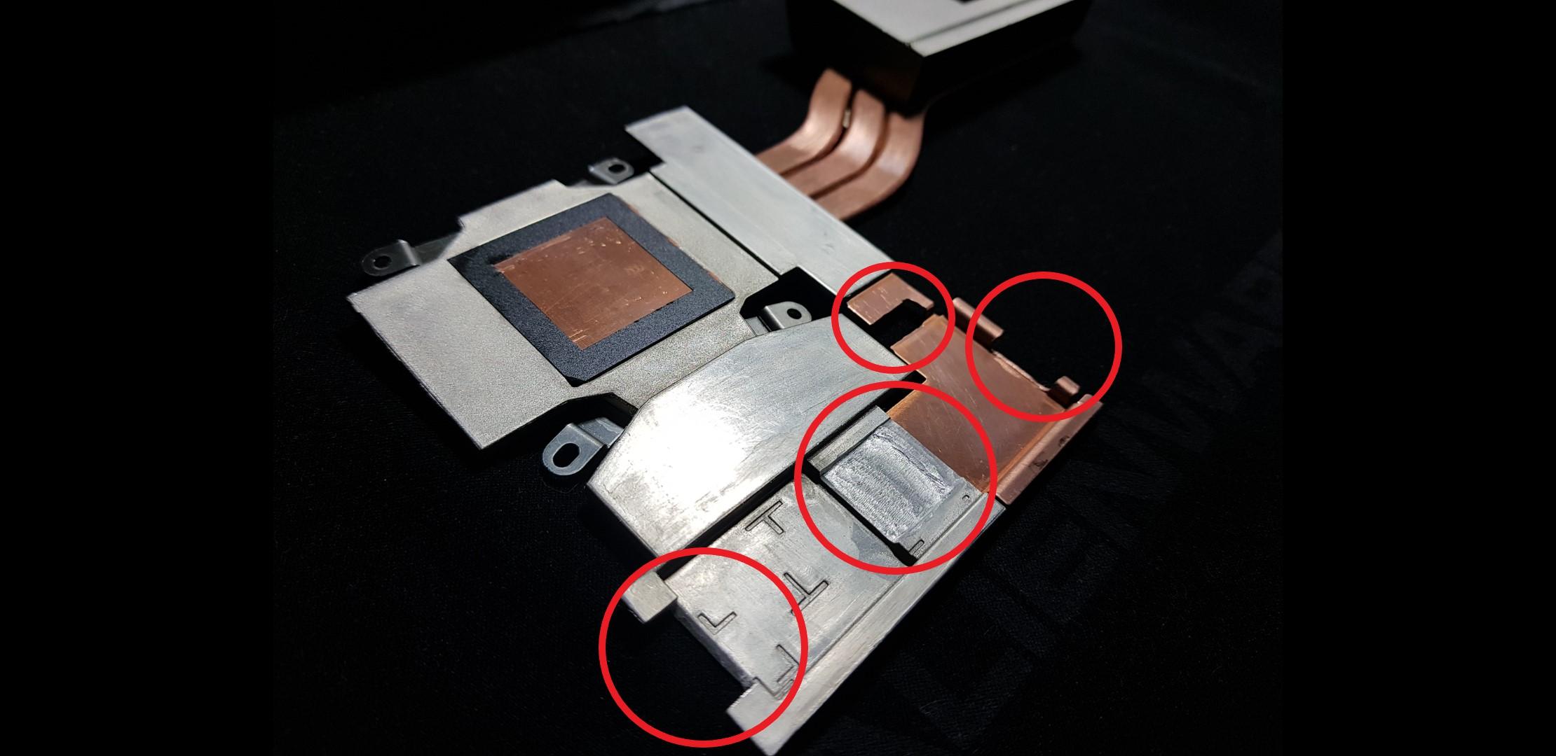

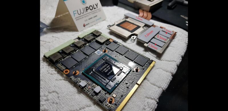

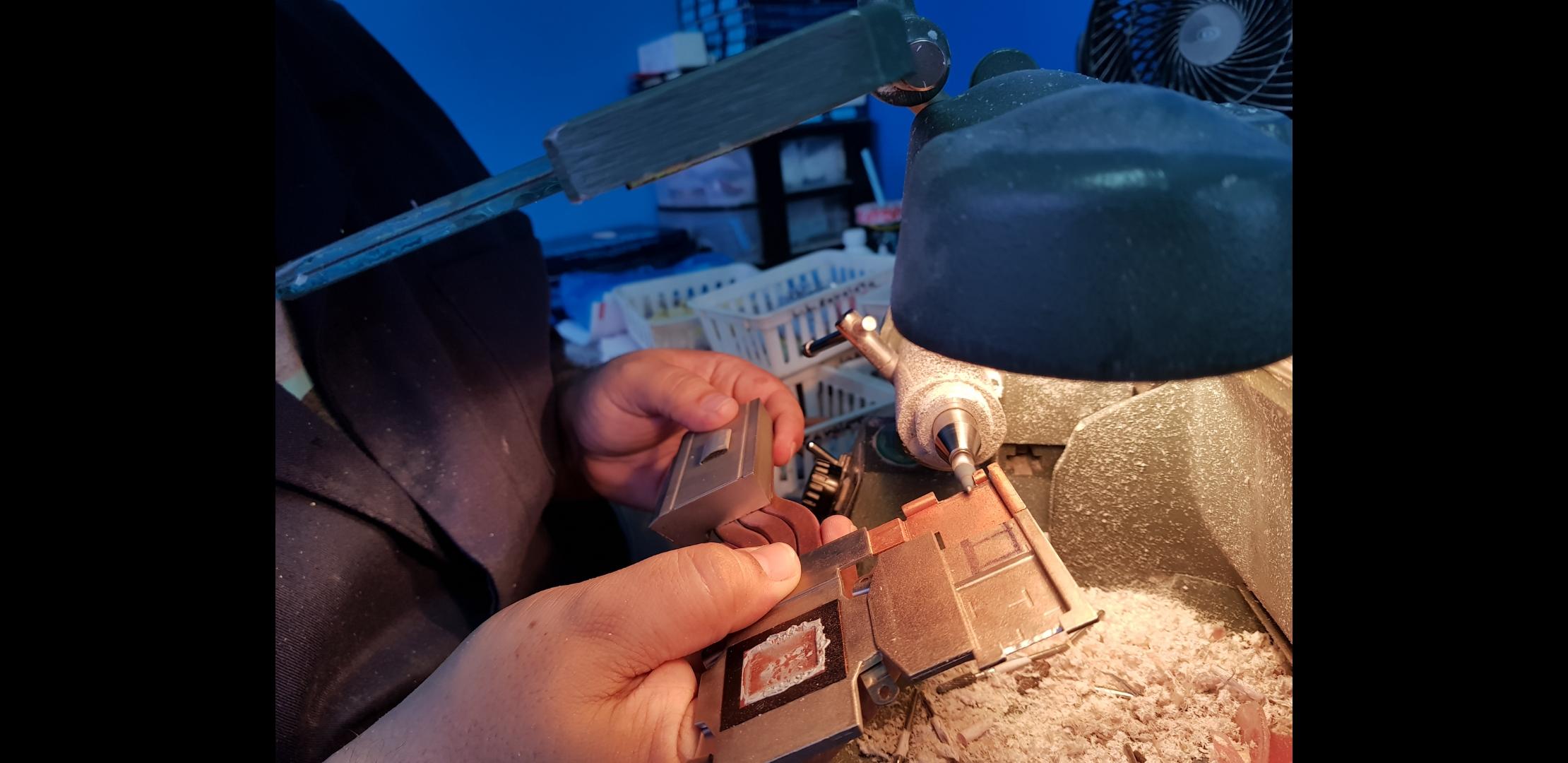

Alienware m17x R4 gtx1070 upgrade Successfull
handale30 replied to handale30's topic in Alienware M17x / AW 17
GTX 680m Heatsink modding in 4 spots to fit the GTX 1070. These are the different sizes I had to use and the high temp electrical tape can be seen on the GPU as a secondary measure on top of the conformal Liquid metal about to be applied to CPU and heatsink. MG chemicals Silicone conformal Coating applied to CPU and GPU PCB boards to avoid short circuit. -
