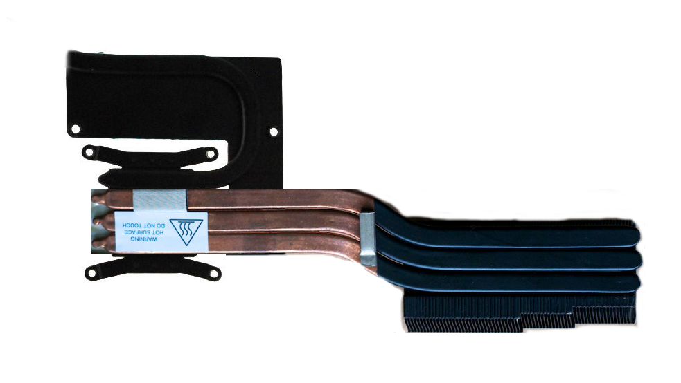

Hello, I don't have pictures but it was something like this: Main DIE big copper plate and VRMs plate was from MSI heatsink as I explained in first post of this thread, 3 copper stripes and radiator was from stock heatsink. Anyway, even with such a modded heatsink when I was using the 330W PSU and reached full power there was still thermal issue, the system still needed to be improved. I see now Eurocom offers such an upgrade, but with standard MXM form factor GTX 1070: http://forum.notebookreview.com/threads/quadro-p5000-with-m17x-r4.800489/page-8#post-10625469 (at least it's same width as standard so it can fit easily) The card just looks just the same as Gecube one: https://item.taobao.com/item.htm?spm=a230r.1.14.34.7132bccaqt2kP9&id=557169195143&ns=1&abbucket=7#detail Gecube 1070 is rated as 115W TDP, while MSI one should be higher I guess. I saw mine over 125W on HWinfo when reaching 100% load. I think MSI card is such a beast it gets real hot, Gecube one must be a little less powerful but it should also get lower temp on the other hand. Other good thing is it looks like Gecube one can be used with stock heatsink. My advice is if someone want to make this upgrade nowadays, then go for the Eurocom / Gecube card. Form factor will avoid to dremel the chassis, and there is no huge heatsink mod to do. Also, it probably runs cooler so I think that's the way to go IMHO. Have fun and high FPS

Hello, Yes in fact I made a modded heatsink using M17x R4 100W 3 copper stripes heatsink and a MSI heatsink same as this one: https://world.taobao.com/item/540331819333.htm When GPU was not at full load, I had temps around 70 to 75°c max while gaming, which was good. But now GPU can go up to max 99% load, it's getting hot as hell! After playing around 15 or 20 minutes, it can reach up to 85°c so I'm at hardware overheat level, this is a problem. I need to find a way to cool it down. I already swapped the 3940XM which is getting way too hot for my previous 3840QM, but it's not changing GPU temp at all. It still increase minute after minute. I don't know if I should give a try to a cooling pad, or if I'll watercool the GPU, or the whole setup. Maybe I could also try to improve my modded heatsink by adding it a pair of copper stripes. There is a real thermal problem here. I saw in hwinfo the GPU went up to 125W draw. Even whith modded heatsink, the stock radiator was not designed for that. The next challenge is to cool down the beast.
