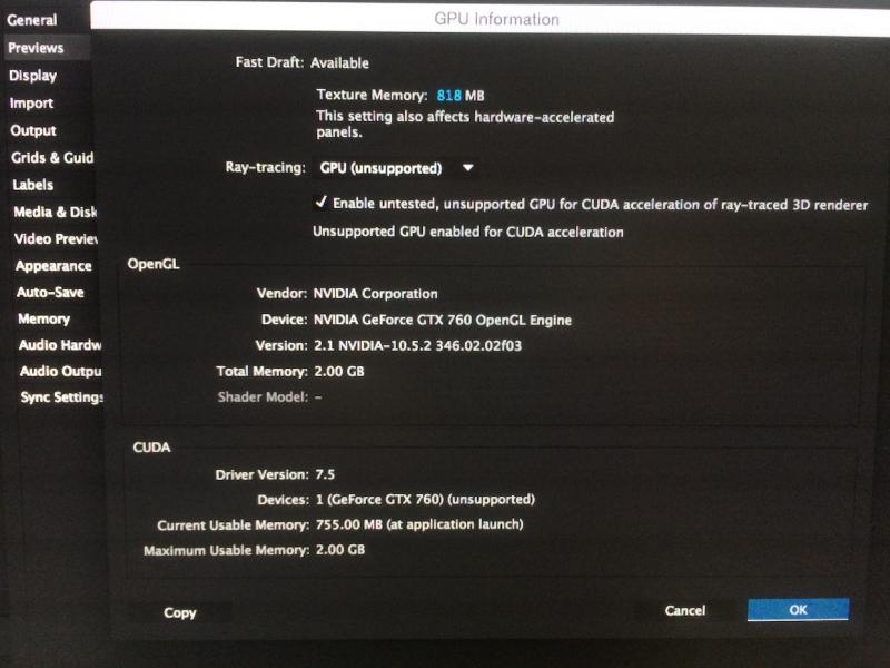

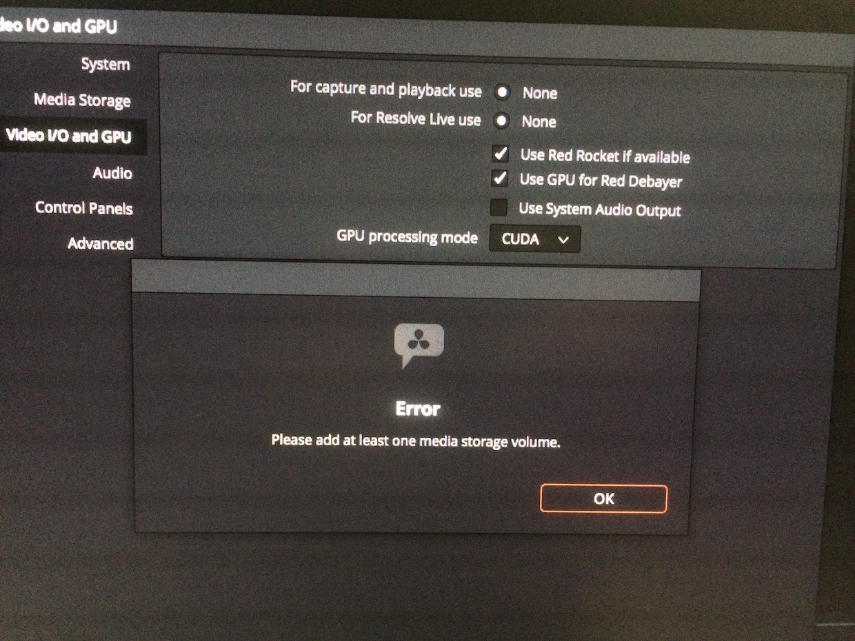

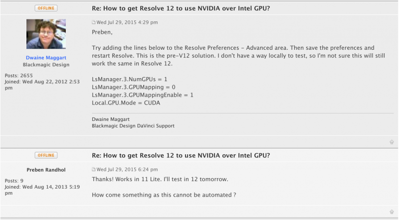

  14. @t00h0t This from Resolve with GTX 760 on a Hackintosh Yosemite. This from After Effects CS. the GPU is unsupported. This only available on Adobe PPro & AE CS6: Here are the steps: Download the instructions here: CreatorUp-TechTips-Cuda Download the latest version of CUDA drivers here: http://www.nvidia.com/object/mac-driver-archive.html Install CUDA drivers and make sure it is running on your system preference. Run GPUSniffer (/Applications/Adobe\ Premiere\ Pro\ CS6/Adobe\ Premiere\ Pro\ CS6.app/Contents/GPUSniffer.app/Contents/MacOS/GPUSniffer) Edit CUDA Supports Text file in both Premiere CS6 and After Effects CS6 (/Applications/Adobe\ Premiere\ Pro\ CS6/Adobe\ Premiere\ Pro\ CS6.app/Contents/cuda_supported_cards.txt) Open Adobe Premiere and After Effects and enjoy your new lighting speed rendering time. For Adobe PPro & AE CC 2015 it should be able to use any recent CUDA supported cards. To check: Open Terminal and Run /Applications/Adobe\ After\ Effects\ CC\ 2015/Adobe\ After\ Effects\ CC\ 2015.app/Contents/AEGPUSniffer.app/Contents/MacOS/AEGPUSniffer You should see your card details and below line: (mine is running on Intel Iris Pro, so it's Failed) dlopen "/usr/local/cuda/lib/libcuda.dylib" failed! dlopen "/usr/local/cuda/lib/libcuda.dylib" failed! If not, Check the latest version of CUDA drivers here: http://www.nvidia.com/object/mac-driver-archive.html But i assume you've flash your VBIOS and installed the quick fix for CUDA below Just hope it's not conflict it's original CUDA core feature. So try to install the closest match Nvida CUDA Driver http://www.nvidia.com/object/mac-driver-archive.html with the one shown here: https://www.techpowerup.com/gpudb/b3226/galax-gtx-970-oc-silent-infinity-black-edition Do this with your own risk What version is your Davinci Resolve? Here's for your references:
  15. @t00h0t oh yes i forgot the iMac 5K comes with R9 Maybe it's conflict with AMD driver? Since AMD did not have CUDA. And most Color Grading / VFX strongly recommend to use Quadro cards instead of GeForce due to it's specific Driver / firmware. Though both cards has CUDA. Is there any options on the script to download specific driver we want? Try to install lower branch version perhaps. I just checked with my friend, he managed to get his GTX 760 CUDA on his Yosemite Hackintosh, Davinci Resolve. I know its totally different case, but still, it was a PC GPU that successfully run on a Mac without flashing the card's BIOS. so i assume that macOS Sierra has a different OS architecture As you can see on the 2nd pic that the GTX card was unsupported for CUDA processing in After Effects. But we can modified this by editing the gpulist textfile and put your card's model to forced it available inside AE.
  16. @t00h0t I thought all Nvidia drivers are embedded on macOS installers? Have you tried to download a separate Cuda driver? What is your dGPU? Did Resolve/Adobe able to detect your dGPU CUDA? Or maybe the Cuda compute features has not been unlocked in Sierra Beta
