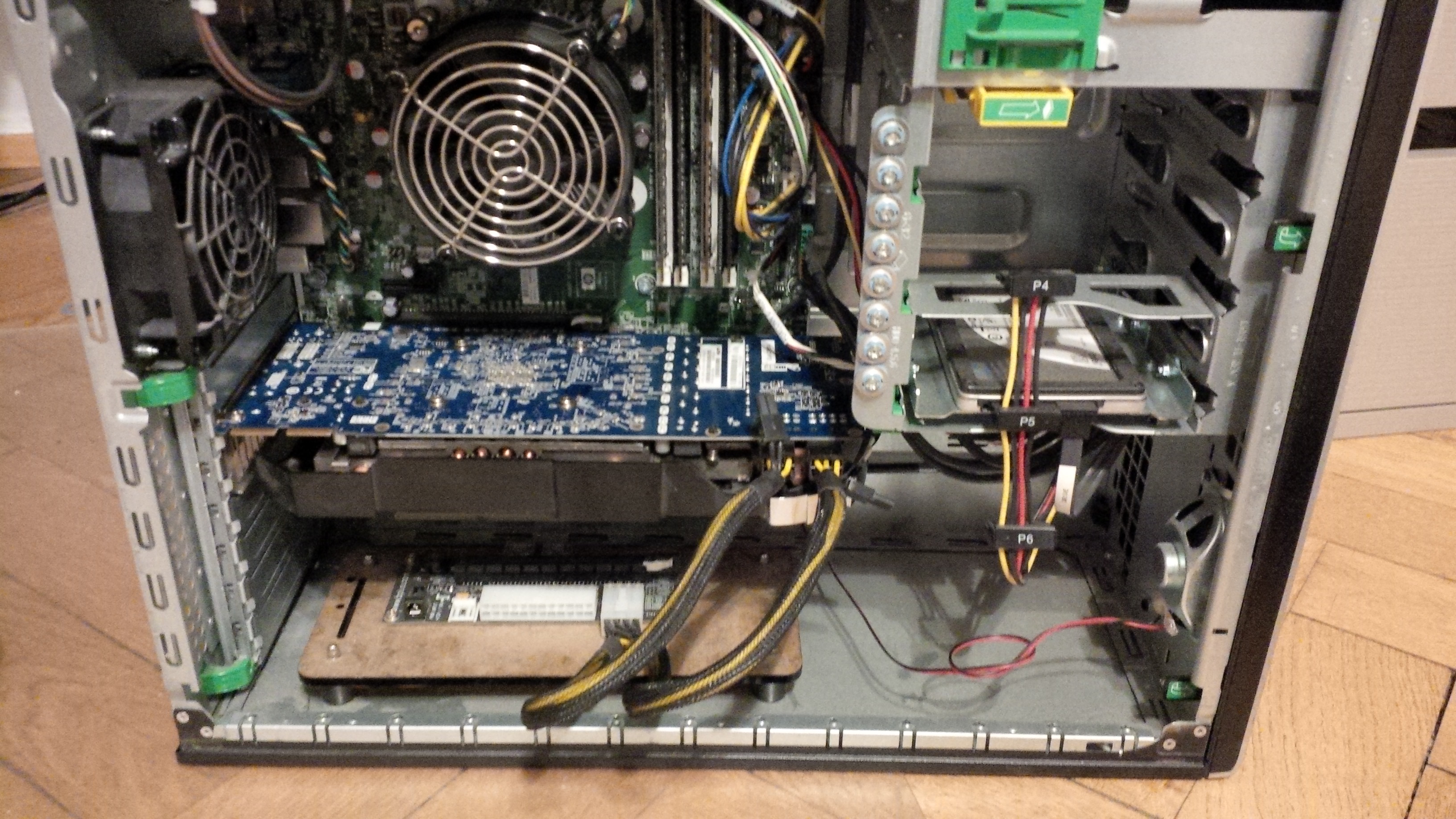

I'm not using an external ATX PSU but the Dell power brick sold with PE4C, so that BPlus adapter is powering the GPU. You can see PE4C below the GPU inside PC case. GPU is connected to PC mobo PCIe and so receive power from internal 320w PSU, and also to PE4C receiving power from the Dell brick. The PC it's an old HP Compaq 8100 Elite Convertible MiniTower, with i7-860 cpu, 14GB Ram and one SSD. -
Power a dGPU inside a PC with external PSU
davide445 replied to davide445's topic in DIY e-GPU Projects

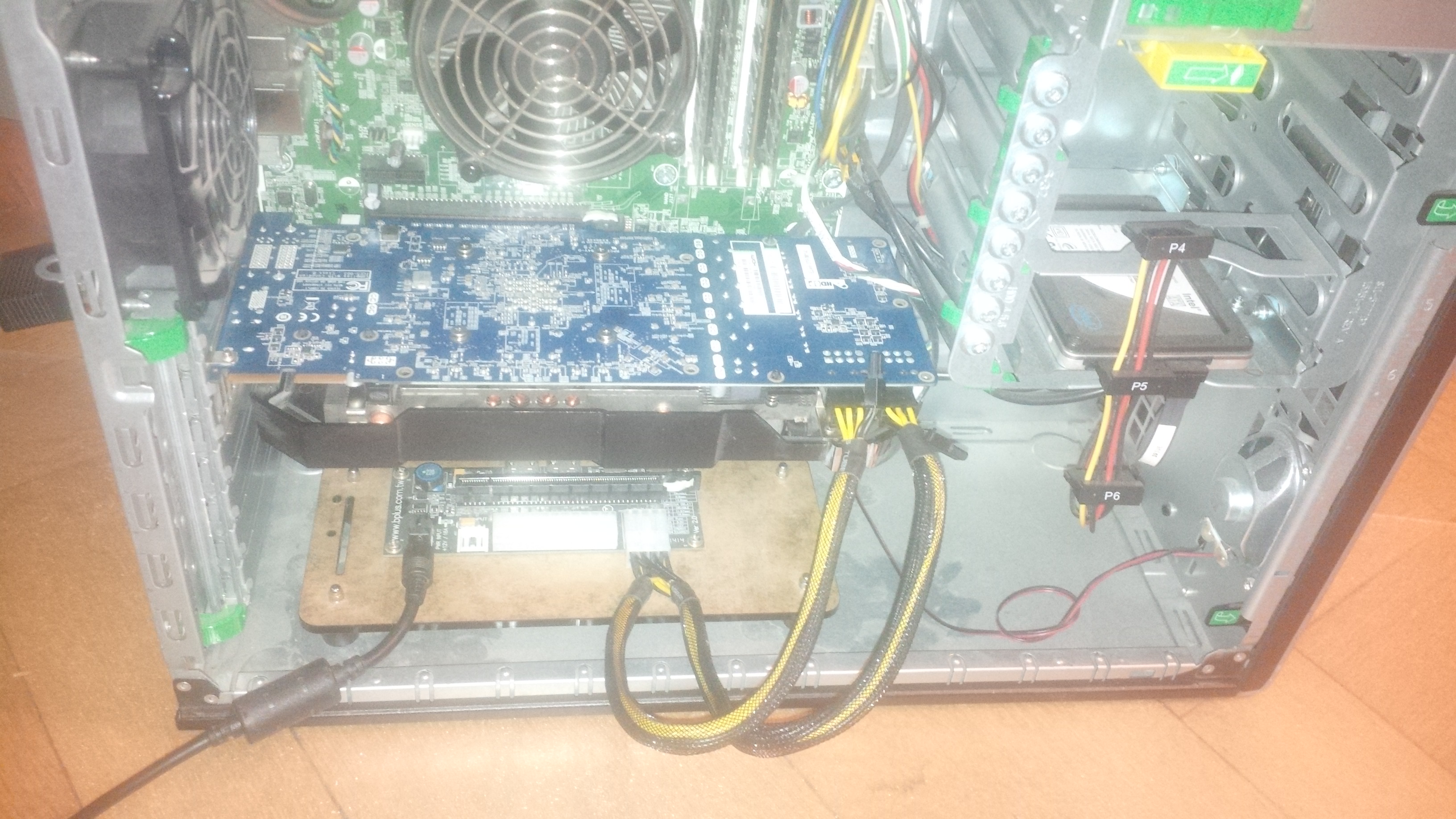

@illeatmyhat The strange thing is...it actually works, or at least appear to. Tried to power the pc also and I was able to use the GPU, install new drivers and even run some benchmarks such as Cinebench and Indigo Renderer pure GPU test scene. GPU-Z state the GPU was drawing about 20-30w under heavy load at 99% utilization. I suppose this is wrong since the card TDP is 200w, and GPU-Z can read only the power supplied from PCIe slot probably. I just tried to power the PC disconnecting the 2x6pin coming from PE4C and got two horrible sound warning at start and no start screen, I immediately shutdown the whole. I suppose is meaning the internal PSU is in overload and can't power properly all the components. It remain for me a mystery how the power balance is defined btw internal and external one. How can I sure I'm not overloading internal PSU, even with the external power source working? -
Got for free a PC with limited non replaceable PSU, want to use my GPU connected to his mobo but powered also with an external secondary power supply. Owning the PE4C v2.0 as adapter for eGPU with my laptop, my idea was simply to use it as power adapter with the Dell power brick as PSU, but testing with PC off the PE4C is not powering the GPU. I didn't understand the problem and so the possible solution, how is decided the power supply balance btw PCIe slot and the 6+6pin? I need in some way the two PSU communicate? Purchasing a complete ATX PSU will resolve the problem?
Tested and the adapter is not powering the card, with the PC off. Powering also the PC so that the card receive power from mobo PCIe slot, the card will also possibly be powered from PE4C adapter? I didn't want to harm PC PSU by leaving it alone in powering such a hungry card.
Want to know if mine PE4C v2.0 will be not in danger with this unusual usage: I got for free an old HP Elite 8100 mid tower, i7 860 12GB ram, want to use it with my current eGPU HD7950 but his 320w PSU it's not enough and not standard. So I ... put my videocard in the PCIe slot and want to use PE4C just to power it as in the pictures. Being the card not connected to PCIe slot of PE4C he will power it, or create some mess?

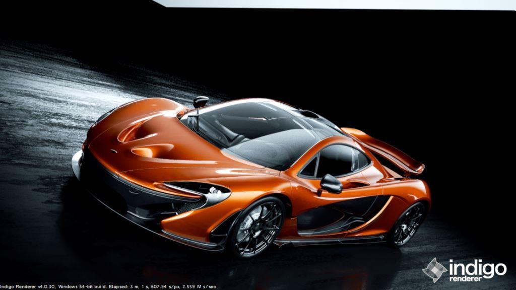

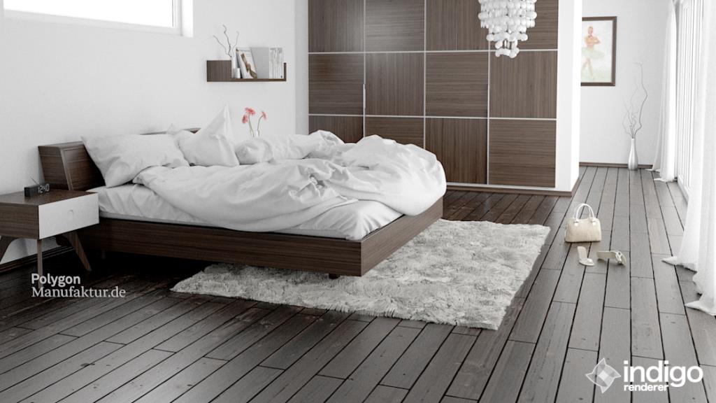

Waiting since last year since as many others AMD or Apple users was searching for a good OpenCL rendering solution. With Octane going on CUDA "translation" next year the list of available OpenCL renderer is pretty short. So exciting to know it's open the public beta of Indigo Renderer 4.0, after VRayRT and Luxrender (first one really expensive, second one not available for Cinema4D) the third pure GPU OpenCL renderer on the market. Is possible to benchmark on test scenes and test on own projects. As a beta it's not for production (for the pure GPU part, CPU and hybrid CPU+GPU part is working perfectly as always), but it's exciting to test for the pure speed and beauty of the result. Here a couple of test scene rendered on mine old Radeon HD7950Boost in eGPU mode, both at 600 samples per pixel, the first one in 3min, the second in 7min, the first one goes from 0.26 Mil pix/sec on CPU to 2.5 Mil pix/sec on eGPU, about x10 speed increase! And my old laptop CPU it's quiet at 0%, that's the beauty of eGPU!
