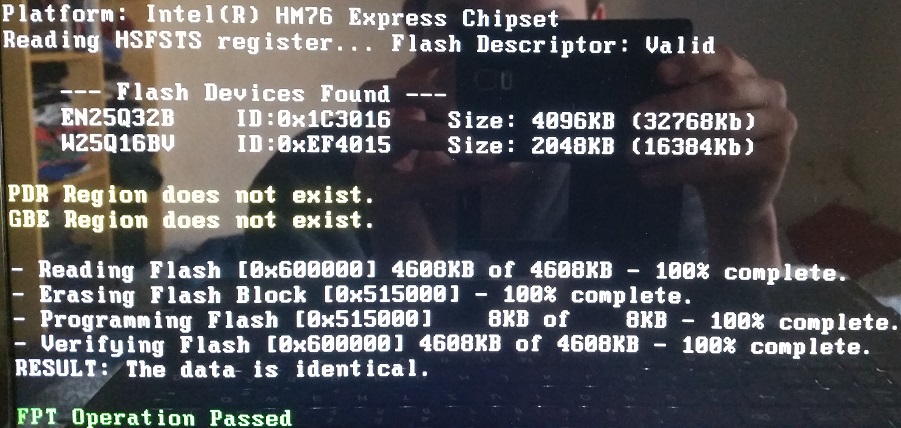

Hey guys, i really want to upgrade my Y580 with an egpu, but there are some questions i could not find any answer to. I hope you guys can help me with that. 1. I'm planning to use a GTX-960 (4GB) as eGPU. Which adapter performs the best with my mPCIe-slot? I thought about getting the PE4C-PM060A V3.0 from HWtools because it features the PCI-Version of my Y580. 2. Using my Laptop as a Desktop PC while having an Asus VG248QE connected via HDMI. The refresh rate is 60Hz max due to the HDMI only supporting >60Hz in 1920x1080. As soon as the egpu is installed i want to switch to DisplayPort or D-DVI. Have you guys experienced higher refresh rates because of an egpu? 3. Do you think that i will be able to use the whole power of the GTX960 or is it better to get a cheaper card? I mostly play FPS (ex: BF4). I really hope you can help me because i don't want to buy a new PC only for gaming purposes. In my opinion the Y580 is a good equipped notebook, the only thing throtteling the gaming performance is the GTX660m. I already installed the unlocked BIOS, overclocked the GPU, repasted the CPU/GPU (temps are now not exceeding 70°C), bought a cooling pad, installed a SSD and upgraded my RAM to 16GB. Thats it for now - regards from northern germany. haze
