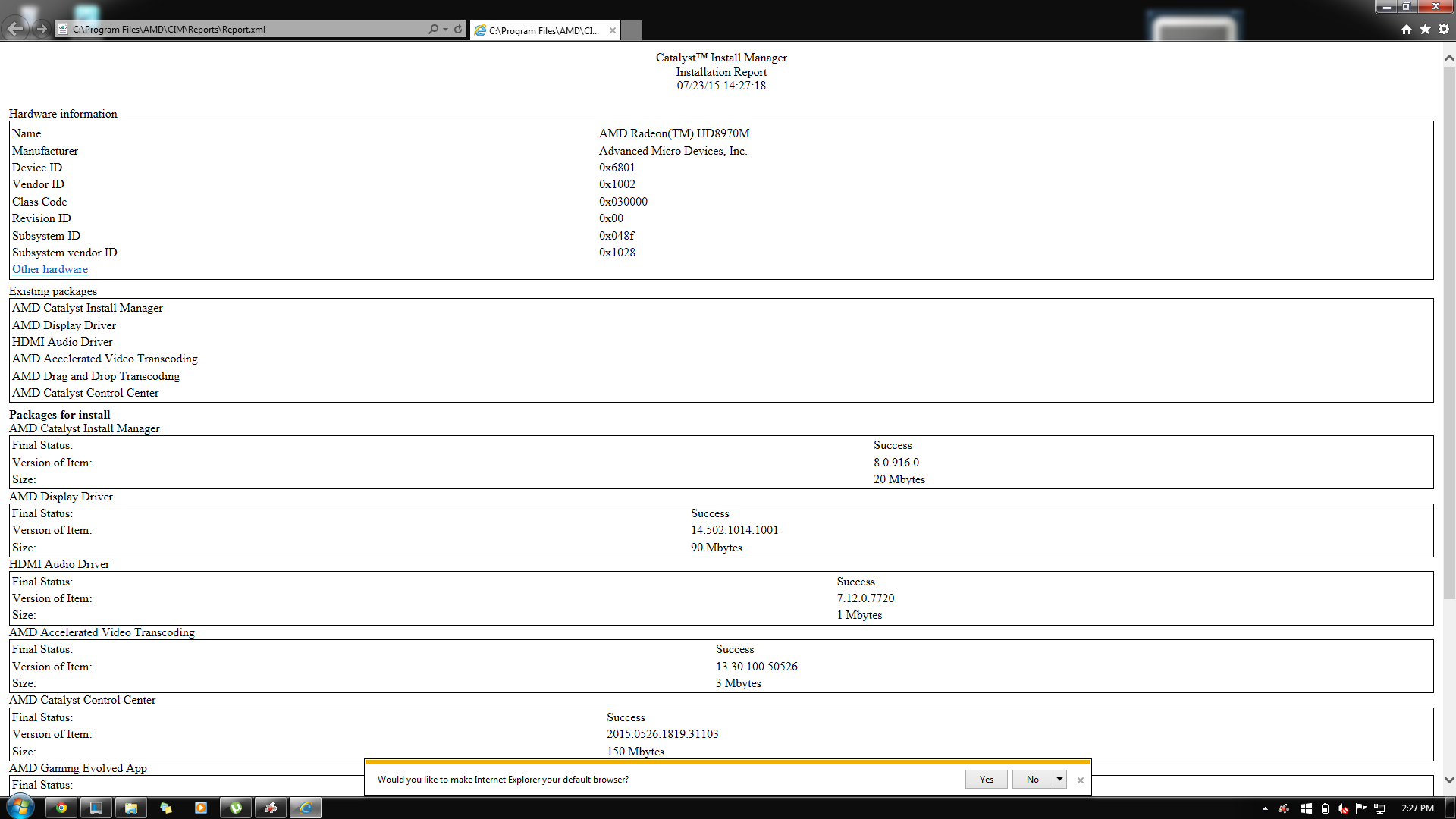

after uninstalling and scanning for new hardware.. i notice 8970m is still the brand,, heres the report image after re installing the amd driver .. i did finish also flashing my 7970m.. and seems nothing happened. - - - Updated - - - after uninstalling and scanning for new hardware.. i notice 8970m is still the brand,, heres the report image after re installing the amd driver .. i did finish also flashing my 7970m.. and seems nothing happened.

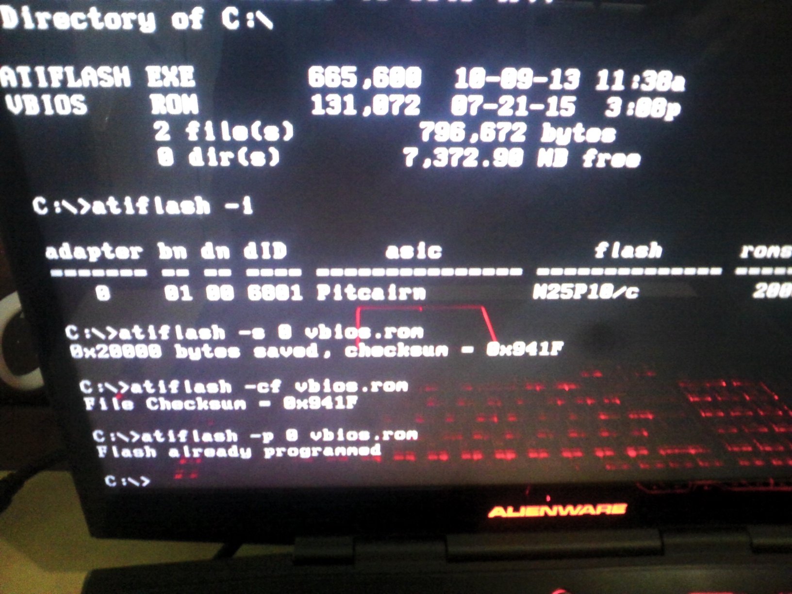

yes sir.. i did remove my 2 hdd.. an it boot to win98 it think.. and i did enter some codes.. as instructed guide by sir svl7.. the last part said.. "flash already programmed".. but it didnt restart or shut down afterward. so i did manually shut it down.. i got only single 7970m.. the think i havent done yet is to uninstall the 8970m drivers and re scan for new hardware.. ive been thinking to format it to clean instead ....
... problem still persist sir.. i notice device manager detects 8970m and never been change.. i try to fully clean install my m18x to windows 8.1 alienware os... coz ive been thinking some 8970m drivers are still register in it.. i dont dont have any idea what will happen next.. hope finally will solve....

sir .. im done.. halfway.. im kinda confuse ... im done entering the commands 1.atiflash -s 0 vbios.rom 2.)atiflash -cf vbios.rom 3.)atiflash -p 0 vbios.rom----one after anotherafter that says "flash already programmed".. do i need to shut it down.. because svl7 said restrat if prompted/ or it said it need to restart .. im well confuse.. i did another problem,, i did alo=so lost the lockpin from hdd ribbon cable... i can put it agian.. but main to solveis the bios.. my m18x is still on standby, and waiting for your advice....
