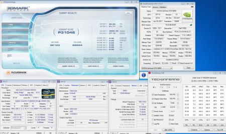

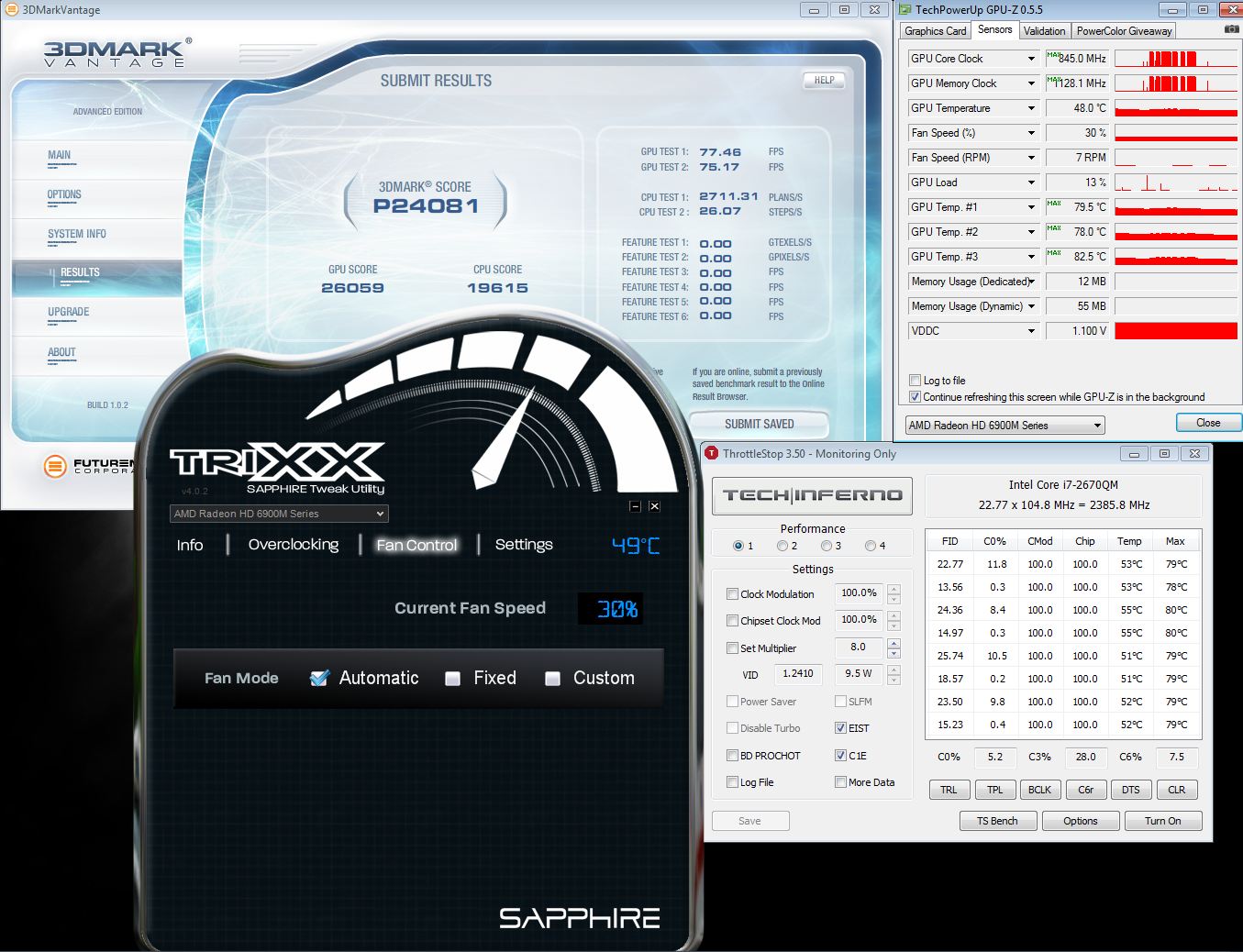

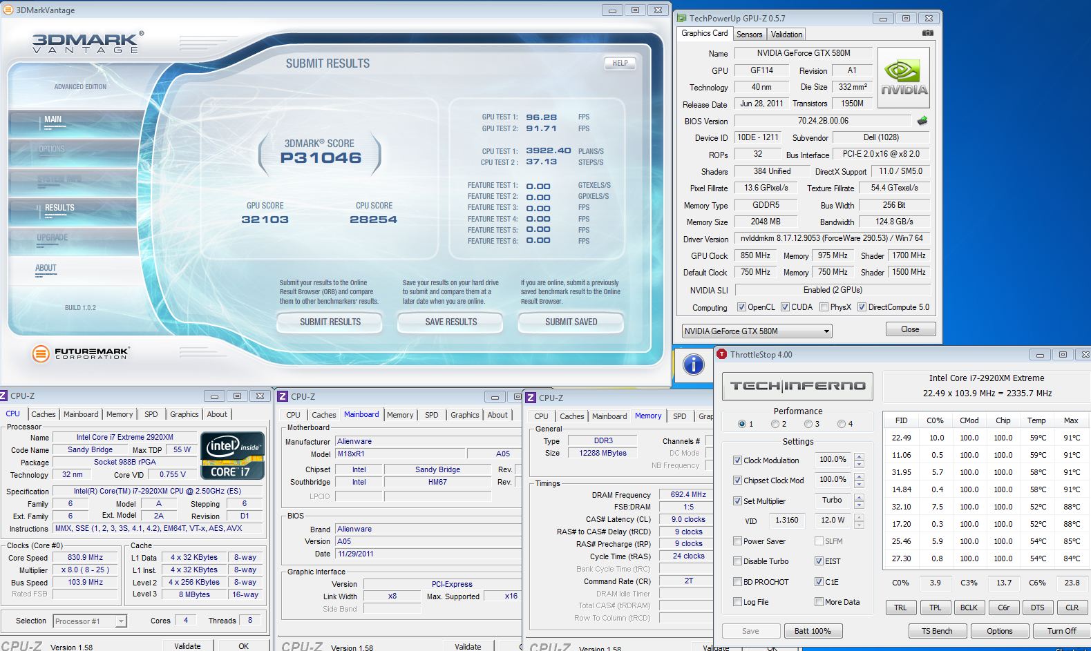

No idea how good/bad this is (I'm more of a 3dm11 fan), but I'm hoping it's ok. :)
Very nice looking great to me! Most I can get for now without AC in CPU is 30,700k but for gpu 27~k so very nice run for a total of 28,878... and wonderful gpu score of 29K great Job Jimbo... you need to run that cpu just a little faster and you'll be in 30k cpu range with could bring your total score almost to 30k... since cpu brings the total score up when paired with a gpu score higher or in similar range... try 45/45/45/45 with 0flex and 168 amp/1344 primary plane... then in windows run a few wprimes to check temps before the vantage run... and use throttle stop to raise those watts up from 99 to as high as 168... and see highest you can set without having overheat or throttle issues. At 0flex if you don't over heat... it is enough volts to maintain 45x through wprime... if you overheat too much you will be drawing more power and the cpu could crash at 0 flex if overheating too much as it would then require a flex or two to be added... but stick with the 0flex and stay cool since using less volts keeps you cooler in itself. If you want let me know what you cpu settings were for that run and I'll let you know if I think you should raise something...

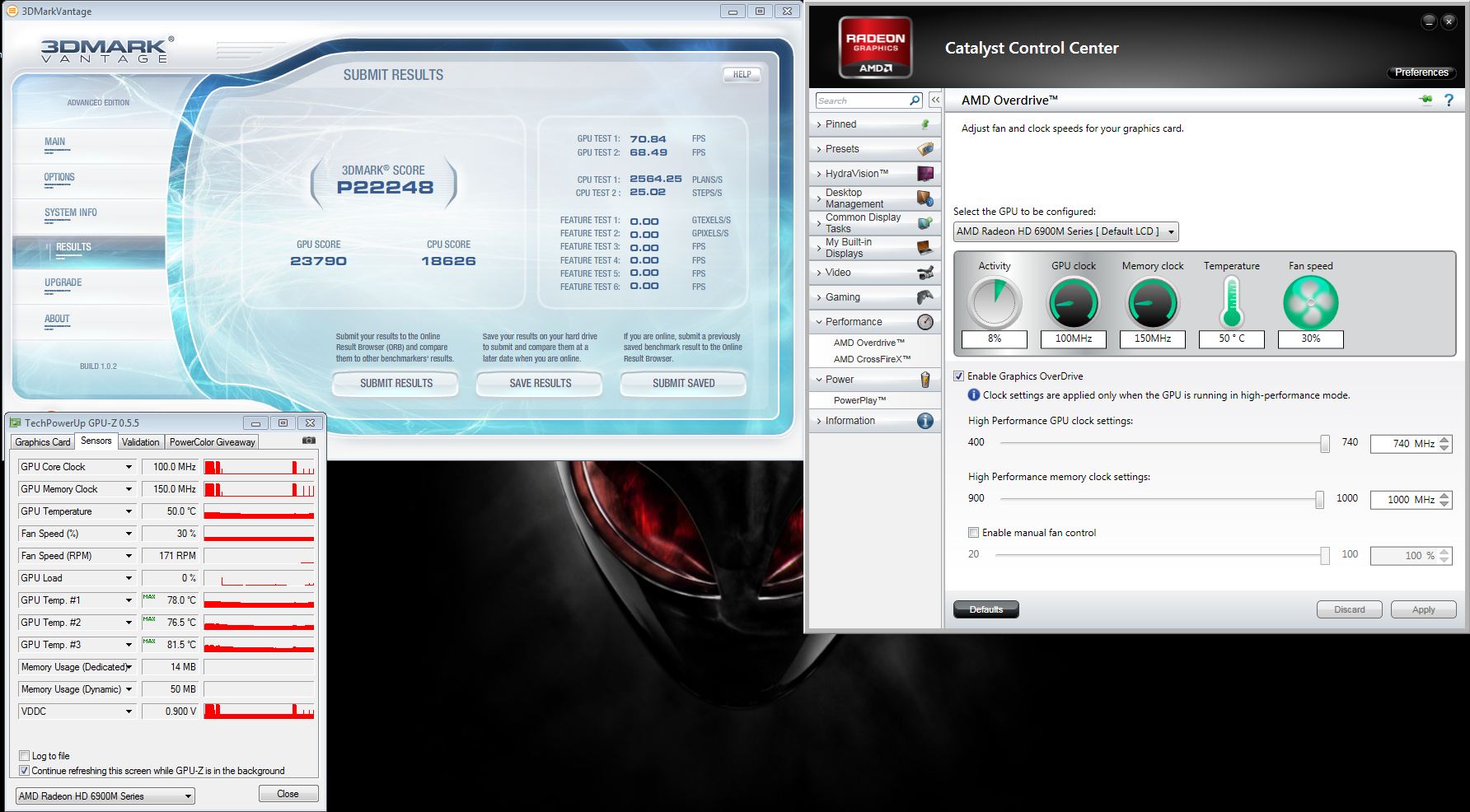

My weaksauce scores:
There is no weak benches here they are all as great as their creators. They are very nice for a untouched system. Very nice temps btw. Not bad at all you should get used to using gpuz and cpuz for benching in the backrounds of the pics so you can always use them on hwbot... atleast i am trying to get used to it hard to remember sometimes. Looking great Brian... enjoying hope your enjoying Battlefield.

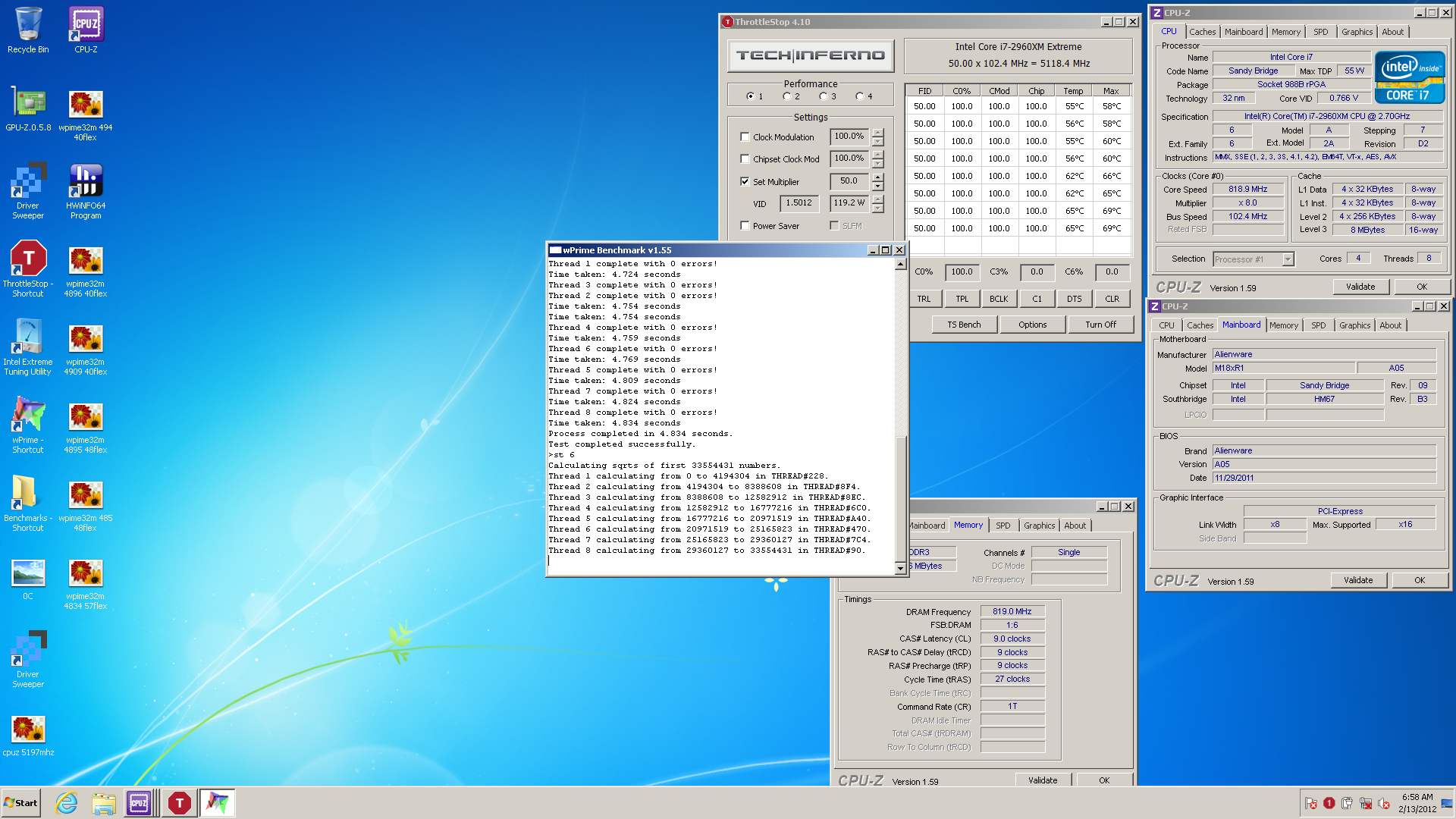

[ATTACH=CONFIG]2642[/ATTACH]

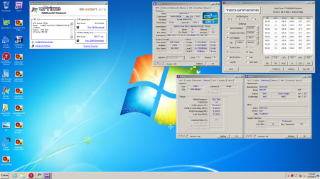

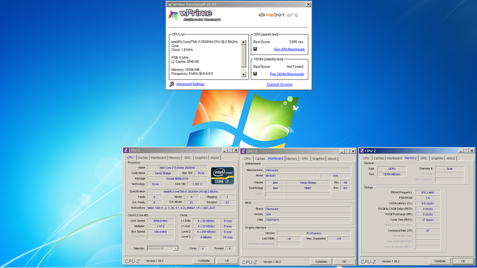

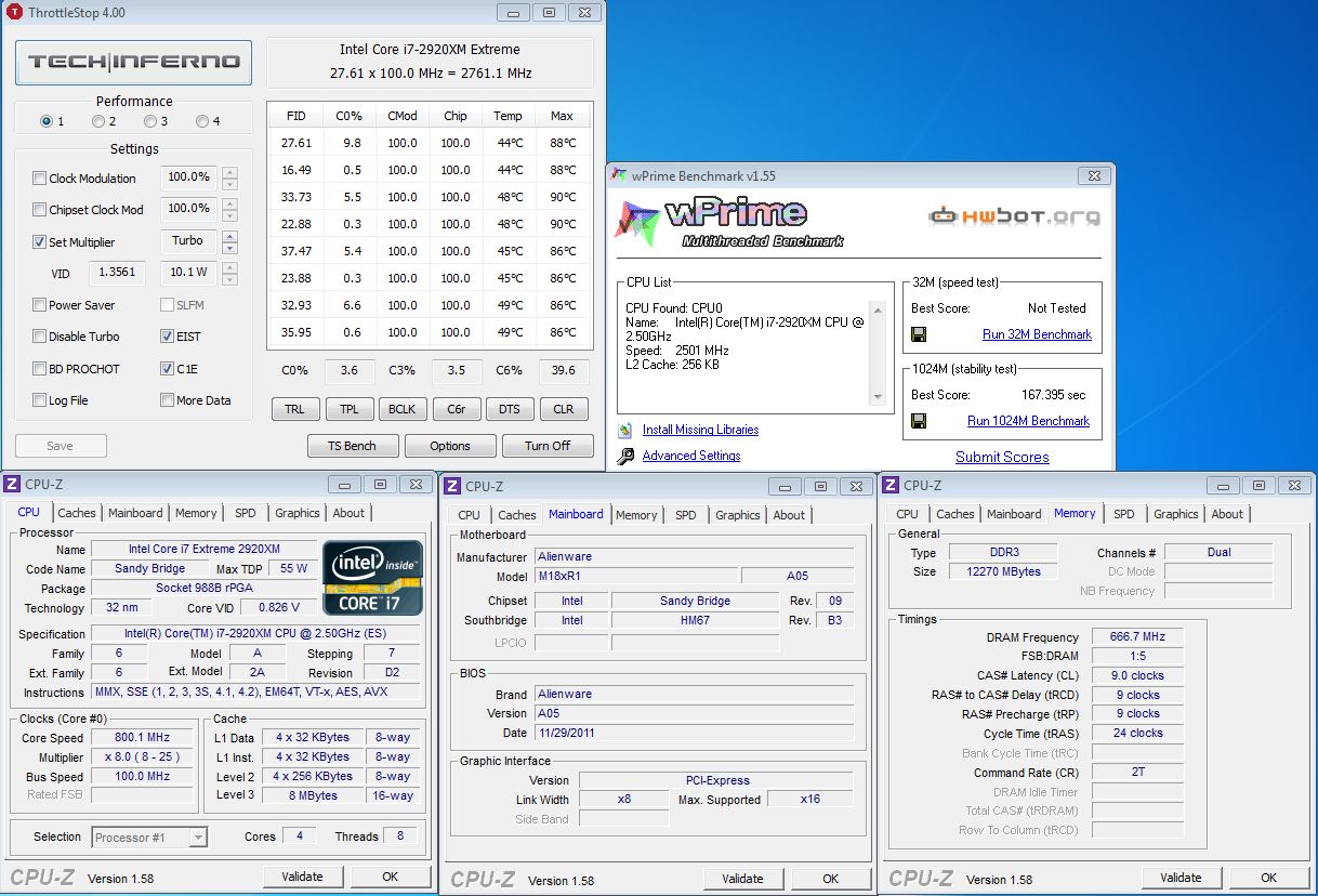

104.4 X 47 = 4906Mhz 180amps/tdc 36flex (+149mv~ or +.149v) 175 watts tdp wprime 32m 8thread 5.095sec
Man that 2920xm is a beast. I just did a new run:
thanks thats with core states off like Stam does but he uses intel ppm trick that's some nice clocks nice... great job on getting those runs... my 1170 gaming clock i am lowering to 1125... i have it running on furmark to check stability. How bout 7k-8k+ in 3dmark 11.... Jimbo's got some mean benches on his 6990M's.

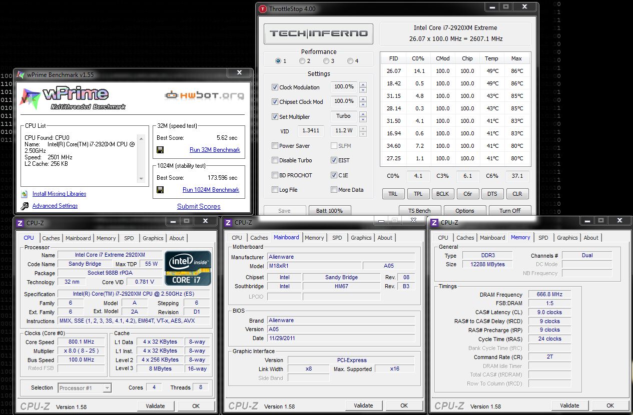

So I got my 2920xm in and it seems like its a pretty decent sample. It hits 4.5 GHz stable pretty well in Vantage and Wprime. Anyway, I'm still learning the ins and outs of 2920xm overclocking but for now, here's a preview of what I'm getting:

pretty much everyone can do 4.5ghz on 8threads.... so now you have that down you should see what ranges it can handle ill be providing a cheat sheet and yours may handle same or better or handle same or worse but at same time these chips can require more or less voltage for same overclock... the less the better since your temps will improve. hang in there i need still 2days to complete this cheat sheet....

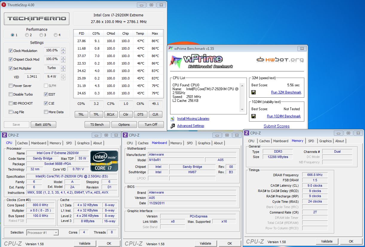

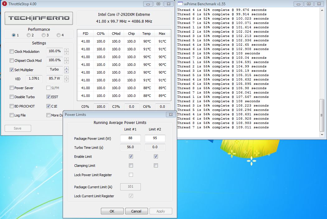

My new Q1N8 2920xm (D2 stepping) has arrived! Actually scales up the voltage passed 1.35v unlike the Q1CE 2920xm. So for all intents and purposes, it is an OEM except for the ES tag that shows up in CPU-Z. My 24/7 settings are 0 flex, 810 priplane, 95 long/max short, 88/95W in TS and 41x on multipliers. Finishes Wprime 1024MB 8 threads in a respectable 191s.

You're going to see throttling at 4.5 GHz unless you have a super chilled room and/or air conditioning blowing on the notebook to keep the temps down. Otherwise I'd recommend using a notebook cooler or Laptop Lift rubber feet (like I do) and setting it to 4.1 GHz for 24/7 use. It hits about 91-92C max under 100% load and doesn't throttle. My settings are noted above although I'm still tweaking them a bit.
Just for the record, ThrottleStop is still useful for the M18x. It lets you push the maximum TDP power limit up past 99 watts to 130 watts and beyond. What you do with all that extra heat is up to you to figure out. :)
The 130 watt setting helps benchers get a little more out of their XM CPUs but probably isn't needed for 24/7 use.
CPU doesn't throttle as far as I can tell.
ThrottleStop also continues to be a great monitoring tool and can create a log of your CPU's performance while gaming. No need to be wondering what's going on when you can have some cold hard numbers to look at. It will give you some insight into what multiplier your laptop is really running at while gaming.

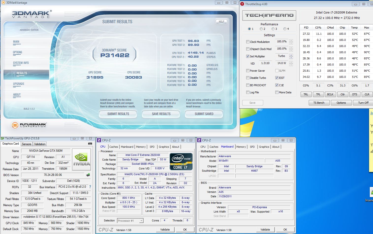

TS is by far my favorite monitoring and overclocking tool, that's no secret :D Anyhow, here's a wprime and vantage run I did with the CPU at 4.7 GHz.
Sent from my GT-N7000 using Tapatalk
Edited by Brian
those are great runs Brian congrats. Youve got a nice achievement there. if you ran 4.8ghz you would get to about 160 secs even :) which is world record if you beat 159sec :) so nice job at being right up there :) i cant wait to join ya been trying to determine max cpu speed on mine. I find it easier to test that then super pi as those take the highest flex you will ever need on any of these tests. Super pi 32m first then 1m since needs les voltage and may use high frequencies on 1m. Then ill go through wprime 32m see highest 8thread i can complete i want to try a 5ghz run :o and i also want to try 1024m from 4.8ghz-4.9ghz :) After that they get easier i know vantage has higher load than wprime and also 3dmark11 so i might try 4.7-4.8 vantage and 3dmark11. Get a cpuz up here later and a idle pic on my cooler :o who needs LN1 burrr

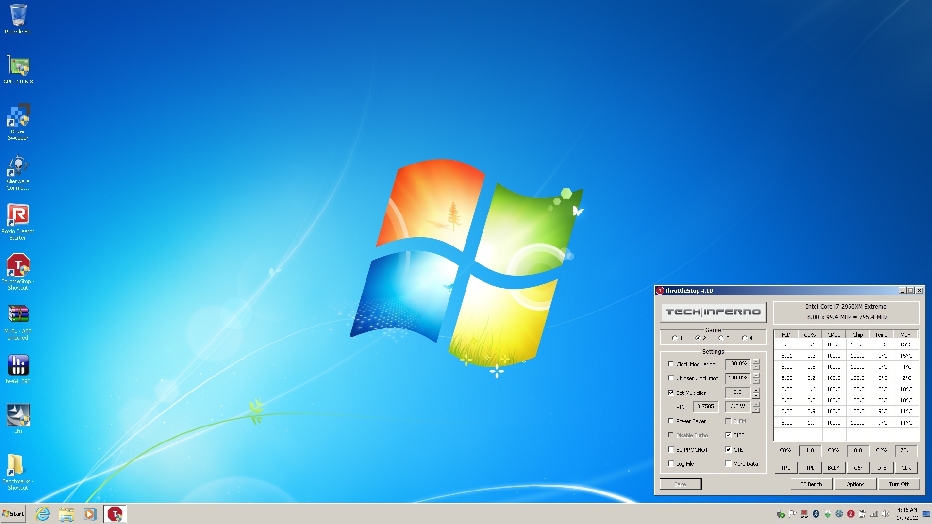

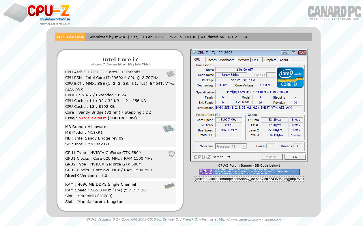

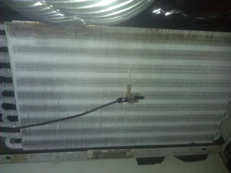

:) so here's some progress on my setup i posted about my homemade cooler setup. for this i didnt need it i had to run normal room temp it didnt handle as well cold for getting high frequencies as seemingly room temp did... go figure 70F better than 32F-60F just strange...
the 0C is idling on my cooler at 800mhz a core :)

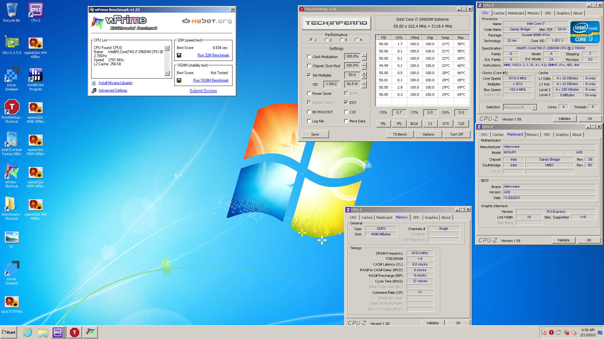

I got this on 1.43volts :) lowest i seen before for voltage on a 2900 series XM ~5.2 ghz :)
http://forum.techinferno.com/general-notebook-discussions/222-what-do-you-use-cooler-your-notebook-2.html#post18537
where i posted about my cooler
its what i could manage so far out of the 2960XM and took low voltage with room temps and intake air temps around 70F. No fans maxed stock fan control.
those temps are 20F ~ -5C at lowest read out of the notebook cooler top via thermometer. I figured if careful i can play with the sensor seen on front of unit and when I choose i can go lower than standard 60F down to as low as i mentioned before and in between depending how often and how long the compressor comes on.... :) burrrr i touched top of aluminum laptop... yes top and felt like ICE :) it boots like a champ at those temps except at that cpuz validation speed... 5197mhz i didnt seem to like frigid lol. i can use 52x but this got me into higher ranges than going 99.8x52 and raising baseclock from there. i most likely reached motherboard baseclock limit... may try to see if 50X 104+ will get it up a bit more.

this is first 2900XM series i have seen capable of wprime over 5ghz 8thread :)
@Conker @Jimbo
Its not your 3secs 32m Conkers lol or your 149sec 1024m but its not as far as it once was ;) feels good being under 10 secs of your 1024m Jimbo being the cooling you have and the laptop i have AC or not lol :P cheers
Edit: 2/14/2012 i found out i was throttling towards the end of the test the next post is at 4.95ghz running optimally no drop so i believe 5ghz would be ever so close to Jimbo's 149secs :)
