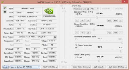

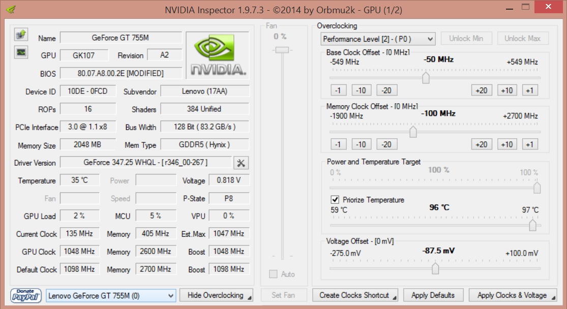

Here are the settings I have applied on both my main GPU and Ultrabay GPU.

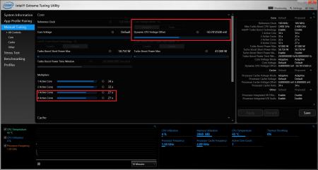

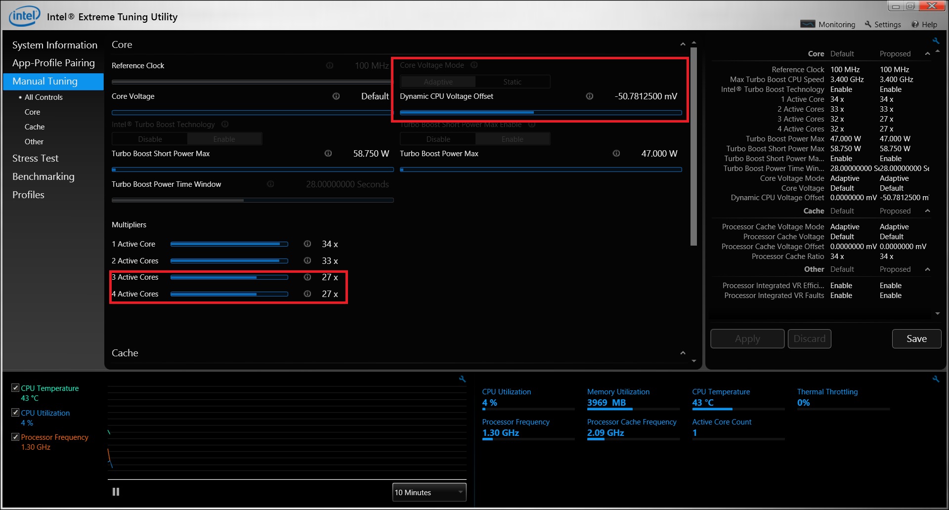

You may also want to use NVIDIA Extreme Tuning Utility to reduce your CPU turbo clocking, to help reduce temps. Look at the values I have highlighted in the screenshot -
[ATTACH=CONFIG]16531[/ATTACH]
[ATTACH=CONFIG]16532[/ATTACH]
Thanks for your help so far, rockyston :)!!
I applied your settings and tested the temps and stability playing BF4 (I always have no fps limit, I wanna stress my GPUs to see if I got stable values and temps won't rise up). First I set graphics to medium and later on to high. The temps were going up permanently but very slow in comparison with the undervolting values before. After something like 20 minutes the ultrabay GPU reached 95° and the main one 90°C, then I stopped.
I would be very glad if you could give me a hint which value I should try next or how I should go on :)
Another little question: I undervolted the CPU using Intel XTU as you said... Should I lower the cache voltage offset as well?

The cache voltage is fine. You underclocked both settings - Base clock (-50) and memory clock (-100)?
You can try reducing the voltage further to -100mV, keeping the clocks at same level and see if there are any crashes.
