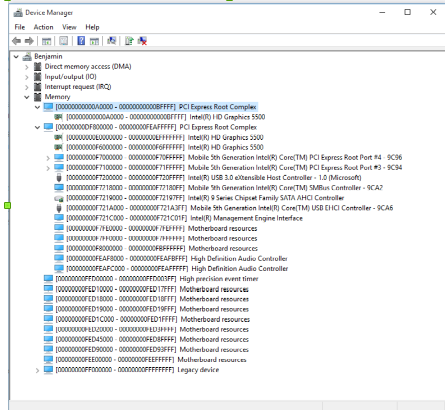

Just looking for some expert opinions on whether or not this setup will work or not.
I have ordered the EXP GDC BEAST V.8 ExpressCard version from Banggood.com, and am currently torn between the R7 370 4gb card from sapphire for 215AUD and the GTX 950 2gb card from ASUS for 210AUD. The price is fine for both is all good but i'm jsut wondering which would be better for video editing and/or gaming.
PC specs
Dual core i5vpro 2520m @2.5Ghz boost to @3.2Ghz
12GB ddr3 ram @1333Mhz
240gb kingston ssd
Radeon HD 7400m 1gb discrete graphics. (Can't switch between intel hd 3000 iGPU which come with the cpu and the HD 7400)
QM67 express intel chipset
  • My laptop has an ExpressCard slot
  • I can't find a way to switch between Intel hd graphics and Radeon discrete graphics(hd graphics dont even show up in device manager)
Thanks alot in advance guys.
Ps. if you guys could help me find my tolud that would be great aswell.
Edited by Dutchbread

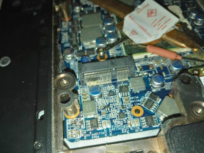

So I have been researching for days on a solution to setting up a eGPU specically for the Dell inspiron 17r se (7720) and I have a headache from it. I cannot find any one that has this computer that reported it working. So, i am looking for anyone that can confirm that they tried it on this computer so I can make my full purchase because I cannot personally afford to try it myself and have it not work. I appreciate any help here is some more information.
I am thinking of getting the PE4C adapter
intel i7 3630qm
intel hd 4000 with gt 650m
there is a wifi card that i assume is connected to a mpcie
Edited by abdelqadri

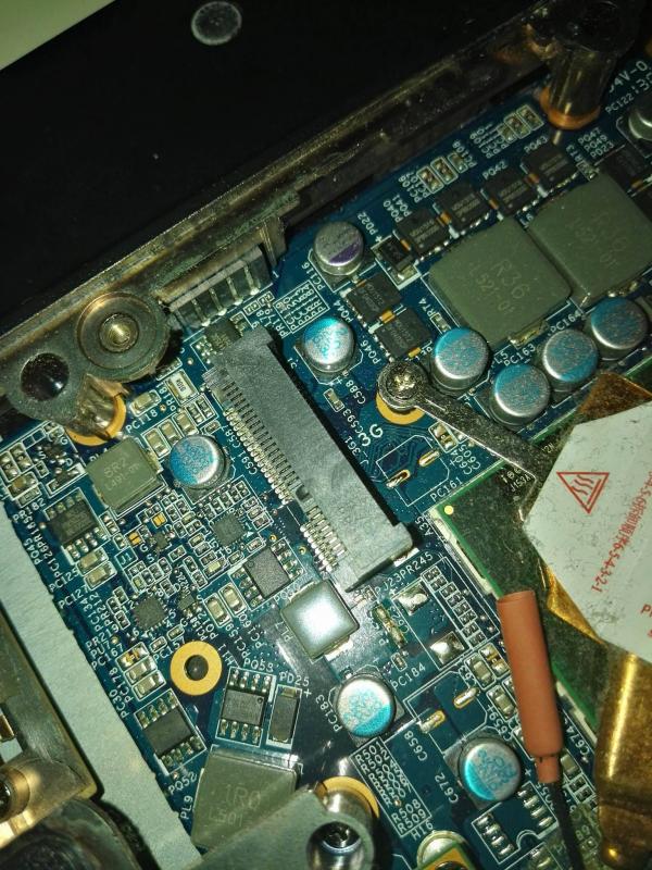

  • I know that dell Latitude 3550 is not officially supported by V8.0 EXP GDC Beast but is it possible that it would work on my computer:
    • Dell Latitude 3550
    • CPU Intel Core i5 (5th Gen) 5200U / 2.2 GHz - Dual-Core
    • Intel® Integrated HD Graphics 4400 (Core x - 4th Gen)
    • Memory: 8gb
using NGFF of wifi card?
http://www.banggood.com/NGFF-Version-V8_0-EXP-GDC-Beast-Laptop-External-Independent-Video-Card-Dock-p-1009978.html
Can use pe4c 3.0with NGFF or pe4c 3.0 must be used only with mPCIe Expresscard and PCIe adapters?
Please give any response to my post.
