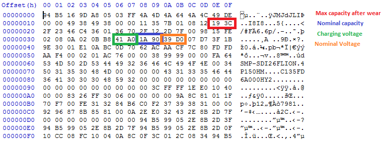

After getting pissed off and giving up for a few months, today I gave it another go. I got the EEPROM chip out and started taking guesses at how to reprogram it. If I guessed wrong, good thing the fuse was blown so I don't melt anything. I figured out that battery EEPROM contains the capacity info in terms of mAh for a pair of battery cells. I searched for the default 5200 mAh (1450 in hex) and found it. I then raised this to 6800 mAh (1A90 in hex). It was a success! Nominal battery capacity was now 100640 mAh total.

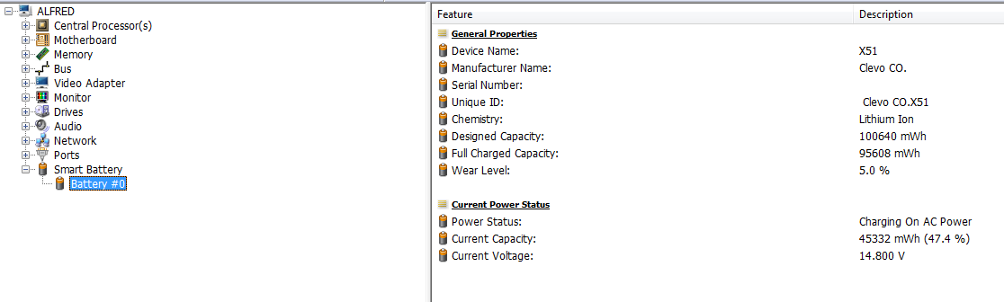

Next was looking for the wear capacity. This is the capacity left in the battery as it ages. Using hwinfo64, I got the wear level, converted it to hex, and found it in the EEPROM. I then changed it to only 5% wear instead of 74%. I left some wear because I did let the cells sit for a few months, and I was directly soldering to the cells, which isn't really good for them due to the heat from the iron. This was a success. Current charge % correctly dropped as well.

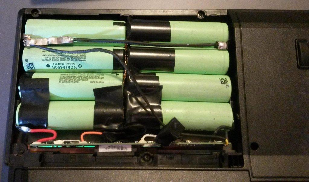

rJ8Isnq.jpg?2
I'm not sure how I'm going to get that back in the shell...

So an update:
I managed to get the pack in a shell. The first time I tried this I broke a cell connection and the battery stopped working. I have since redone most of the solder connections and it randomly started working again. Here it is in the shell:
bUBxQWb.jpg?1
The left side is not quite down all the way, but good enough. I lost the battery pack rubber foot literally the next day. Hopefully it will turn up soon in the bottom of my backpack.
