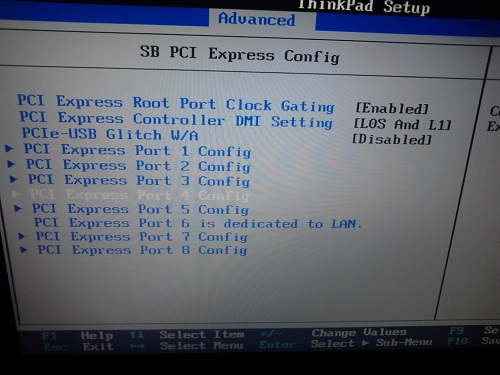

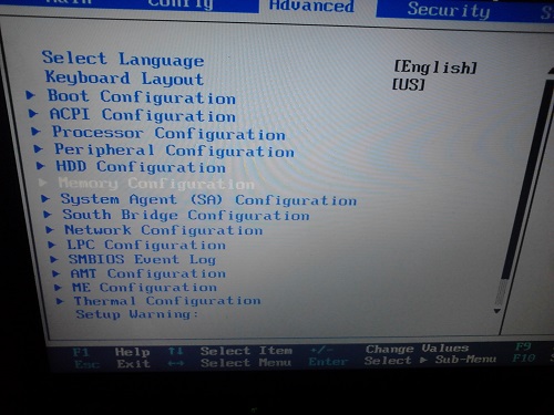

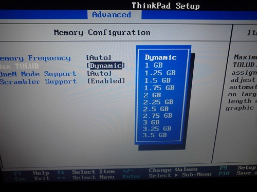

davidmhuitt86 Posted January 22, 2016 Share Posted January 22, 2016 I know your problem well and I think I have noticed a pattern. See I am always tweaking my BIOS for some reason or another and I can actually make my TP POST loop as you describe. The last time this happened to me I went back into my Advanced Memory Settings in BIOS to check everything closely. What I found that my TOLUD Memory Allocation had changed itself from Dynamic to 3.25GB, as my eGPU is only stable in Dynamic Mode. I am not using DiYeGPUsetup since I have unlocked BIOS to Force TOLUD allocation. I then proceeded to test my hypothesis and sure enough, changing the setting will cause my TP to POST loop up to three times(no cpu fans or anything but the power lights to cycle.) I also learned that if the PCI Slot is not set to Hot-Swappable, I can never just simply eject ExpressCard or even put TP to sleep to remove it safely. I always have to shut completely down and then disconnect eGPU. I also leave my eGPU running constantly and I notice that if I leave my eGPU running for more than a week, when I go to reboot my TP it will then POST Loop at that time as well(they need to be rebooted just like any other device.) Hopes this helps someone, any questions just ask. Link to comment Share on other sites More sharing options...

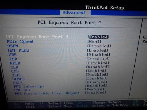

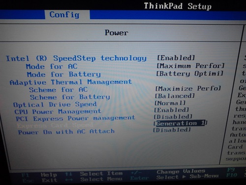

davidmhuitt86 Posted January 22, 2016 Share Posted January 22, 2016 (edited) 1 hour ago, sona1111 said: Hello all, thank you for the responses. Sirios, I thought that way as well, that just unplugging the replugging the battery would fix it, but the last time I did this a few times, and then after that it would no longer work at all, which left me in a bad situation. Possibly your experience will be different, but I would advise looking into a solution if you had the time. davidmhuitt, can you clarify if you have found a solution that seems to work consistently? Do you have to constantly change the bios setting back to dynamic after using the egpu, or have you found a better solution? Thanks for reading I dont have to do it very often, but the only reason I do I have to do it is when I restore my factory defaults in bios and resets TOLUD allocation and possibly PCI Bus speed. I would suggest flashing the unlocked version of your bios so you can have access to the TOLUD features and see if thats the issue. I also see your using the ExpressCard Adapter and you stated that you have set PCI Express Speed to GEN1. You must also set your ExpressCard Speed from Automatic to GEN1 otherwise you could still be running on GEN1. Its here if you wanna give it a try. Lenovo X220 Unlocked and Whitelisted BIOS ver. 1.40 https://app.box.com/s/coe1d05ne3cqcw57g87lgiloz6ut8r4h Edited January 22, 2016 by davidmhuitt86 Link to comment Share on other sites More sharing options...
sona1111 Posted January 22, 2016 Author Share Posted January 22, 2016 Ok, I already had that bios installed, but thank you for the links. I will look for a setting called something like 'TOLUD Memory Allocation' and verify it is set to 'dynamic' Link to comment Share on other sites More sharing options...

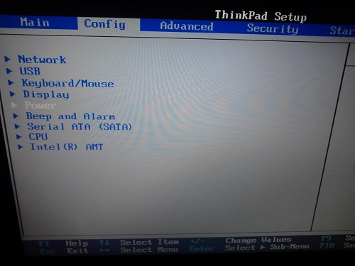

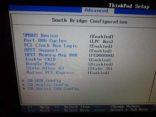

davidmhuitt86 Posted January 22, 2016 Share Posted January 22, 2016 1 hour ago, sona1111 said: Ok, I already had that bios installed, but thank you for the links. I will look for a setting called something like 'TOLUD Memory Allocation' and verify it is set to 'dynamic' Here is what you will be looking for. Be sure to check which PCI slot port your ExpressCard links to and make sure its set to hot swappable and Gen1 in those settings as well. (your pc may be in a POST loop because it thinks something isnt plugged in that is.) Link to comment Share on other sites More sharing options...

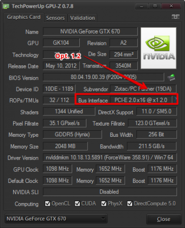

Sirios Posted January 24, 2016 Share Posted January 24, 2016 (edited) On 1/22/2016 at 1:16 AM, davidmhuitt86 said: Gen1 in those settings as well. (your pc may be in a POST loop because it thinks something isnt plugged in that is.) No, no and no. If you use nVidia I strongly advise to set "Automatic" for Express card port in "Power section", and "Gen2" for PCI Express Root in "Advanced" section, otherwise your eGPU will work on Opt 1.1 speed and not on Opt 1.2, which cuts speed in half. Edited January 24, 2016 by Sirios Link to comment Share on other sites More sharing options...

davidmhuitt86 Posted January 26, 2016 Share Posted January 26, 2016 (edited) On 1/24/2016 at 9:04 PM, Sirios said: No, no and no. If you use nVidia I strongly advise to set "Automatic" for Express card port in "Power section", and "Gen2" for PCI Express Root in "Advanced" section, otherwise your eGPU will work on Opt 1.1 speed and not on Opt 1.2, which cuts speed in half. Edited January 26, 2016 by davidmhuitt86 Link to comment Share on other sites More sharing options...
