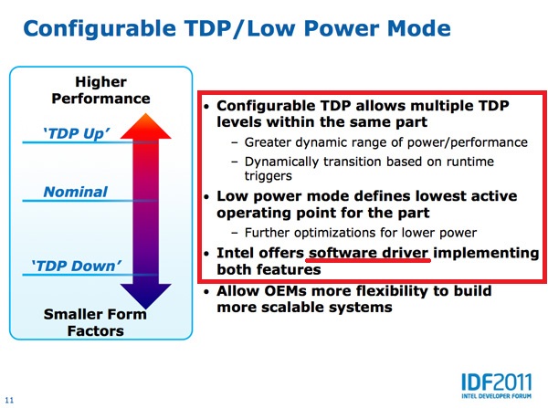

Was reading the Ivy Bridge Anand article and noticed something interesting in one of Intel's slides (attached)
Sounds a lot like ThrottleStop to me. @unclewebb What do you think, Kevin?

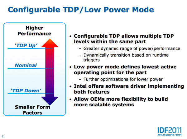

(original also included)

Sounds more like things will be automatic...even the image says dynamic "triggers".

Well, even though Throttlestop is by far the greatest tool I've ever used for CPU monitoring, tweaking and overclocking, after all it's "only" a tool, which manipulates what the CPU is already capable to do. This configurable TDP isn't really a new feature, it was already implemented in the i7 920/940XM for example, and OEMs like Intel actually used it to boost the CPU a bit (stock TDP of such a CPU in the M15x or M17x r2 is 62W instead of the Intel setting of 55W).
Also the 2920xm has an adjustable TDP. In the end it mainly depends on the notebook manufacturer whether he unlocks these features or not, if I remember correctly the Lenovo users with the 2920xm for example have absoultely no way to control their CPU since all the features are locked in the BIOS, I'm sure unclewebb knows more about this, he's been investigating this issue afaik.
This feature is very nice for overclocking as well as power saving, but I'm afraid that a lot of OEMs will simply lock it, or even use it to cripple the CPU performance for lower heat dissipation (instead of optimizing the cooling system). And I somehow believe that these features will only come to the extreme processors. Maybe also to the ULV CPUs since it would allow the manufacturers to optimize their portable systems, but I somehow can't see this feature coming to all CPUs.

The article actually specifies exactly what you just said: XM & ULV only
Also, I was pointing out that (as far as this article states) dynamic TDP will be controlled by software/drivers.
Ok, read the article... now I see your point of ripping of TS, hehe, the article really describes features which Throttlestop already delivers for a lot of users. It's crazy that the author says that Ivy Bridge introduces a configurable TDP, it's simply wrong and makes the article looking less credible.
Well, IB isn't too far off, we'll know all the official stuff sooner or later. For the time being I'm very pleased with my 920xm and the almighty Throttlestop!

I don't see Intel changing the register locations in Ivy so ThrottleStop will probably work with them with only a minor update as long as the laptop manufacturer cooperates and doesn't set any of the lock bits.
A bios mod will fix that if they do. :)
