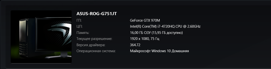

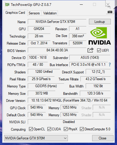

I am looking foward to use  your vbios version specially for g751jt with gsync enabled, i've already sent you a message on your website. Thanks a lot for your job.
Here's my vbios and information about card and system:
