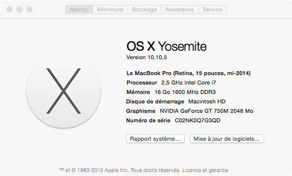

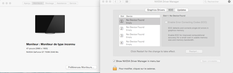

I have tried the new script with the -a mode and i can notice several bugs with my macbook pro :
- In the case i don't plug the egpu at startup the 750m is attributed in system preference as the main graphic card but my retina internal screen is recognized as a 47inches screen and it is not handled properly (glitches at startup, very slow etc...).

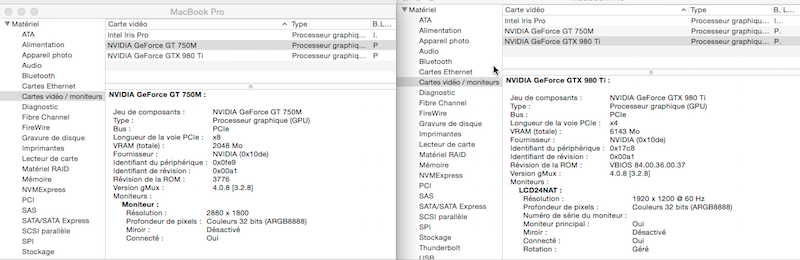

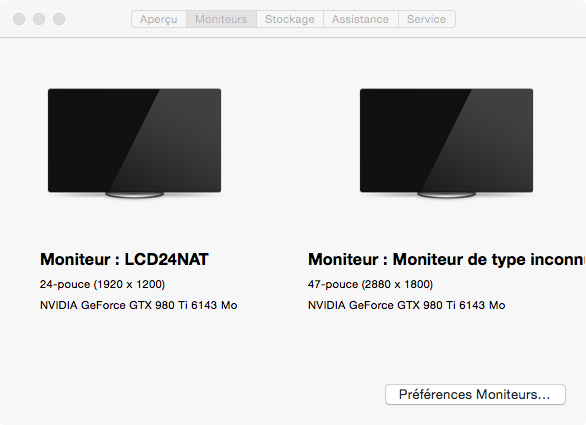

- If i plug my egpu with external monitor, it do the same glitches but it doesn't cause a kernel panic. The gtx 980 ti is recognized by the Nvidia Web Driver, and it's written in "about this mac" "monitors" that both screen as driven by the egpu.
But when i go to the system report i can see that in fact the dgpu is driving the internal monitor et the gtx 980 ti the external.
Like always, when i try to launch the benchmark, it cause a kernel panic.

Whether i put the script in -a or -m mode (plug or not the egpu) my internal screen is not recognized anymore, i have to -uninstall the script so that everything come back to normal.

In the casei don't plug the egpu at startup the 750m is attributed in system preference as the main graphic card but my retina internal screen is recognized as a 47inches screen and it is not handled properly (glitches at startup, very slow etc...).
The problem is that you still have 750M activated for internal screen (maybe due to gfxCardStatus, please uninstall it) but as now NVDAStartup.kext is isolated to match only Nvidia eGPUs, the 750M won’t give any acceleration which appears as very slow internal screen. So you have to find a way to switch back to Iris Pro only (currently, the script doesn't change the gmux state). Your gpu-policy value <01> seems to be correct.
