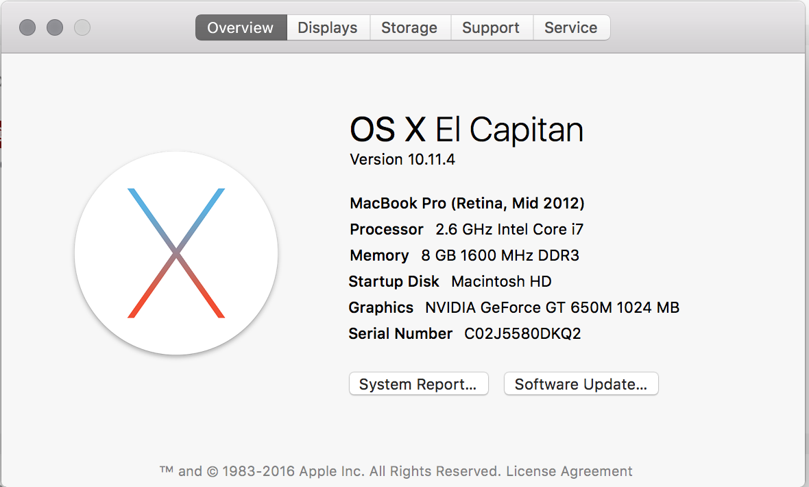

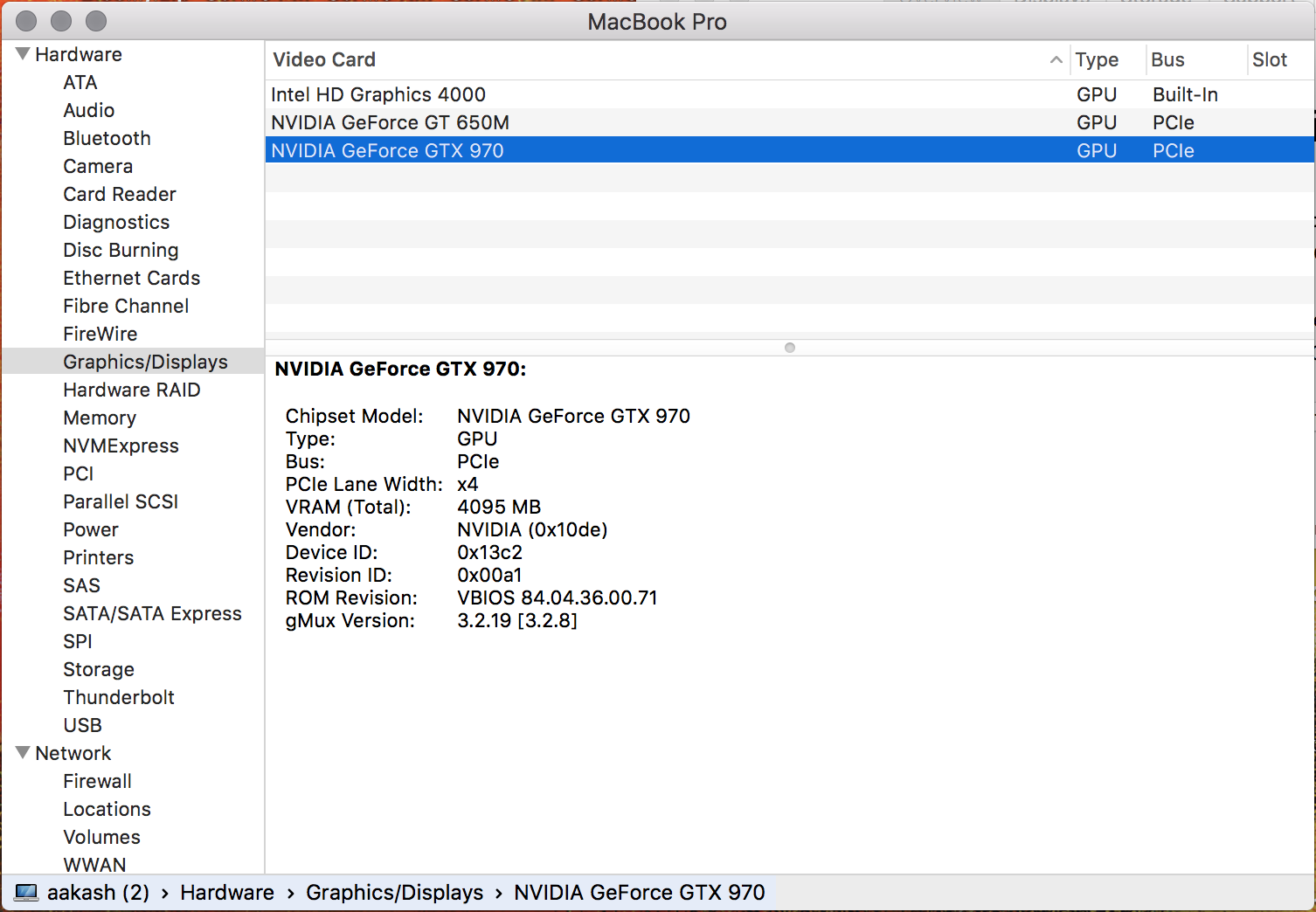

On June 16, 2016 at 9:02 AM, aakashraj said:
@goalque Even though it recognizes that the eGPU is plugged in in the system report, the computer doesn't seem to use it, and it ignores it in the "About this mac" page.
 I'm stuck at the same spot and can't seem to find the solution. Did you get it to work? Not working with external cinema displayCinema Display

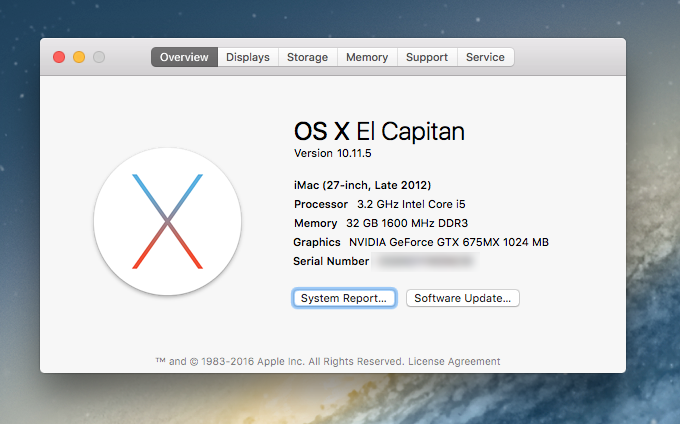

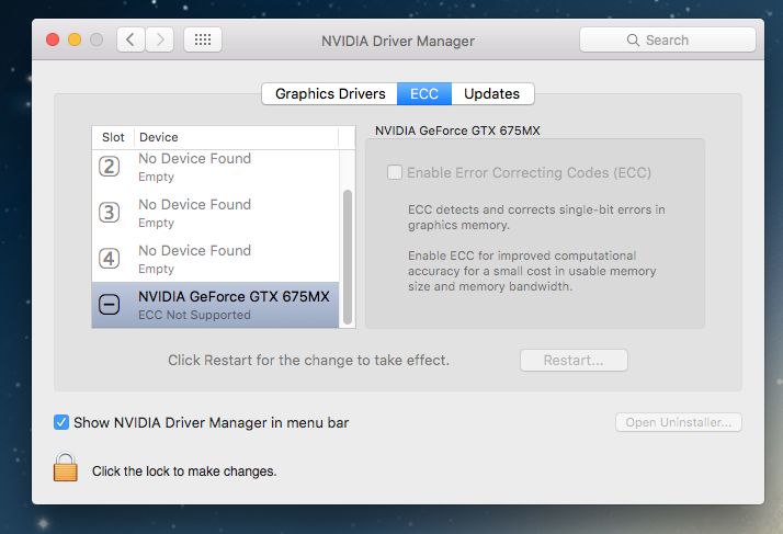

Ive looked around on the forums regarding my issue but not finding an answer. Basically, I ran the install script successfully, I noticed that when the script was running in Terminal that it even detected the eGPU but after the script ran successfully and I restarted my computer there is no detection of the eGPU in Nvidia driver manager or in the system report. Sooooo what could I be missing? It seems that all hardware is up and running, all fans spinning.
Full computer specs here:
iMac (27-inch, Late 2012)
Processor 3.2 GHz Intel Core i5
Memory 32 GB 1600 MHz DDR3
Graphics NVIDIA GeForce GTX 675MX 1024 MB
eGPU hardware on hand here:
Apple Thunderbolt Cable 2.0m
EVGA GeForce GTX 970 Ti 6GB GDDR5
be quiet! DARK POWER PRO 11 750W PSU w/ bridge
Akitio Thunderbolt2 PCIe Expansion Box
Powered Riser Cable 16X PCI-E
Edited by burrlin
On 18 April 2016 at 9:40 PM, juniordiscart said:
Hi @goalque
I know you are probably really busy, but I'm eagerly awaiting the updated version of your script / app you hinted at a few pages back. How is that project coming along? Is there a way to follow progress on it? Or will it be a bit more closed-source as to avoid scams such as the Bizon box?
Anyway, still a big thanks for your contributions to this community and the great script! Running it myself right now on a Macbook Pro Mid 2014 with 750m + GTX960 on OS X 10.010.4.
I’ve been working on a completely new application - eGPU boot manager for Mac computers. Installation script is not required as with rEFInd which invokes bless for the changing of the default boot partition. Settings can be done within the app. For more information, see
https://www.techinferno.com/index.php?/forums/topic/10057-automate-egpu-efi-mac-bootscreen-on-egpu/
You can download the demo version here:
https://github.com/goalque/automate-eGPU/releases/download/v0.0.1-demo/bootx64.efi
@burrlin
Don't use a riser and try OS X reinstallation. Please post hardware problems on this thread:
https://www.techinferno.com/index.php?/forums/topic/6224-diy-egpu-macbook-experiences/

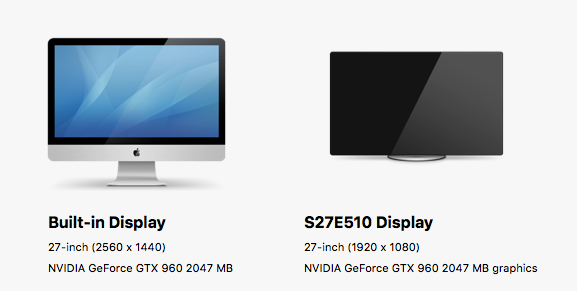

A question: if my configuration is as following:
Let's say I start a game, like WoW, in a window and drag it back to my iMac display. Which GPU will it use?

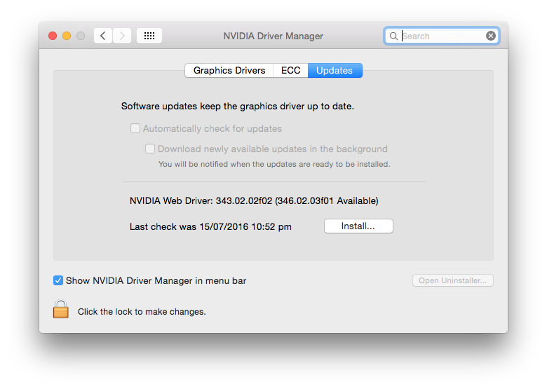

Set up my first eGPU today, a an EVGA Hybrid 980ti connected to a Highpoint TB2 mounted inside a mini ITX case with PSU. Was running 10.10.1 and ran the scripts, GPU showed up as Nvidia Device, then figured out I needed to update OS to have it show as a 980ti. So I am now on 10.10.5.
Ran the script a 2nd time, it downloaded drives (for the 2nd time) even though it doesn't find a mac board ID. Installed drivers, rebooted... and it reboots in a loop. Reboot, grey screen saying press any key, reboot, grey screen etc etc.
What would be the trouble here? I assume my components are okay as the eGPU was detected under 10.10.1, just not as the correct exact card (Octane Bench would not see it).
Do I need to un-install the script? Run again?
Going to the Nvidia panel, it detects other drives again... which ones to use? Ones from script or ones from Nvidia?

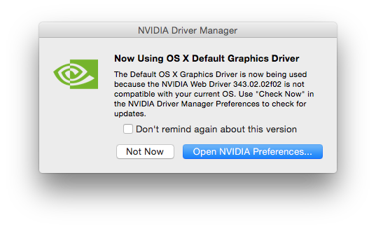

I get this message box saying the default OSX graphics driver is being used
iMac mid 2011
Attached screen grab of Nvidia panel
Is this the thing where I need an external display connected for this to start up correctly? I remember reading that but now can't find the source for that info.
