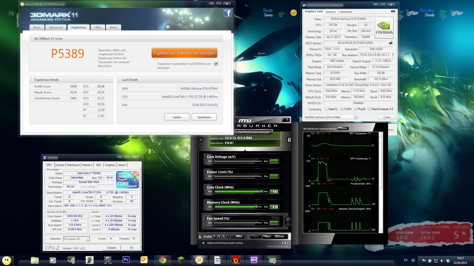

GTX 670MX in Alienware M15x
GPU overclocked with MSI Afterburner:
Core: 1000 Mhz
Mem.: 2200 Mhz
Max. temp during benchmarking = 79°C

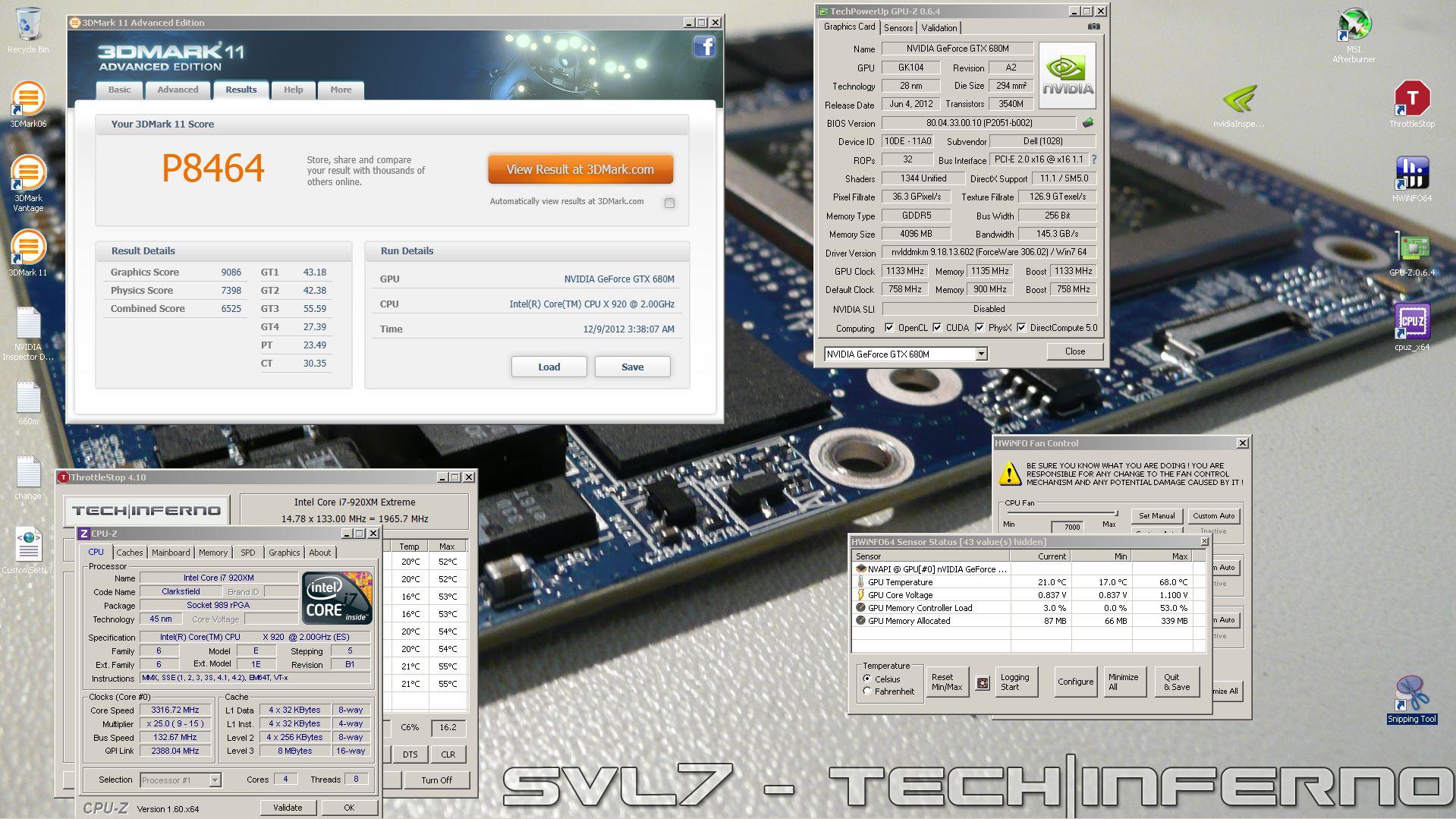

Allow me to assume that I have that crown... in that case this would be the highest 3dM11 score:

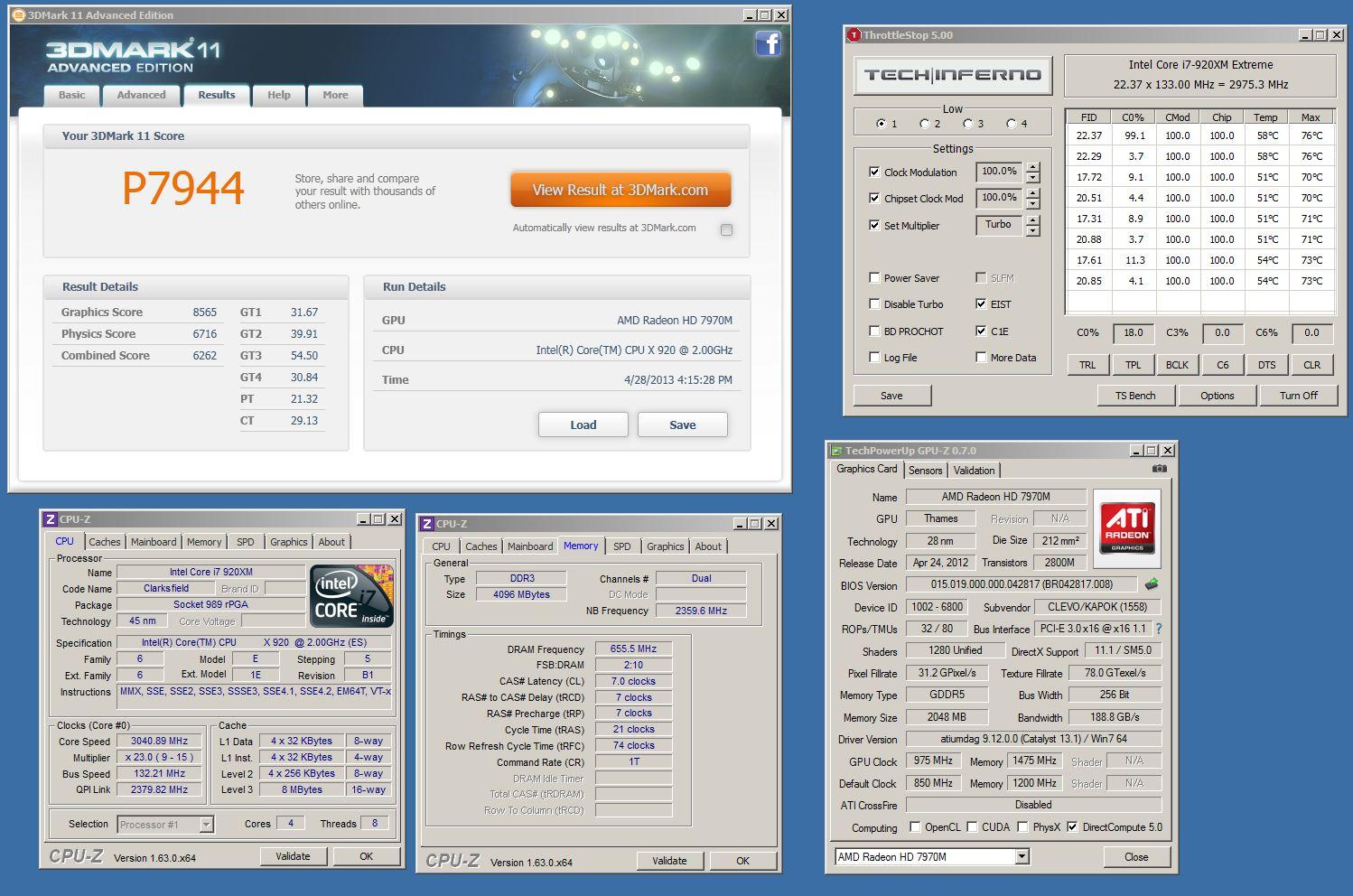

And this with the 7970m, though this is not maxed, there's headroom in this case:

That graphic score was with Tess off. 7970m was at stock voltage, as I said, that's not the max possible.
The M15x struggles a bit with the 7970m due to it's relatively heavy power supply circuits, every CPU has a different stock voltage, so your results may vary. There's no universal way to get it to run the best way possible, you'll have to balance the settings yourself and see what works best for your system.
The 680m run no. The 7970m clocks should be fine for gaming, though I think the CPU would get too hot after a while.
