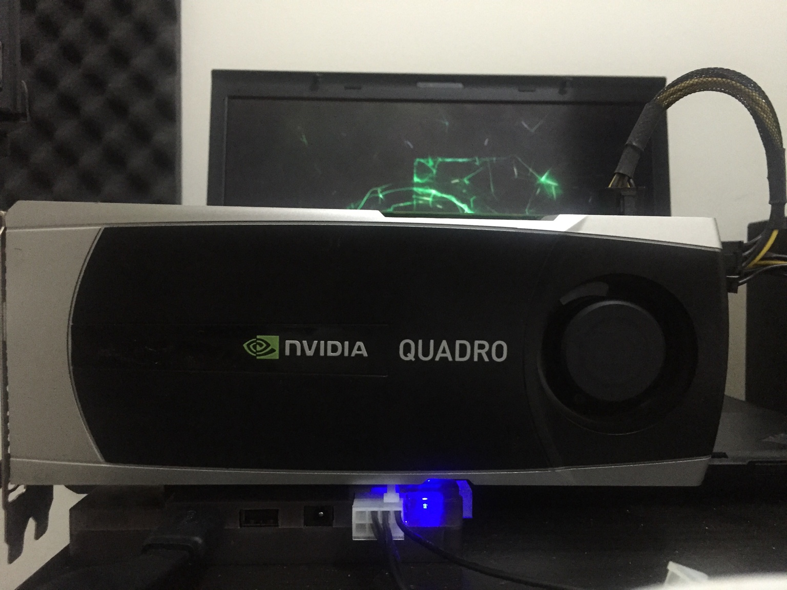

ssamydla Posted July 14, 2016 Share Posted July 14, 2016 very impressive work and results. and i like your detailed information on every single aspect. You think it will performed well with Quadro cards? I'm more into visual fx, compositing & 3D stuff. so i use eGPU for it, Looking for a rendering time speed boost & in-app interactions as well as encoding. I don't think Benchmarks will answer my questions . No one seems to post eGPU with a Quadro cards. I have test mPCIE version EXP GDC Beast v8 with Quadro 6000 & 4000 on a Lenovo W520 before finally bricked them. Quote Link to comment Share on other sites More sharing options...
Dschijn Posted July 15, 2016 Author Share Posted July 15, 2016 Sure, Quadro should work as well. The only reason it might not work, is if the drivers for the Quadro are not so good?! Quote Link to comment Share on other sites More sharing options...
jfraser Posted July 15, 2016 Share Posted July 15, 2016 On July 13, 2016 at 10:17 PM, ssamydla said: very impressive work and results. and i like your detailed information on every single aspect. You think it will performed well with Quadro cards? I'm more into visual fx, compositing & 3D stuff. so i use eGPU for it, Looking for a rendering time speed boost & in-app interactions as well as encoding. I don't think Benchmarks will answer my questions . No one seems to post eGPU with a Quadro cards. I have test mPCIE version EXP GDC Beast v8 with Quadro 6000 & 4000 on a Lenovo W520 before finally bricked them. The great thing about Quadro cards is that their drivers are Thunderbolt-enabled, so you don’t have to edit any kext files or run automate-eGPU.sh. You might have to install Nvidia drivers, but that’s easy. Though, the Quadro drivers might be in El Capitan since Quadro cards are for creative use instead of gaming and Apple has always been focused on creative work while shunning gaming, which is rather annoying for those of us who want to play games on a Mac. If you’re curious about Apple shunning gaming on the Mac, you might want to watch this YouTube video: Quote Link to comment Share on other sites More sharing options...
ssamydla Posted July 17, 2016 Share Posted July 17, 2016 @jfraser i'm not interested for gaming on mac. My mac pro 2013 is suck for 3D applications/VFX. I use HP Z840 workstation with Dual Quadro M6000 24GB GDDR5 for VFX and will test the Quadro on a MacPro eGPU instead. I'm sure there will be bandwidth bottleneck for it's CUDA parallel processing Quote Link to comment Share on other sites More sharing options...
Dschijn Posted July 17, 2016 Author Share Posted July 17, 2016 @ssamydla If the 3D apps can set a specific GPU in the options menu, than it should work. Bandwidth will affect the speed very little and shouldn't be a problem! Quote Link to comment Share on other sites More sharing options...
