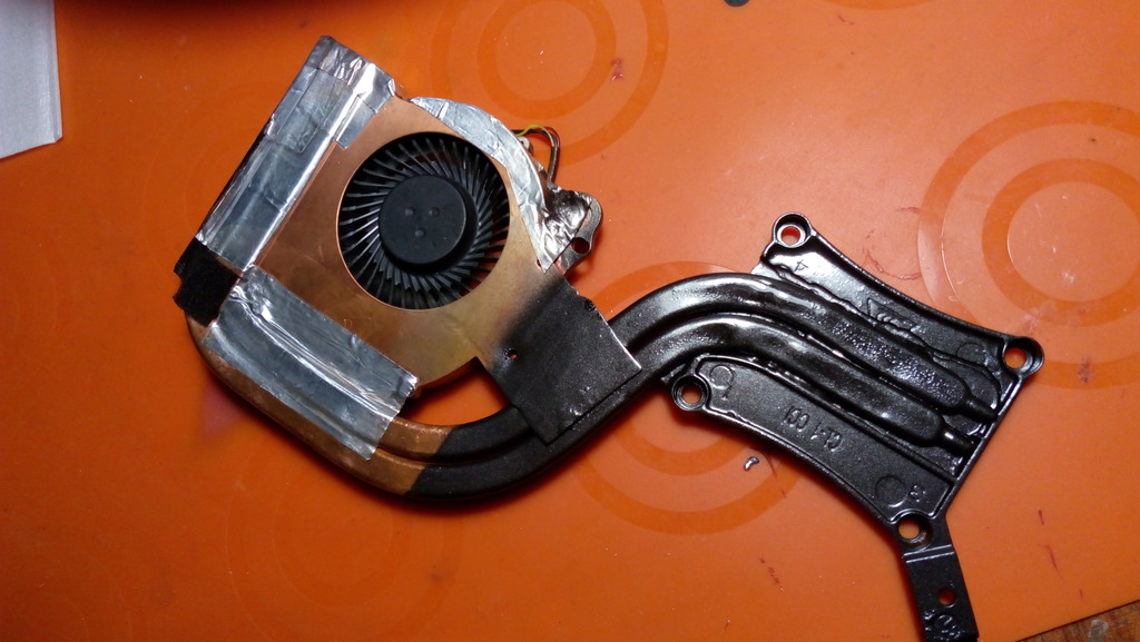

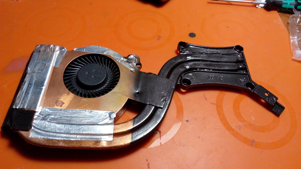

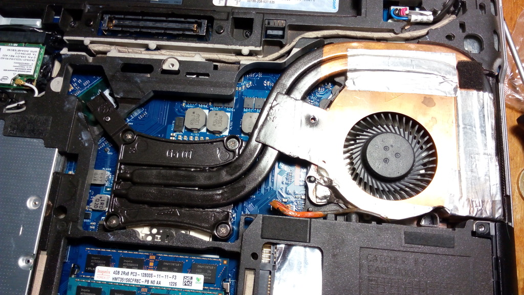

aldimeola81 Posted June 12, 2016 Share Posted June 12, 2016 (edited) after very much work i've modded the original cooler of my e6430 with igpu only combining it with the dgu model i've desoldered the cooper heatpipes from the dgpu model, and soldered to the cpu plate of igpu only model, the plate must be machined to insert two cooler instead of one in place. during soldering the opposite part of the heatpipes must be submerged in water or it will be desoldered and everything will be destroyed. The necessary temperature has been obtained using an hot air gun setting to the max( around 800°C) the alluminum tape is not strictly necessary is only to avoid small air leak , everythink is soldered copper to copper here are the pictures of the final result. Edited June 13, 2016 by aldimeola81 3 Quote Link to comment Share on other sites More sharing options...

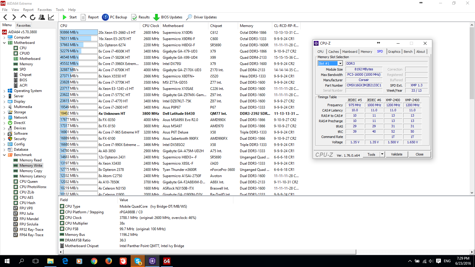

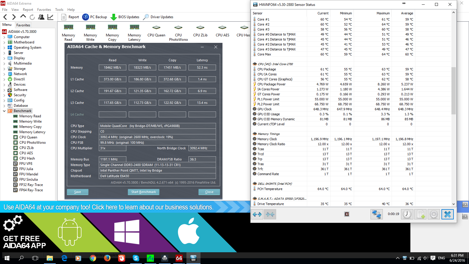

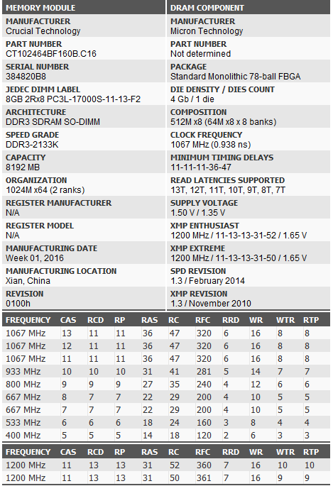

deathwingbg Posted June 24, 2016 Share Posted June 24, 2016 Wow this laptop is full of wonders I was able to boot and even make some tests with single channel RAM set to 2400 MHz So far i have never had problems with Dual channel set at 2133 MHz @1.35v directly as JEDEC (2x Crucial 8GB @1600MHz - - CT102464BF160B.C16) the cheapest RAM i could find ... I found some XMP profiles set to 2400 and decided to play a little bit further. Single channel is able to run some tests but gives blue screens and fails after few seconds of Prime95. Dual channel does not boot Tried 2400MHz (1.65v/1.5v): @11 13 13 31 50 361 7 16 9 9 @12 13 13 31 50 361 7 16 9 9 @13 13 13 31 50 361 7 16 9 9 @11 11 11 11 50 361 7 16 9 9 All fail Prime 95... played with other timings but no luck. BTW the CPU runs stable at 4x3.8GHz (3720QM QBC1) for higher frequencies it needs more voltage (And as timohour & Khenglish pointed out cannot be altered ) Too bad I bet this CPU can do 4.5GHz. Cannot wait to buy video card and play with the eGPU once again ( i had for a while but I sold it shortly after i bought this laptop) 1 Quote Link to comment Share on other sites More sharing options...
