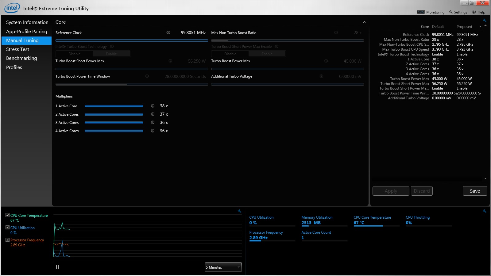

badbadbad Posted September 30, 2015 Share Posted September 30, 2015 I successfully flashed the Unlocked Descriptor, OC ME Firmware, and the x2.2 link. My only problem is finding the right XTU version with the Core Clock Slider. EDIT: Thanks @timohour, reflashing that MEOC FW you sent me did the trick! Quote Link to comment Share on other sites More sharing options...

timohour Posted October 1, 2015 Author Share Posted October 1, 2015 I successfully flashed the Unlocked Descriptor, OC ME Firmware, and the x2.2 link.My only problem is finding the right XTU version with the Core Clock Slider. EDIT: Thanks @timohour, reflashing that MEOC FW you sent me did the trick! Happy it worked... Seems like we have to edit every MEFW... I am maybe going to try to flash the one I edited for you on my machine to see how it goes... Yeah, i'm in! Laptop incoming Glad you made it... Specs? dGPU/iGPU mem CPU Quote Link to comment Share on other sites More sharing options...

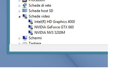

Dewos Posted October 15, 2015 Share Posted October 15, 2015 Hello, someone could give me some tips about the egpu? SO is Win 10 x64 UEFI Throughput, last BIOS. What I tried:- Plug after POST: Hd4000 ok, NV2000 ok, 660: code 23 - Hotplug egpu: Hd4000 ok, NV2000 ok, 660: code 23- Disabling NV2000 from device manager: Hd4000 ok, NV2000 disabled, 660: code 23 - Disabling NV2000 PCI bridge (Xeon® processor E3 - 1200 v2/3rd Gen Core processor PCI Express Root Port - 0151) and hotplug: Hd4000 ok, NV2000 disabled, 660: ok, but no external screen output and it keeps "Display driver stopped responding and has recovered"- - Disabling NV2000 PCI bridge (Xeon® processor E3 - 1200 v2/3rd Gen Core processor PCI Express Root Port - 0151) and reboot: Hd4000 ok, NV2000: none, 660: ok, but no external screen output and it keeps "Display driver stopped responding and has recovered"- - Disabling NV2000 PCI bridge (Xeon® processor E3 - 1200 v2/3rd Gen Core processor PCI Express Root Port - 0151) and reboot, suspend and restore session: Hd4000 ok, NV2000: none, 660: ok, with external screen output but it keeps "Display driver stopped responding and has recovered" every 10 secAny ideas? Do I need a lower TLOUD? I don't know what to do anymore. Quote Link to comment Share on other sites More sharing options...
Dewos Posted October 15, 2015 Share Posted October 15, 2015 I got my hands on an external screen to experiment with, and the following conclusions have been drawn:My EXP GDC Beast works ONLY if:- I boot from the eGPU directly (booting from iGPU will either stall my boot, bsod, or make it to windows only for the driver to start crashing constantly once I connect the external monitor).- I use Gen1 Expresscard (Gen2 will do all of the above, regardless from which device I boot). @sangemaru I'm in the same situation, driver start crashing constantly once I connect the external monitor. Win 10 gtx660. Oh, and not for disappoint you but my P4EL 1.2b full keeps gen2 on hp 2570p so probably the problem is elsewhere. Quote Link to comment Share on other sites More sharing options...

sangemaru Posted October 16, 2015 Share Posted October 16, 2015 For me, I set tolud at 2.5GB, I have iGPU set to always enabled, as well as forced primary. I also force PCIe speed to Gen1. I suggest you try it even if the 2570p can hold a link, who knows.That's about it. 1 Quote Link to comment Share on other sites More sharing options...
Dewos Posted October 16, 2015 Share Posted October 16, 2015 For me, I set tolud at 2.5GB, I have iGPU set to always enabled, as well as forced primary. I also force PCIe speed to Gen1. I suggest you try it even if the 2570p can hold a link, who knows.That's about it.Just tried: Win10 x64 UEFI Clean install (both) + windows update + last driver invidia + intel2570p: everything works plug and play, external screen, no problem at all. Gen 2 oke6430: fail, instabilitySince SO, drivers and eGpu device are the same, the problem should be somewhere in the motherboard or dGpu or default drivers. @sangemaru Maybe one of us could try Win 8.1 UEFI. Quote Link to comment Share on other sites More sharing options...
timohour Posted October 16, 2015 Author Share Posted October 16, 2015 Just tried: Win10 x64 UEFI Clean install (both) + windows update + last driver invidia + intel2570p: everything works plug and play, external screen, no problem at all. Gen 2 oke6430: fail, instabilitySince SO, drivers and eGpu device are the same, the problem should be somewhere in the motherboard or dGpu or default drivers. @sangemaru Maybe one of us could try Win 8.1 UEFI.May I give an advise? Try uninstalling nvidia drivers and plug before post. Start up your computer (it may have a blank screen it is normal but it should start up after a while. If you don't see an image on your external screen after a while (it will take a little longer than normal) try connecting a screen on the HDMI port on your laptop (it is wired directly to your NVS5200M)...I didn't have any problem my EC with my R9-280x @ x1.2 running W 8.1 so I kind of doubt there is a hardware issue (I am not sure though cause haven't tested with an Nvidia card).Code 23 seems like an unusual error... maybe something going on between the mobile and the desktop nvidia driver?Try the above and get back 1 Quote Link to comment Share on other sites More sharing options...
Dewos Posted October 16, 2015 Share Posted October 16, 2015 May I give an advise? Try uninstalling nvidia drivers and plug before post. Start up your computer (it may have a blank screen it is normal but it should start up after a while. If you don't see an image on your external screen after a while (it will take a little longer than normal) try connecting a screen on the HDMI port on your laptop (it is wired directly to your NVS5200M)...I didn't have any problem my EC with my R9-280x @ x1.2 running W 8.1 so I kind of doubt there is a hardware issue (I am not sure though cause haven't tested with an Nvidia card). Code 23 seems like an unusual error... maybe something going on between the mobile and the desktop nvidia driver? Try the above and get back Thanks for the info @timohour but I already tried all of them. This is probably a driver\hardware problem, not TOLUD because the 660gtx is correctly recognized, but with an external screen the system is very unstable (on Win 10 at least, I'm now trying on Win 8.1). @Tech Inferno Fan It is normal that setup_var "xxx" shows "GUID does not match expected GUID, taking it nevertheless, expected a different size of the Setup variable, continue con care, bla bla bla"?. The output fon vars seems to me the right one, anyway. UPDATE: No luck on win 8.1 too (( all three gpu (i, e, d) are allocated but on external screen the system is very unstable. :\ UPDATE 2: Ok, I managed to isolate the problem: the truth is that everything works (optimus, Gen2, hotplug, plug from boot, disabling NV5200 or not etc...) a perfect system but ONLY with the internal screen. Every time I tried to connect my 24''... the 660 driver crashed, so the problem is the connection with an external screen (I tried both HDMI and DP). @timohour do you use one of these? Quote Link to comment Share on other sites More sharing options...
