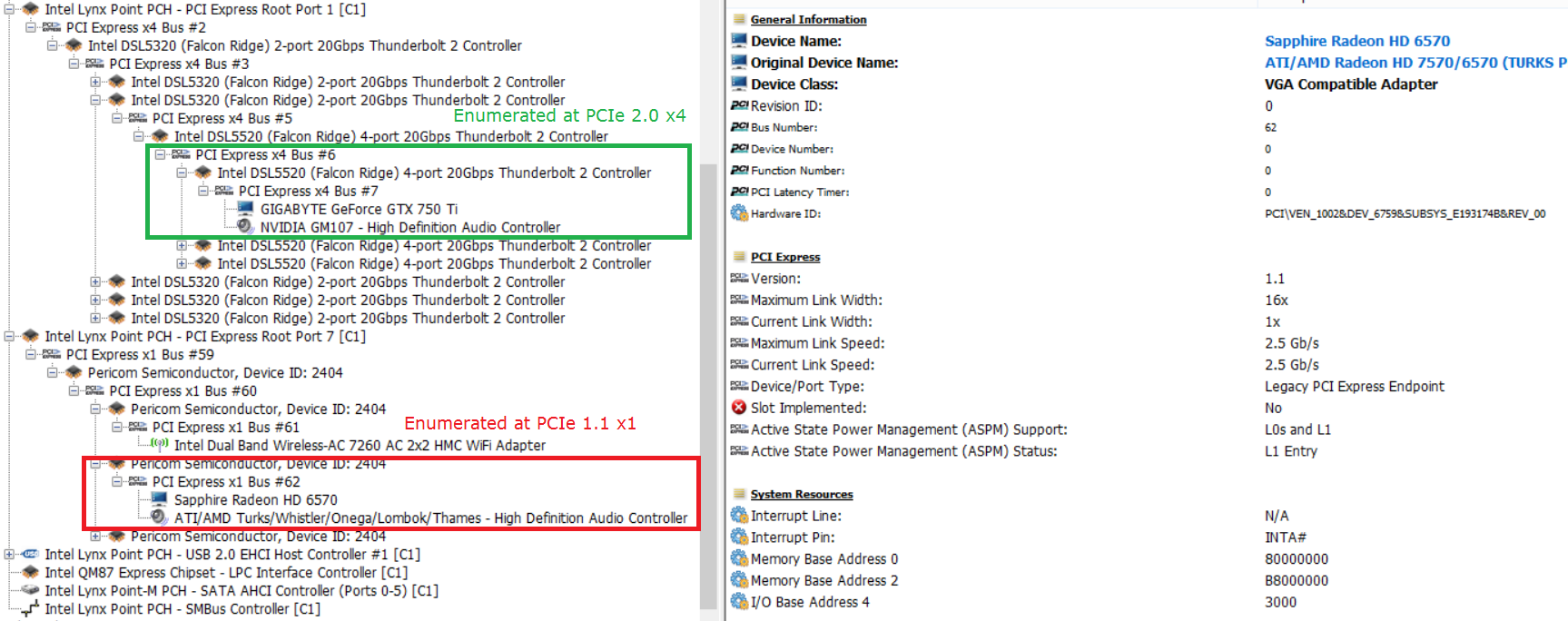

Despite the data telling me that this should not work, I decided to pull out my old PE4C V3.0 Expresscard to PCIe adapter (previously used with my Lenovo X230) and plugged it into the Expresscard slot on my HP ZBook 15 G2. The adapter currently has a Radeon HD6570 installed. To my surprise, the device was detected in Windows 8.1 (Enterprise, 64bit). I am using the latest BIOS (10/28/2015, M70 Ver. 01.13 according to HWiNFO).
Attached is a screenshot of the PCIe arrangement with the HD6570 enumerated at PCIe 1.1 with an x1 link. While this is the slowest PCIe gets, the slot is indeed functional, even if it seems that it cannot work at PCIe 2.0 x1 as nando stated above.
I wouldn't recommend this slot for eGPU use due to the very constrained link, but it can work to host a desktop sound card or another device where the lowered bandwidth would not be an issue, or to host a GPU for multiple desktop purposes (a Quadro NVS comes to mind).
The HD6570 doesn't share a WDDM driver model (1.2 vs 1.3) with my other video cards in this setup, so I cannot load its driver, but I will do my best to get another WDDM1.3 card that can work alongside so I can make sure that the slot truly works 100% with the latest BIOS.
