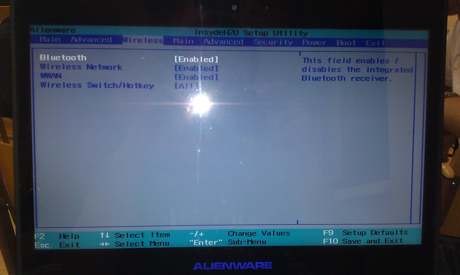

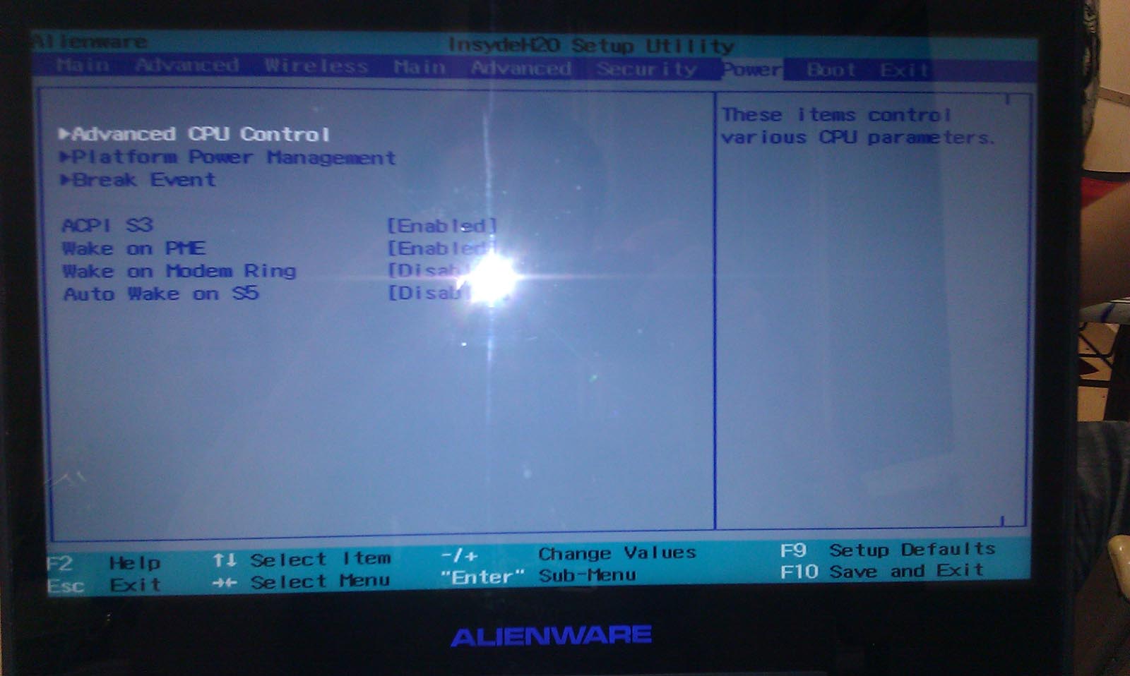

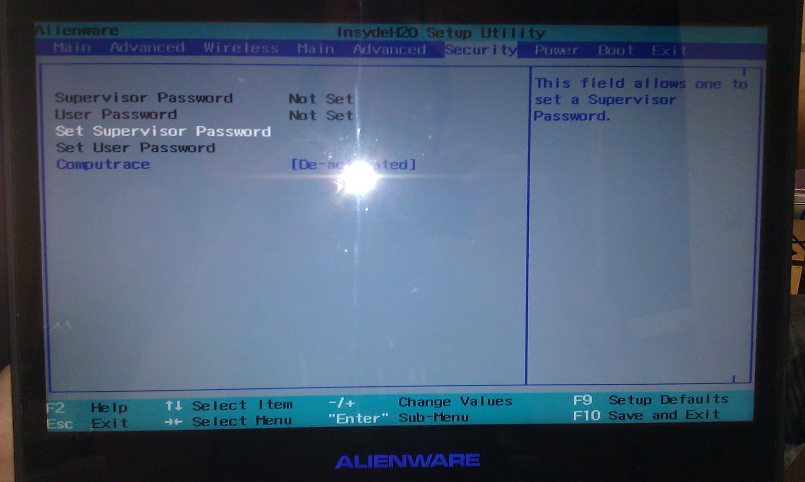

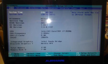

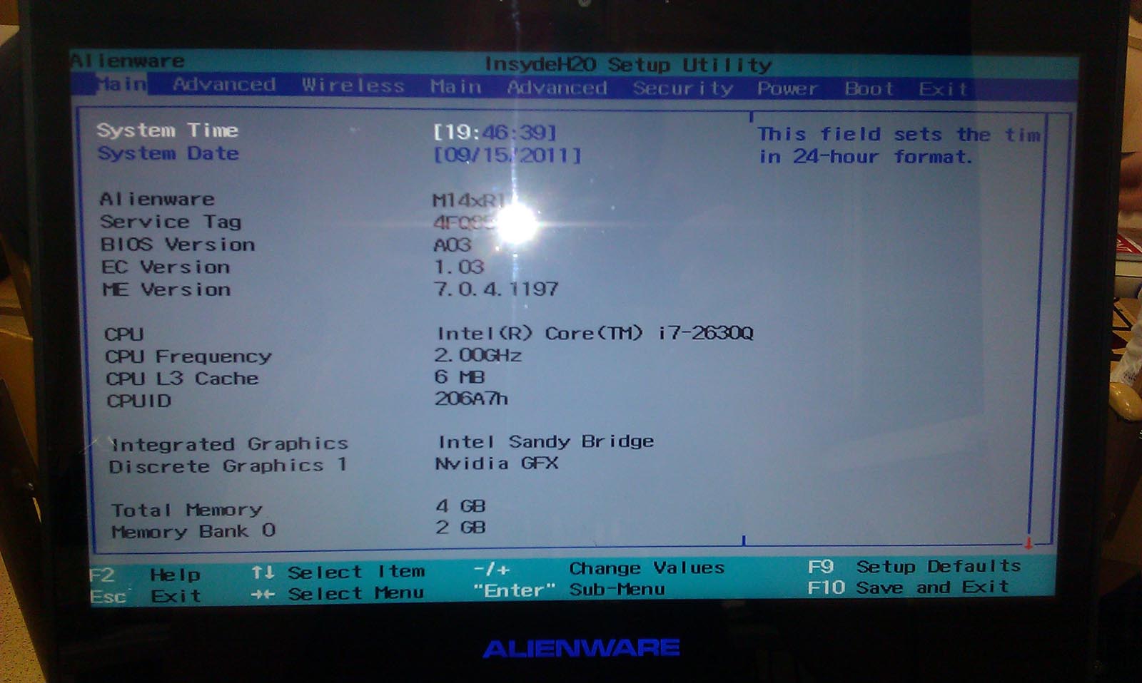

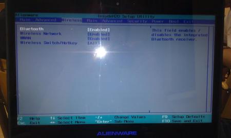

BIOS is tested and confirmed to work, pictures of the menus will follow.
Big thanks to @DaneGRClose for being the guinea pig (once more, lol).

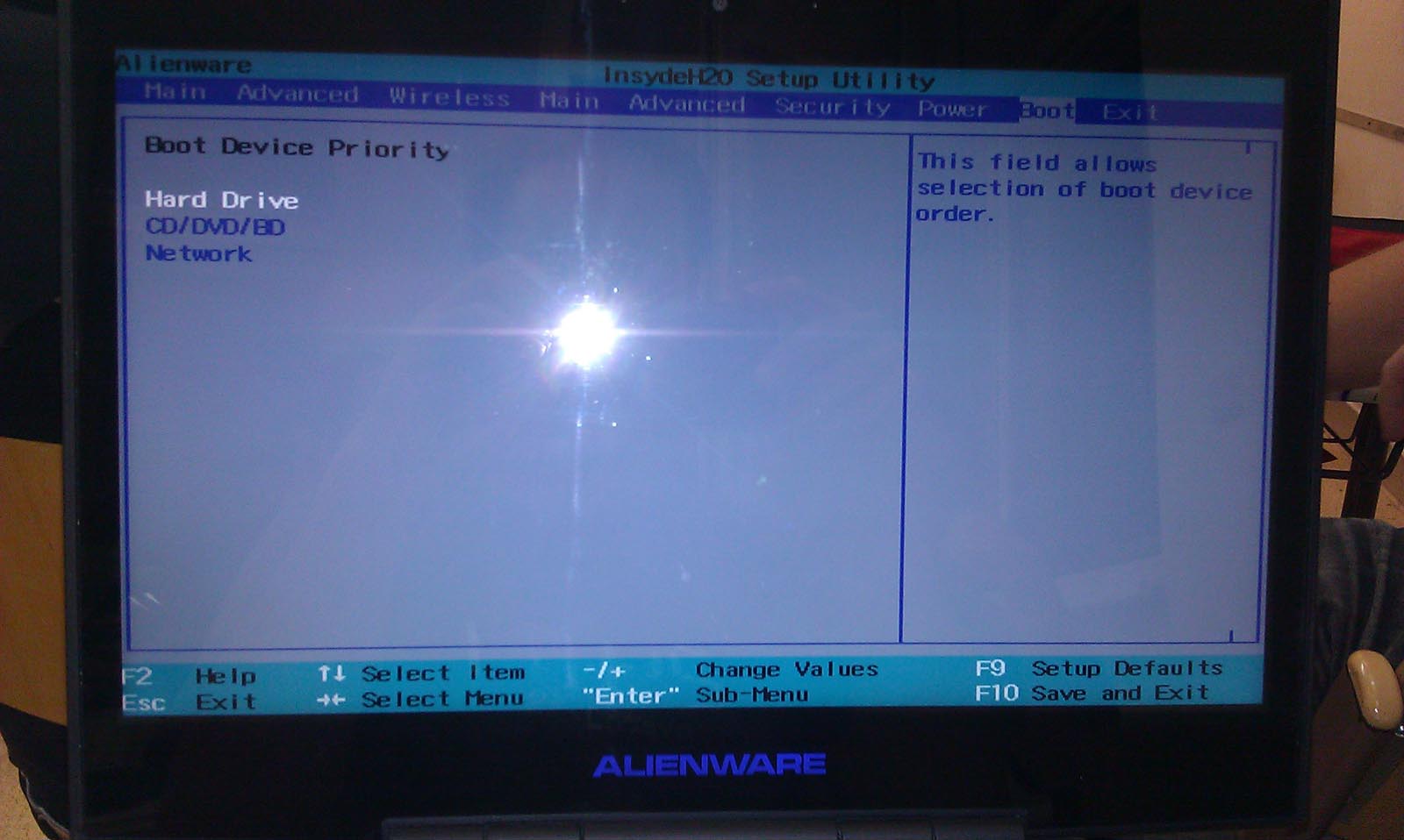

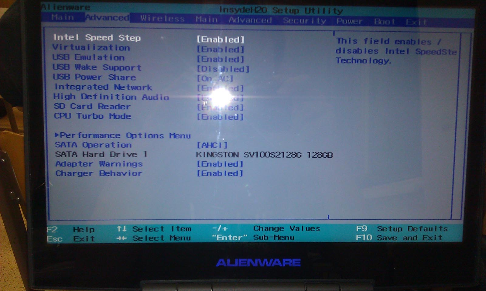

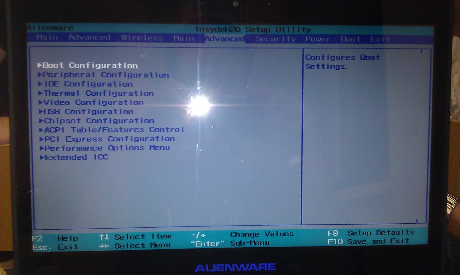

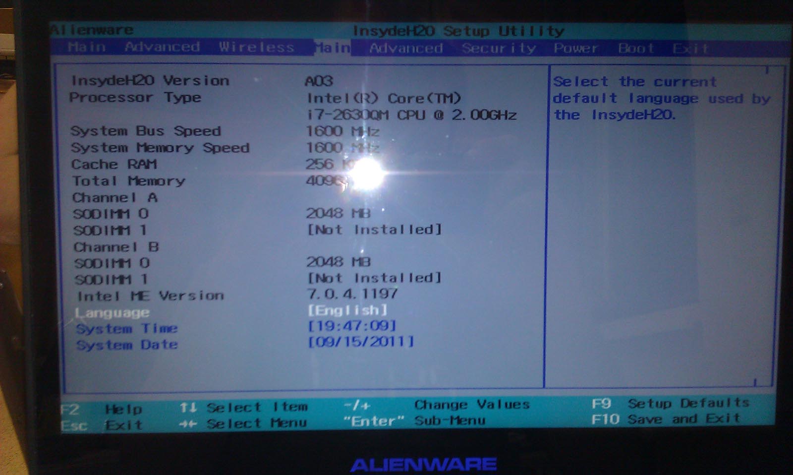

Here some pictures of the main menus, thanks @n3ocort3x for providing them!

Flashed this Bios, nothing seems wrong with it at all. It's basically the same exact thing that got put out for the M17xR3 that simply unlocks the rest of the hidden menus, nothing I can see in there that's gonna help much but I could be wrong.
Excellent work, +rep! (as soon as allowed) As I expected, just unlocked BIOS... the editor of the BIOS went on vacation for a while, so I haven't heard from him yet, but I hope he can somehow manage to extract the vbios or get access to some values... of it.
