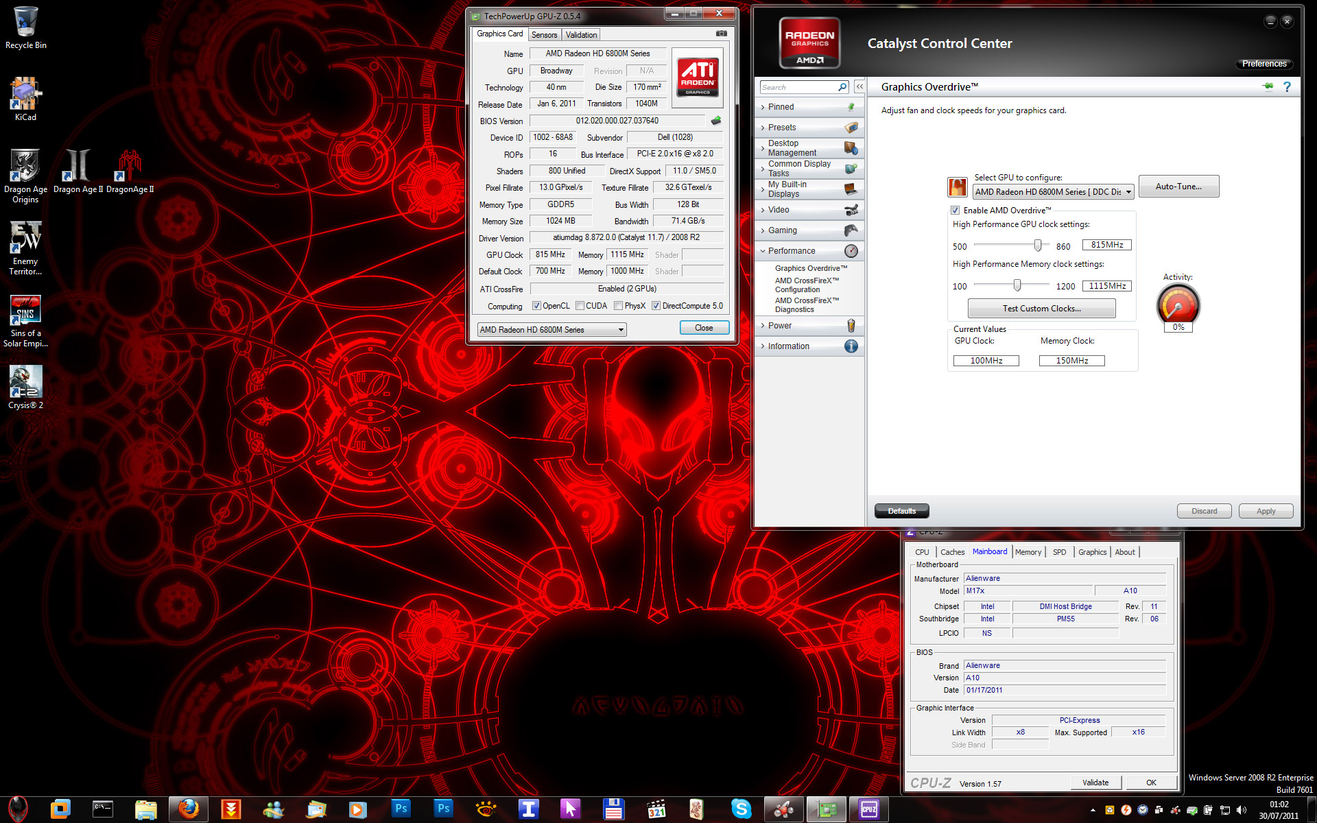

AssimilatorX Posted July 30, 2011 Share Posted July 30, 2011 (edited) 6870OD1.1v.rom.zipAfter i tried to mod my 5870's to FirePro M ended up with a different project, however i not given up just jet... But the project revealed something for me so i thought why not give it a try???? So here i ended up AMD 6870M CrossfireX with a fancy Overdrive Support in it 860/1200Mhz at 1.05v Used different methods to unlock that, (BAGZZlash's RBE ) and HexWorkshop v6 to peace it together... New ver 2 oc'd 800/1100Mhz 1.1v OD up to 860/1200Mhz 1.1v [ATTACH=CONFIG]1810[/ATTACH] Here if you need it, or want to give it a try... Edited August 3, 2011 by AssimilatorX Ver 2 5 Link to comment Share on other sites More sharing options...

AssimilatorX Posted August 3, 2011 Author Share Posted August 3, 2011 @AssimilatorX Nice mod dude! Did you notice any difference with regards to stability at higher clocks at or around the same voltage on this bios? I just would like to know if the 6870M Bios allows for more oc potential or is it the same as the old one. Max i able to get is 870/1250Mhz @ 1.15v but is incredible hot, stable @ 850/1200Mhz @ 1.11v. (locks-up the GPU after a few hour of play) Or wth standard (M17X) cooling the best heat/performance is @ 830/1150Mhz @ 1.1v Only problem is the heatsink unit unable dissipate that much heat.... Be honestly is all just experiment,and i dont wan't to kill my GPU's before due time so stick @ 800/1100Mhz @1.1 Link to comment Share on other sites More sharing options...
