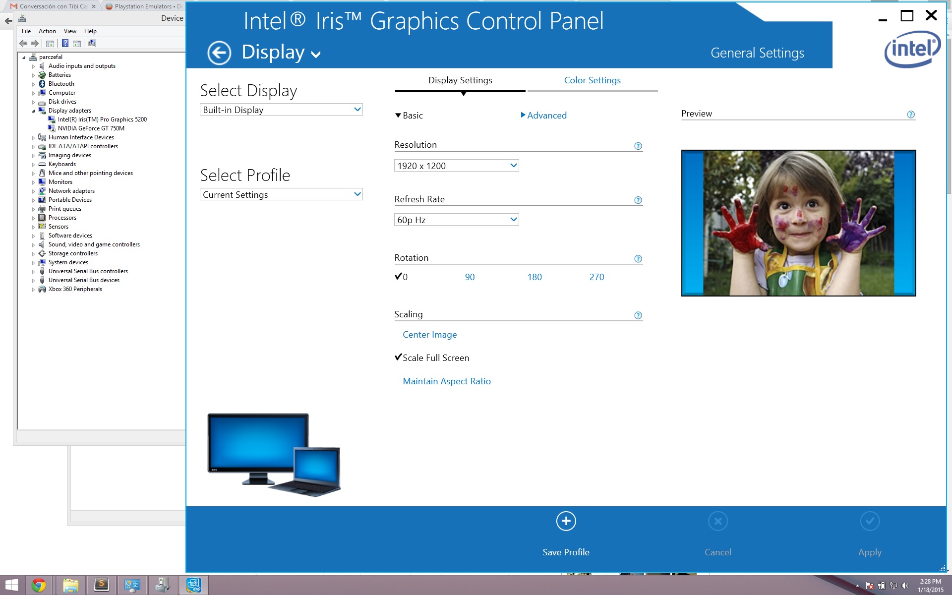

parczefal Posted January 16, 2015 Share Posted January 16, 2015 Hey Guys! Sorry if this is not the appropriate forum, or if this has been done already (I found no related posts). Long story short, I have the Iris Pro on the 15" Macbook (Mid 2014 with dGPU) partially working on Windows 8.1. I created a triple boot installation (Mac, Win 8.1, Arch Linux), patched Grub to fake the "booting-into-os-x" procedure, and forced the iris pro 5200 driver installation on windows. So far, I can only see the two devices working in safe mode, see screenshot below: I have tried uninstalling the nVidia card drivers and something weird happens after windows load, looks like there's a secondary screen, with a different resolution to the right of the "main" screen. I can move the mouse and everything, but I can't log in. If I disable the nVidia card, I just get a black screen after windows load. Any ideas? Suggestions? I was thinking maybe I could get my hands dirty with nVidia CUDA and code an applet to manage this stuff. I'm good with C/C++ but I don't know if that's possible at all. I can reveal more details if you want. Thanks! - - - Updated - - - This is basically the Grub hack: http://lists.gnu.org/archive/html/grub-devel/2013-12/msg00442.html I was thinking, maybe it's possible to completely disable the nVidia card from the Grub EFI console. Does anybody have any experience with that? Quote Link to comment Share on other sites More sharing options...

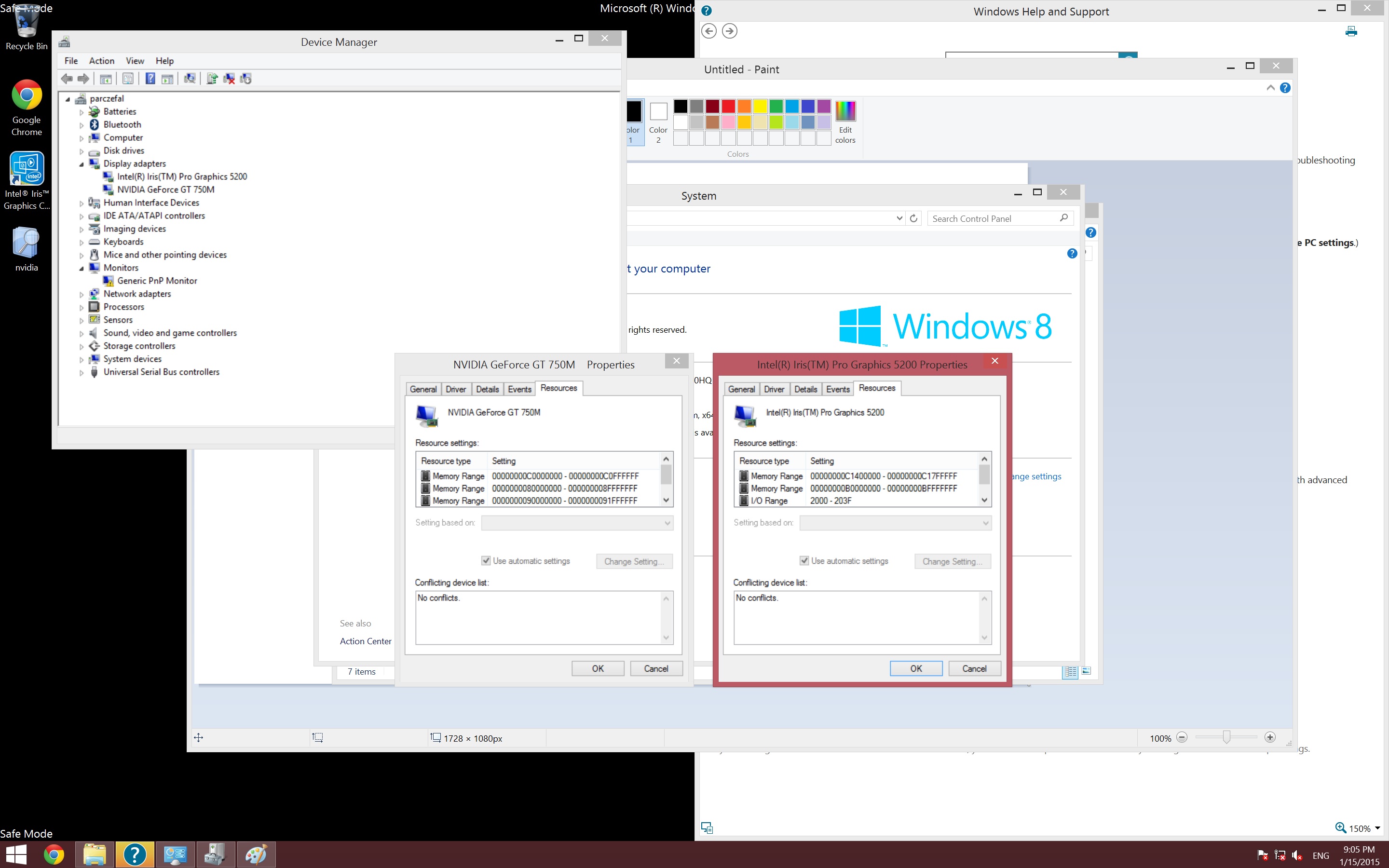

parczefal Posted January 16, 2015 Author Share Posted January 16, 2015 Update!I changed the nVidia driver in the Device Manager for it to use the Microsoft Basic Display Adapter. After the reboot, I was able to see the color I chose for the login screen. I tabbed twice, typed in my password and managed to get into the windows desktop!At first, it was using some type of "extended virtual desktop", but I managed to tweak some settings in the screen resolution applet to make the Color LCD my main desktop.I'm also able to reach the Intel Graphics Control Panel.Stay Tuned!- - - Updated - - -Have you seen this post: Win7 x64 booting natively via EFI (no BIOS emulation) - Page 42 - MacRumors Forums?And tried their tool? I was gonna test it later today..https://github.com/0xbb/gpu-switchHey Tre87!Actually, I found the hint to do this on those pages! Haven't had the chance to compile his code but I'll give it a go, I'll keep you updated! Quote Link to comment Share on other sites More sharing options...

parczefal Posted January 18, 2015 Author Share Posted January 18, 2015 I'll Probably need some help around here!So far I can boot to Win 8.1 using the Intel Iris Pro driver (5200) hooked to a "Virtual Display". Looks like the LCD panel is still hooked to the nVidia card with a Generic Driver.I've tried a couple of different things:Using reFind:Cloned the process outlined here: [GUIDE] 2012 15" Macbook Pro Retina + GTX560Ti@8Gbps-TB1 (TH05) + Win8.1 , however, the screen just goes black and I have to force shutdown my computer. This is how my .nsh code looks like:mm 7C2 1 ;IO :1stall 100000mm 7D4 1 ;IO :28stall 100000echo Switch Displaymm 7C2 1 ;IO :2stall 100000mm 7D4 1 ;IO :10stall 100000echo Switch DDCmm 7C2 1 ;IO :2stall 100000mm 7D4 1 ;IO :40stall 100000echo Power down discrete graphicsmm 7C2 1 ;IO :1stall 100000mm 7D4 1 ;IO :50stall 100000mm 7C2 1 ;IO :0stall 100000mm 7D4 1 ;IO :50echo enable iGPUmm 0001013E 1 ;PCI :8stall 100000mm 00020004 1 ;PCI :7stall 100000echo Boot Grubfs0:\EFI\Boot\bootx64.efiecho Switch selectThis is what the pci command drops in the EFI Shell:Vendor 8086 Device 0D04 Prog Interface 0[/FONT][FONT=arial]00 00 01 00 => Bridge Device - PCI/PCI BridgeVendor 8086 Device 0D01 Prog Interface 0[/FONT][FONT=arial]00 00 01 01 => Bridge Device - PCI/PCI BridgeVendor 8086 Device 0D05 Prog Interface 0[/FONT][FONT=arial]00 00 02 00 => Display Controller - VGA/8514 ControllerVendor 8086 Device 0D05 Prog Interface 0[/FONT][FONT=arial]00 00 03 00 => Multimedia Device - UNDEFINEDVendor 8086 Device 0D0C Prog Interface 0[/FONT][FONT=arial]00 00 14 00 => Serial Bus Controllers - USBVendor 8086 Device 8C31 Prog Interface 30[/FONT][FONT=arial]00 00 16 00 => Simple Communications Controllers - Other CommunicationsVendor 8086 Device 8C3A Prog Interface 0[/FONT][FONT=arial]00 00 1B 00 => Multimedia Device - UNDEFINEDVendor 8086 Device 8C20 Prog Interface 0[/FONT][FONT=arial]00 00 1C 00 => Bridge Device - PCI/PCI bridgeVendor 8086 Device 8C10 Prog Interface 0[/FONT][FONT=arial]00 00 1C 02 => Bridge Device - PCI/PCI bridgeVendor 8086 Device 8C14 Prog Interface 0[/FONT][FONT=arial]00 00 1C 03 => Bridge Device - PCI/PCI bridgeVendor 8086 Device 8C16 Prog Interface 0[/FONT][FONT=arial]00 00 1C 04 => Bridge Device - PCI/PCI BridgeVendor 8086 Device 8C18 Prog Interface 0[/FONT][FONT=arial]00 00 1F 00 => Bridge Device - PCI/ISA BridgeVendor 8086 Device 8C4B Prog Interface 0[/FONT][FONT=arial]00 00 1F 03 => Serial Bus Controllers - System Management BusVendor 8086 Device 8C22 Prog Interface 0[/FONT][FONT=arial]00 01 00 00 => Display Controller - VGA/8514 ControllerVendor 10DE Device 0FE9 Prog Interface 0[/FONT][FONT=arial]00 01 00 01 => Multimedia Device - UNDEFINEDVendor 10DE Device 0E1B Prog Interface 0[/FONT][FONT=arial]00 03 00 00 => Network Controller - Other Network ControllerVendor 14E4 Device 43A0 Prog Interface 0[/FONT][FONT=arial]00 04 00 00 => Multimedia Device - Other Multimedia DeviceVendor 14E4 Device 1570 Prog Interface 0[/FONT][FONT=arial]00 05 00 00 => Mass Storage Controller - UndefinedVendor 144D Device 1600 Prog Interface 1[/FONT][FONT=arial]00 06 00 00 => Bridge Device PCI/PCI bridgeVendor 8086 Device 156D Prog Interface 0[/FONT][FONT=arial]00 07 00 00 => Bridge Device - PCI/PCI bridgeVendor 8086 Device 156D Prog Interface 0[/FONT][FONT=arial]00 07 03 00 => Bridge Device - PCI/PCI bridgeVendor 8086 Device 156D Prog Interface 0[/FONT][FONT=arial]00 07 04 00 => Bridge Device - PCI/PCU bridgeVendor 8086 Device 156D Prog Interface 0[/FONT][FONT=arial]00 07 05 00 =>Bridge Device - PCI/PCI bridgeVendor 8086 Device 156D Prog Interface 0[/FONT][FONT=arial]00 07 06 00 => Bridge Device - PCI/PCI bridgeVendor 8086 Device 156D Prog Interface 0[/FONT][FONT=arial]00 08 00 00 => Base System Peripherals - Other system peripheralVendor 8086 Device 156C Prog Interface 0[/FONT][FONT=arial]00 00 00 00 => Bridge Device - Host/PCI Bridge Quote Link to comment Share on other sites More sharing options...

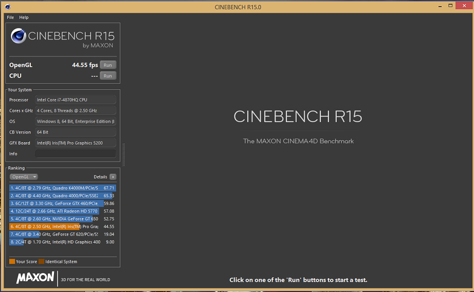

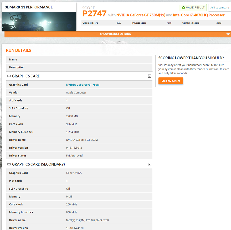

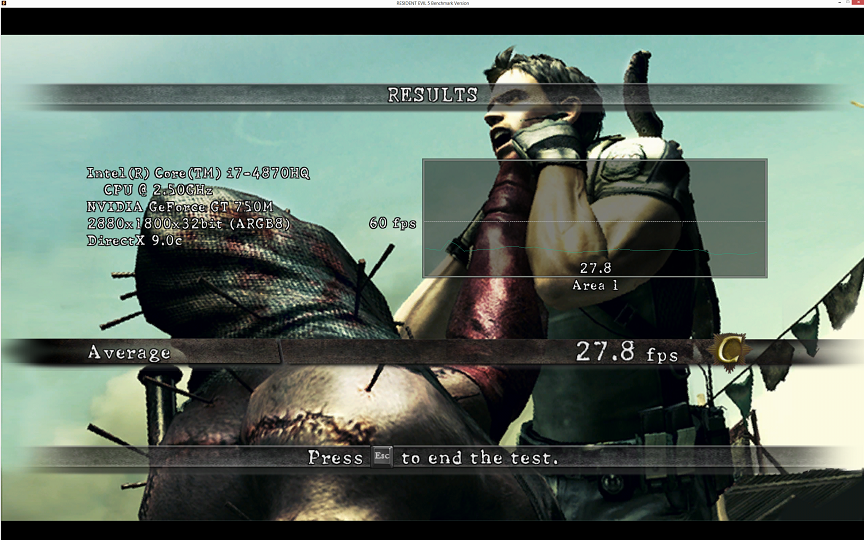

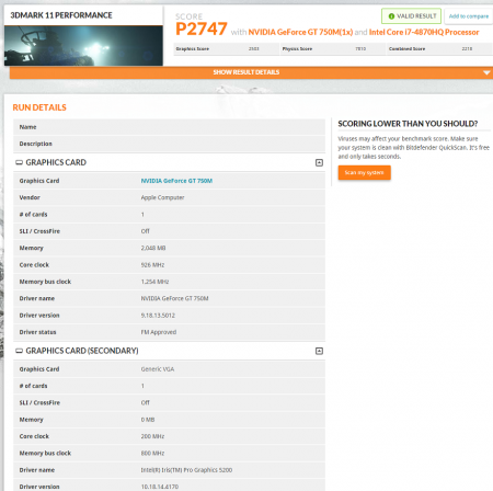

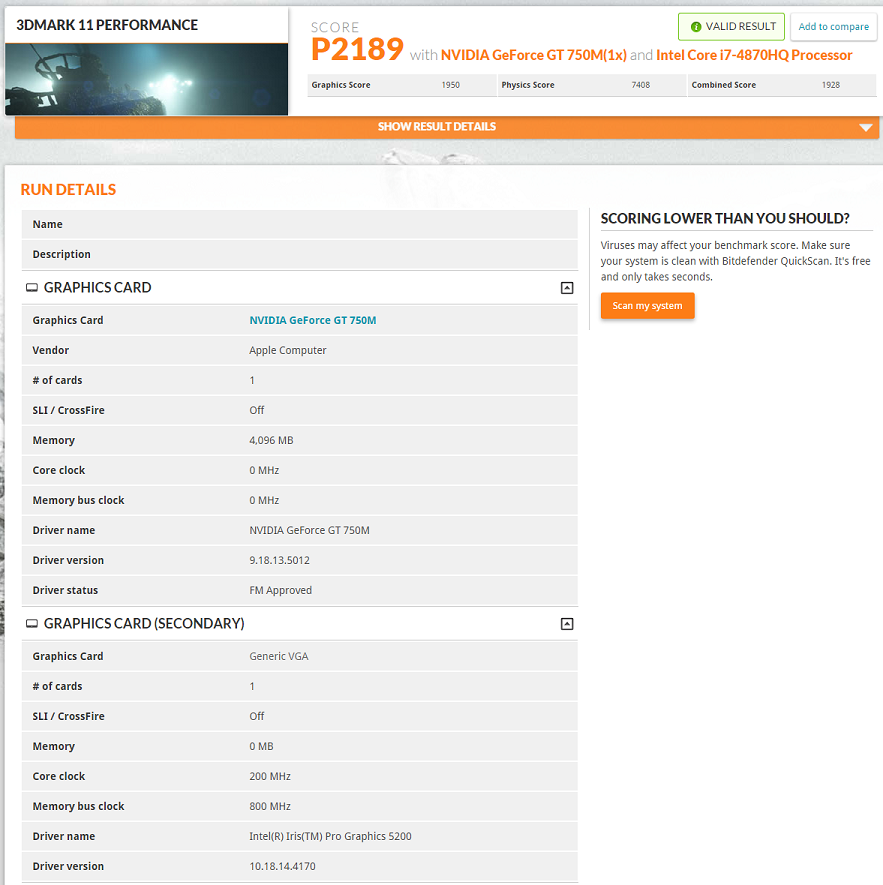

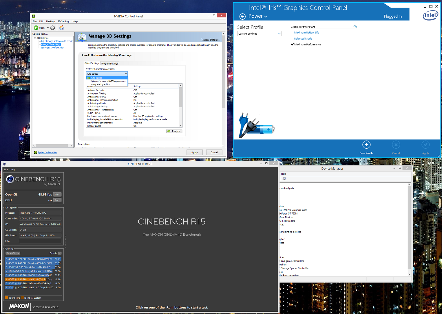

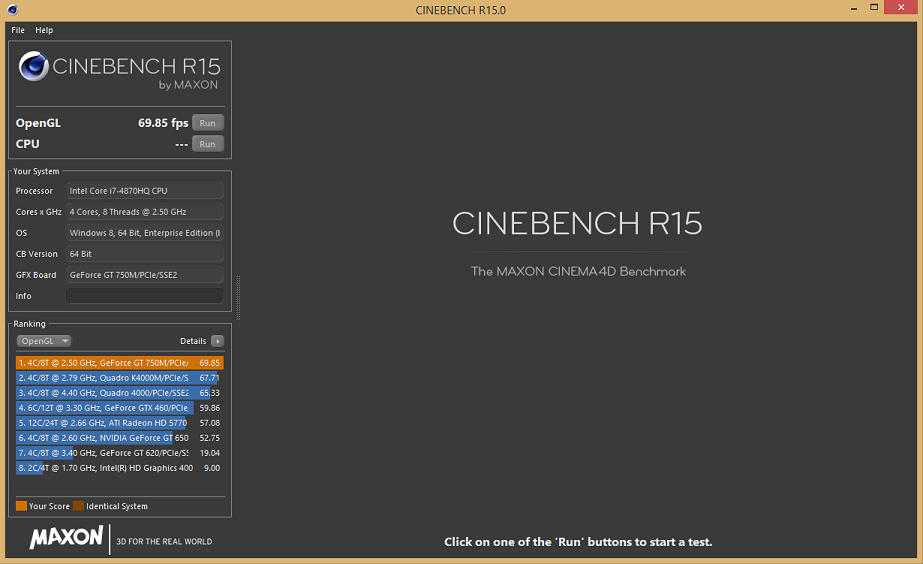

eeevan Posted May 7, 2015 Share Posted May 7, 2015 Hi Nando, Here are a few benchmarks. Resident Evil 5 Benchmark Iris 750m 3Dmark 11 (note the changing clock speeds) Iris 750m Cinebench Iris 750m Nvidia/Intel Control Panel w/ switching Quote Link to comment Share on other sites More sharing options...
Tech Inferno Fan Posted May 7, 2015 Share Posted May 7, 2015 Hi Nando,Iris does surprisingly well. Would you mind installing batterybar, booting the system up with each gpu as primary, pulling AC power anf checking the reported battery duscharge at idle? Iris should be noticeably lower making this iris switched mode desirable for on the road battery life. Quote Link to comment Share on other sites More sharing options...
