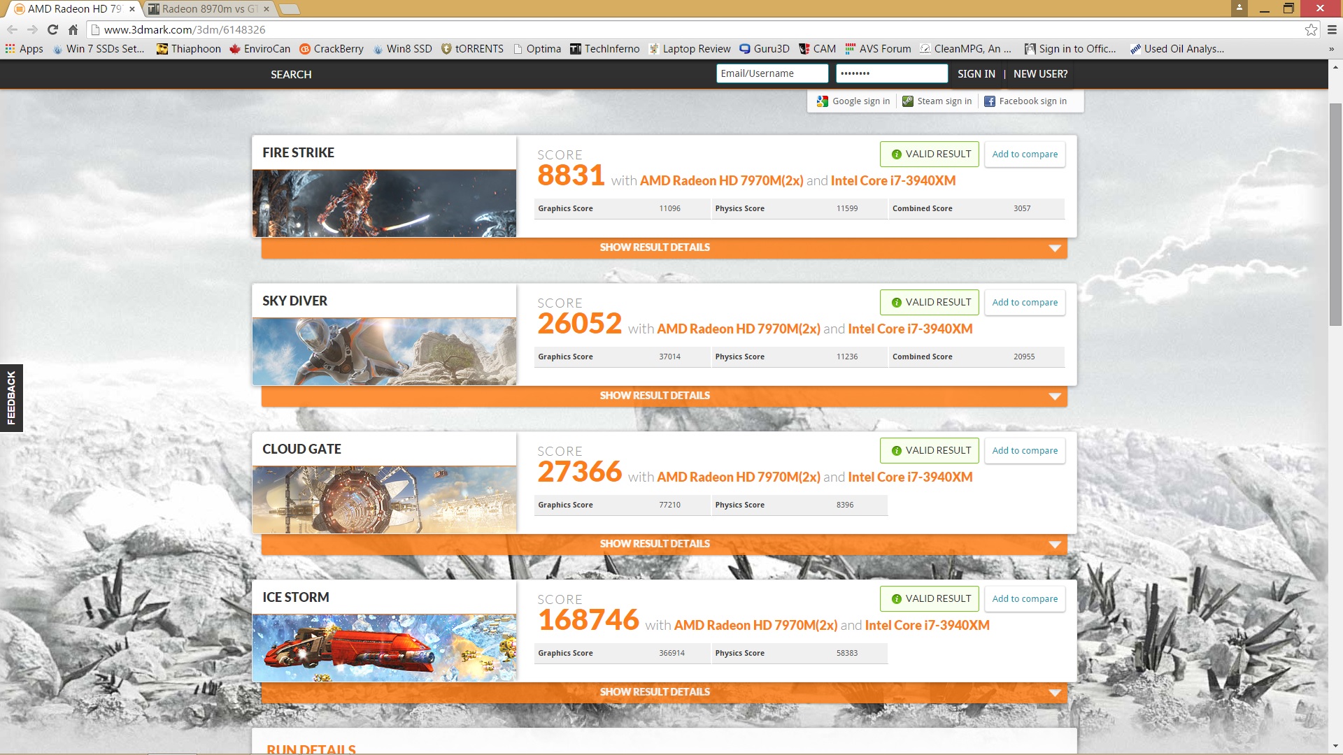

ht_addict Posted March 7, 2015 Share Posted March 7, 2015 My laptop originally came with the Radeon shitfire 8970 which to me were worse both in gaming and when watching my movies using SVP (smooth video project) because of the lack of CUDA so videos never looked as good using DXVA onlyanyway, the Radeon drivers suck so bad and they don't do DPI scaling well. I use a 125% scaling on my 18.4" screen Alienware replaced my laptop due to a diff. problem I had with the CPU and gave me this Alienware 18 you see in my sig, it came with the 780M GTX SLI out of the box I can play any game I throw at it at max specs. For a comparison, I recently got an ASUS G751JY laptop which had a GeForce 980M GTX (single not SLI) and the 780M GTX in SLI`s score were about 5% higher so I think it is pretty amazing that a 2 generation old card even though in SLI, still beats the latest and greatest 980M GeForce GTX 980M with 347.25 [W8] [ASUS G751JY] = GeForce GTX 780M SLI (344.75) [W8] [Alienware 18] = Just curious what the resolution is at? This is my score with my 7970M Crossfire at the default resolution. Quote Link to comment Share on other sites More sharing options...
Phoenix Posted March 16, 2015 Share Posted March 16, 2015 Just curious what the resolution is at? This is my score with my 7970M Crossfire at the default resolution.[ATTACH=CONFIG]14306[/ATTACH]my default resolution dawg which is 1920x1080 Quote Link to comment Share on other sites More sharing options...
