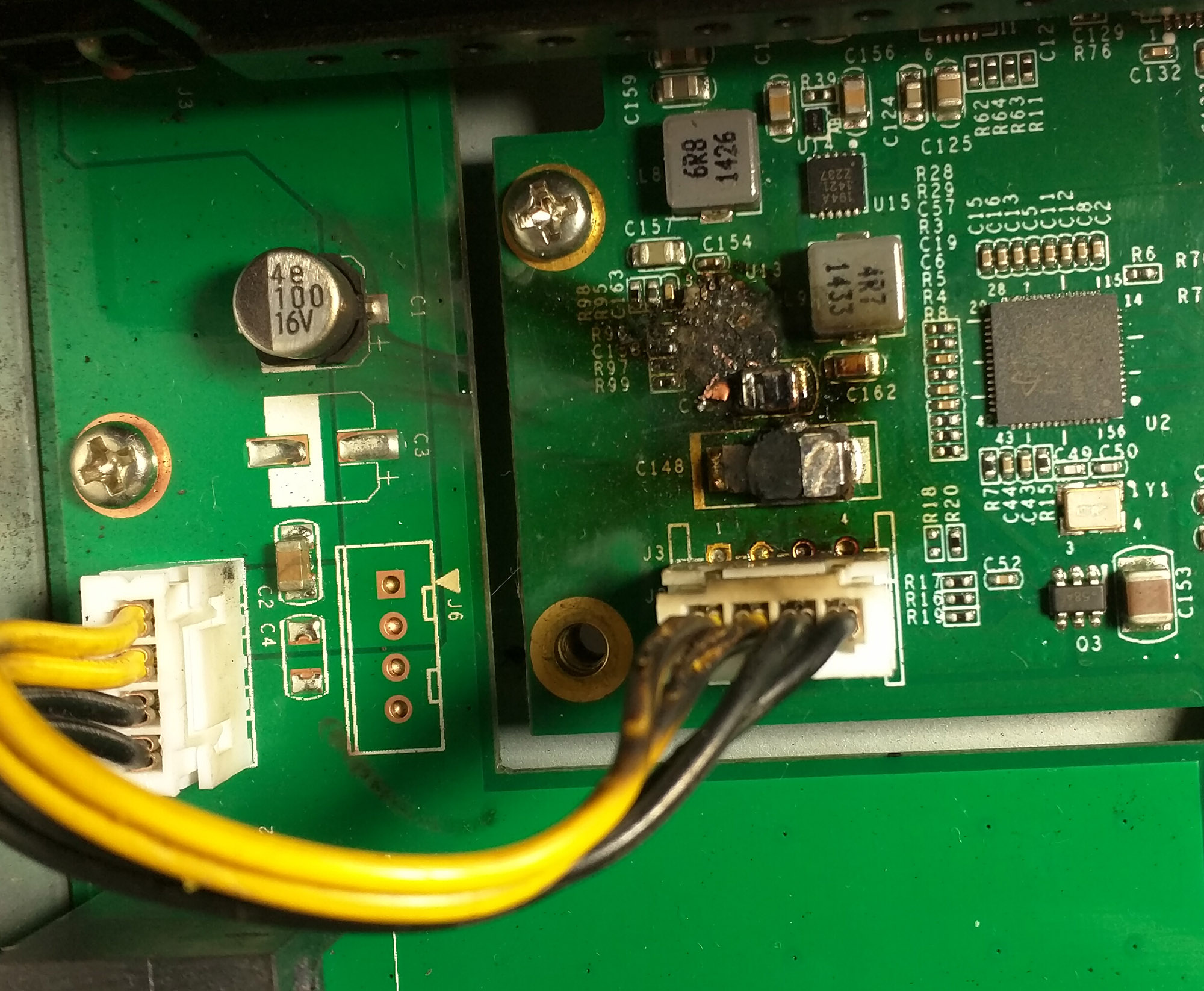

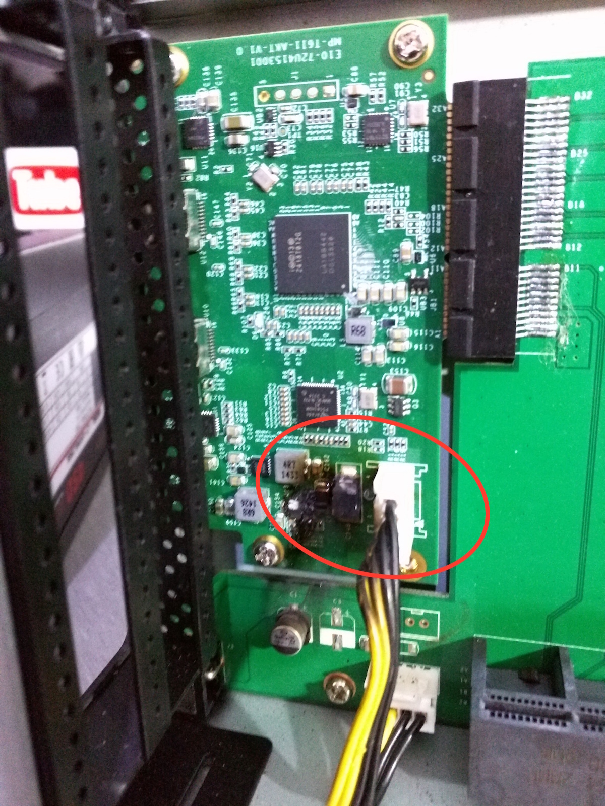

Was the barrel plug giving you 12V on the inner part of the plug and ground on the outer?!
Definitely! I double and triple checked :S
-Edit-
After a bit of research, it looks like I might be able to fix it by replacing the capacitor... Now I have little experience with replacing capacitors and have no clue what to buy...

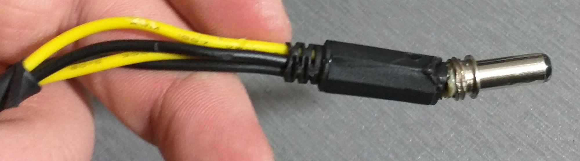

And can you take a picture of the adapter you made?
IMG_20160122_105901.thumb.jpg.154f360d88
Not my best work (super messy), but heatshrink wrapped around the seperate cables inside the sleeve to make sure they dont touch....

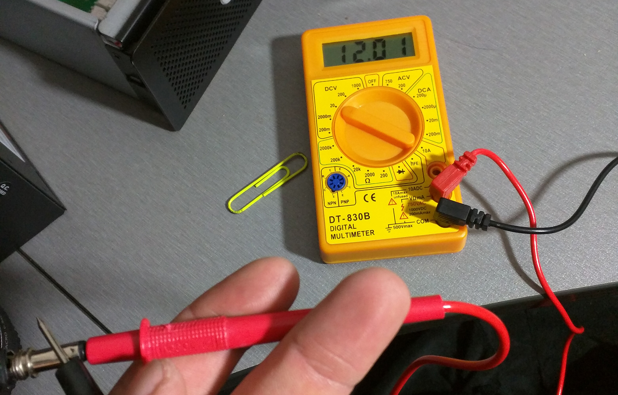

Here's the multimeter reading

I think my board is permanently damaged after a closer look. A new capacitor isn't going to fix all the damage.
I'm just hoping my GPU isn't damaged...
I've ordered a new Akitio and I can only hope that someone wants the broken unit or even just the chassis for a few bucks on ebay.

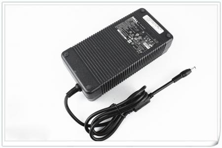

Saw someone sell DA-2 220W Power Supply with  5.5 * 2.5 mm connector at the end.
Link : http://item.rakuten.co.jp/is-design/220w/ (Note the page is in Japanese, use Google Translate)
1.thumb.PNG.a227ba72c1c28ee4bf4d0401f001imgrc0065063802.thumb.jpg.334c94f0ae037b
The output is 12V 18A, is it going to work for those who is thinking of buying GPU's that only need the barrel power supply on the akitio to power on? (Exp: Galax GEFORCE GTX 750 OC SLIM 2GB)
Edit: Will it overpowered the GPU or Akitio Thunder2 since the power supply provides 220W, was thinking of getting this since I'm getting the Galax GTX750 (Even though it's not a good pick for those who want to upgrade their GPU that has 6pin/8pin power input later on, I think?)

Barrel plugs with screw terminals or colored cables will make it very easy for you to see where 12V and ground has to be connected to!
I can make a picture tonight with my voltmeter how I test the plug.
