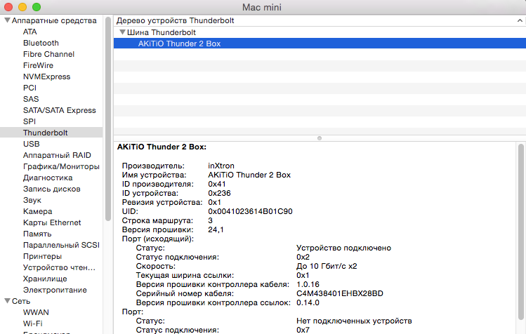

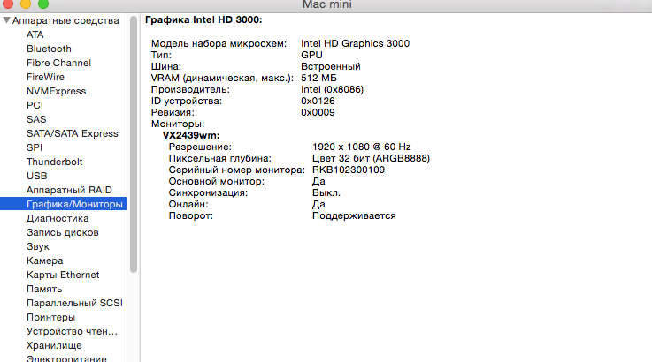

hypnosis Posted June 10, 2015 Share Posted June 10, 2015 Hello!I have same build like you but without pci-e-16x connector.When i connect rMBP to eGPU and boot up in windows - nothing happened. Windows booted like normal and eGPU light turn blue and fans star. There are no detected devices like eGPU in system manager and secondary display is not turn.Is it a problem with windows 10 via BootCamp? Is it problem with stock Thunderbolt cable which i use? (I use black thunderbolt cable placed in Akito Thunder box)I found build with windows 10, and everything ok. What your experience to connect eGPU with rMBP?egpu: - Akito TB2 - 600W Corsair - Molex2Barel plugin - Gigabyte GTX 970 4gb (long width) - stock thunderbold cableMac #1: - rMBP 15 'mid 14 w/ GT750M - OSX - Win 10 BootCampMac #2: - MacMini ' late 11 w/ IrisPro - 16 GB Ram - OSX - Win 10 Bootcamp Quote Link to comment Share on other sites More sharing options...
Dschijn Posted June 10, 2015 Share Posted June 10, 2015 @hypnosis: Please power your system this way:- turn on MB- press and hold "alt"- wait for chime and boot selection- turn on eGPU- boot into OS Quote Link to comment Share on other sites More sharing options...
hypnosis Posted June 10, 2015 Share Posted June 10, 2015 @hypnosis: Please power your system this way:- turn on MB - press and hold "alt" - wait for chime and boot selection - turn on eGPU - boot into OS It doesn`t help. I try several methods to boot and it is no effect. There is Thunderbolt device in windows 10 status menu, which i can safely eject. And there is thunderbold Akitio device in About Mac -> Thunderbolt devices But graphic card is not detected. I check GTX 970 on PC (my friends) everything ok, works. I check PCIe SoundCard (SoundBlaster) plugged in Akitio - doesn`t detect. I check thunderbolt cable (connect Mac Mini with rMBP in Drive Mode, ok) I try to run graphic card on Mac Mini (modify kext, install NVIDIA driver) but no effect What variants i should try? How else i can determine Graphic Card? I try to install pure Win 8.1 in Bootcamp , Nowtime. Maybe it helps... What are you think about problem? Do you have similar issue? How are you solve it? Quote Link to comment Share on other sites More sharing options...
Dschijn Posted June 10, 2015 Share Posted June 10, 2015 @hypnosis: Can you post a picture of your setup? Can you also change the OSX language to english when you post pictures here? Quote Link to comment Share on other sites More sharing options...
