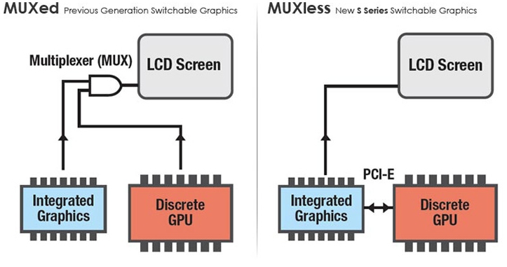

Wrong. Optimus relies on MUXless switching. If you have a MUX, you do not have optimus. You have what is called "fixed switching". End of story. Optimus runs on a muxless dynamic switching scheme, which is impossible to have on an Nvidia card on a MUX design. If you are running optimus, you are dynamically routing the video either to the iGPU or the dGPU, without restarting, though AMD managed to achieve fixed switching without restarts. If you have a MUX, you have to restart to change from iGPU to dGPU if you are running on an nVidia card on the MXM slot.
Have a look at the diagram here
The Alienware 18 is the only system Alienware has that uses a MUX switch. The Alienware 14 an 17 use a muxless design, which is why they both support optimus.
[ATTACH=CONFIG]13059[/ATTACH]
You are also wrong. A mux does not rule out optimus. A standard optimus system with no mux always has the iGPU routed to the display, and the dGPU sends data to the iGPU over the PCI-E link. The mux present in AW systems allow sending the iGPU or the dGPU to the display. This is true for all AW systems m17x R3, m18x R1 and later. If you route the dGPU (called PEG in the BIOS), optimus is off because the iGPU is disabled. If you route the iGPU (called iGFX in the BIOS) then optimus is enabled and the dGPU outputs display data to the iGPU over the PCI-E link just link on a standard system without a mux.
How would a MUX setup work with optimus then? The definition of a MUX is to disable one GPU and switch to another, unless you have a setup to keep both GPUs enabled and switch betwen the two.
A mux does not mean you disable a GPU. It just means you select an input to route to a display.
When routing the dGPU to the display the BIOS will disable the iGPU because there is no reason to have it on since it's the weaker GPU and isn't driving a display. It's turned off not due to a need for having it off, but for a lack of need of having it on. When routing the iGPU to the display (optimus mode) the dGPU is left on so it can render images for the iGPU to display, but since it is not driving a display it can shut down when idle. There is no switching, just offloading of rendering duty. This is exactly as if there was no mux and the iGPU was routed permanently to the display.
Multiplexer - Wikipedia, the free encyclopedia
