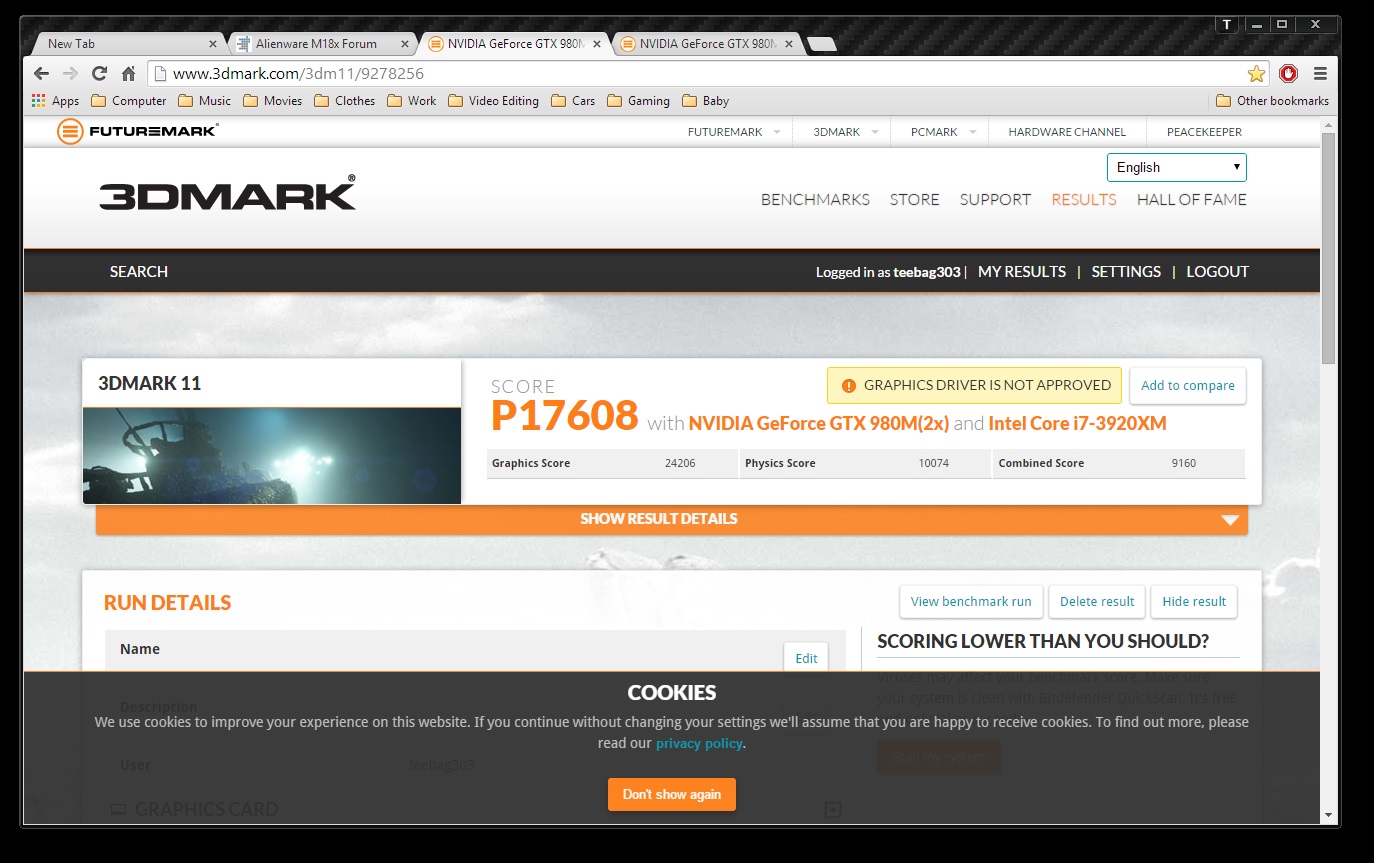

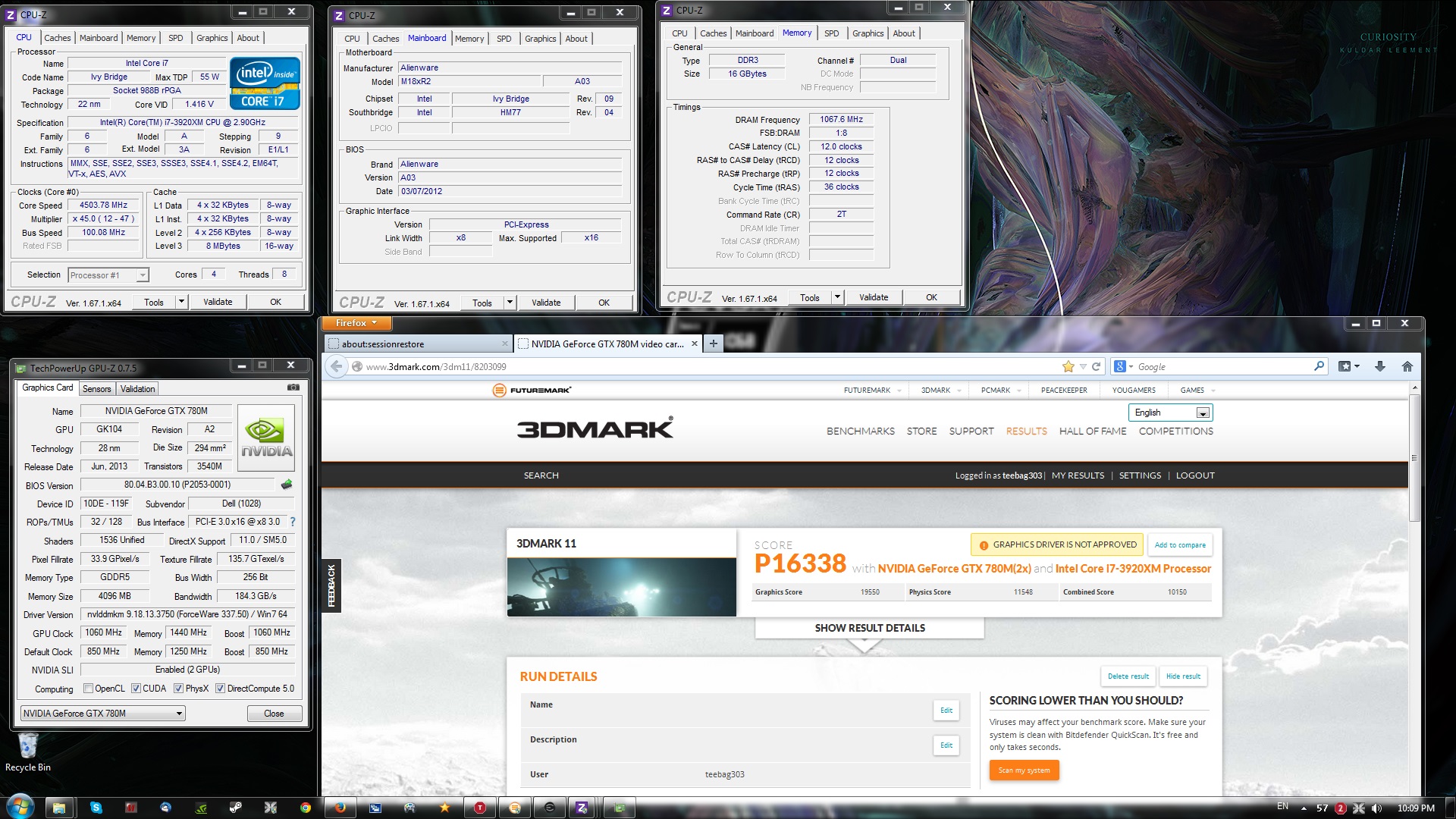

TBoneSan Posted January 20, 2015 Share Posted January 20, 2015 Billy 344.91 gave me the best results too. @ Ghost. If you normally game with overclocks greater than +135 on the core, don't get these. If you love to bench, don't get these However, if you just want to game within stock vbios limits, i'd go for it. I've no throttling on my cards but am limited to +135 being on the stock vbios and a limited selection of drivers (for now). I want to go beyond these stock vbios limits - do I need to? No, but it's fun. So I will have a problem should I want to move onto the current unlocked vbios as this seems to be how throttling is occurring. Hopefully this will put things into perspective Previous Personal Best 780m SLI OC P16338 - GPU SCORE: 19550 CPU: SCORE: 11548 Current Personal Best 980m Stock Score P17608 - GPU SCORE: 24206 CPU: SCORE: 10074 Look at the GPU score of my 780m SLI OCed to the limit of my single PSU. Then look at that GPU score of my stock 980m SLI. Also note my weaker CPU scores having moved to Windows 8 to be able to use 980m SLI. If you compare these results to Clevo P377SM-A results with 980m SLI it's practically the same, give or take within margin or error. Where I image a Clevo P377SM-A would smoke my machine would be unlocking the vbios and going beyond the Nvidia limitations. 2 Quote Link to comment Share on other sites More sharing options...
