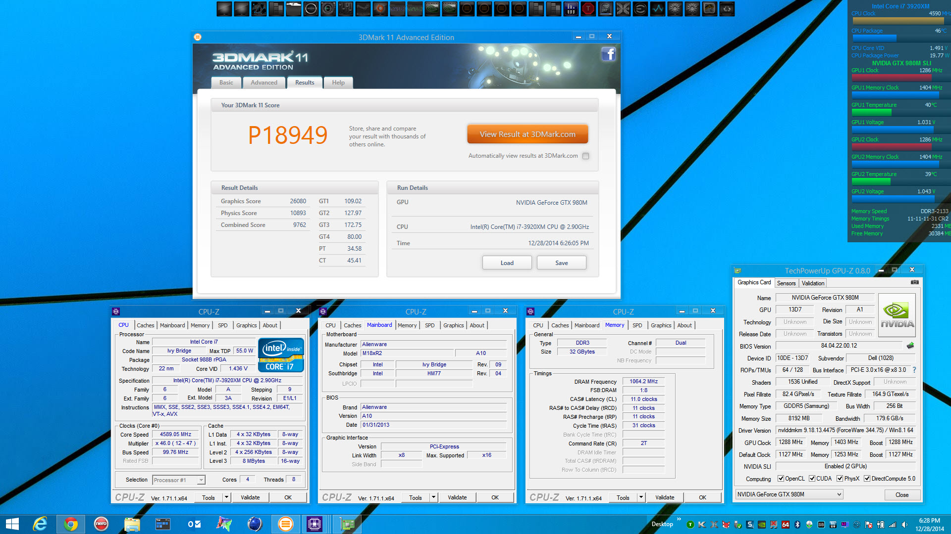

Hit or miss... when 980M SLI wants to work well it is amazing. When it doesn't, it garbage. It seems to have a mind of its own. I am hoping it is drivers. I'm regretting the upgrade and wish we could have worked something out for your Clevo P570WM3. But, live and learn. At least I will have a pair of 980M for a Clevo when I get one and I can buy a cheaper GPU like 780M SLI in the Clevo to replace the 980M cards in the R2.
This is with stock vBIOS using the stock (crappy) 347.09 locked-down turd driver. Even so, the 3DMark11 run is a shade (300 points) better than my highest 780M SLI overclocked score (see 3DMark 11 comparison, see Fire Strike comparison). So, even stock it is better except for the days it decides to throttle like a pile of junk, then 780M SLI kicks its butt.
NVIDIA GeForce GTX 980M video card benchmark result - Intel Core i7-3920XM Processor Extreme Edition,Alienware M18xR2
NVIDIA GeForce GTX 980M video card benchmark result - Intel Core i7-3920XM Processor Extreme Edition,Alienware M18xR2 [URL]http://i.imgur.com/FeprZkR.jpg

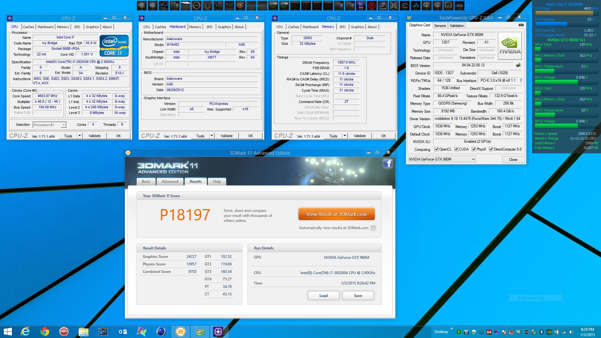

Here is another 3DMark 11 run exactly the same BIOS settings, ThrottleStop running but turned off, using driver 344.75 desktop mod with no GPU OC, and without any sub-3D clock GPU throttling.
344.75 Desktop Mod versus 347.09 Notebook Driver - Result

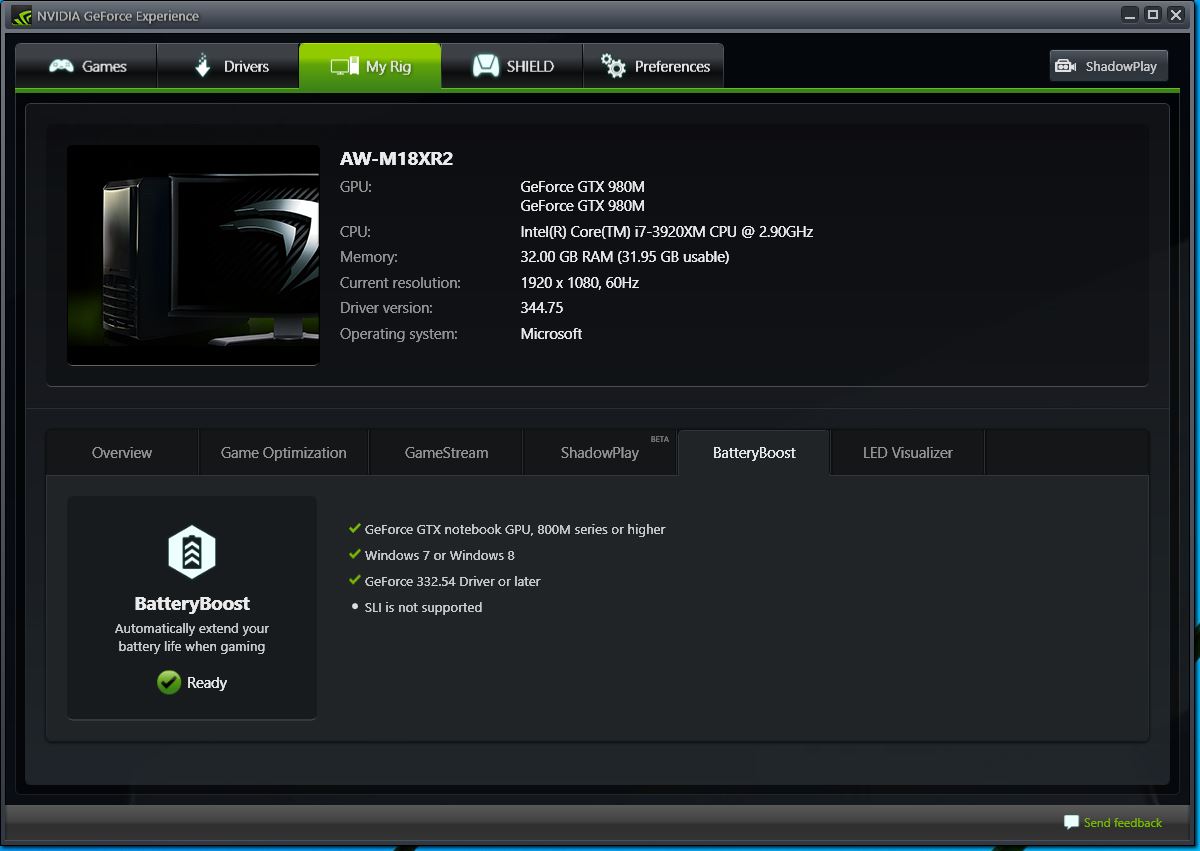

when did battery boost come into effect? is it possible to disable it via a driver setting or in the vbios?
because, like you Mr. Fox, i think it might be the cause of the throttling issues.
so while i am still confused as to the state of the performance of the GPUs it's good to see it's being worked out.
Battery Boost is new to 800M and 900M series. You can find it in GeForce Experience. With Optimus there is a way to disable it and a slider to adjust it on the "Preferences" tab. In PEG (dedicated) mode and SLI that option is not available. There is no box to uncheck and no slider. But, using my M18xR2 in Optimus mode, that feature did not change anything. Possibly due to immature drivers or my system not being compatible with it. I don't know if Brother mikecacho played with that on his M17xR4.
[ATTACH=CONFIG]13491[/ATTACH]

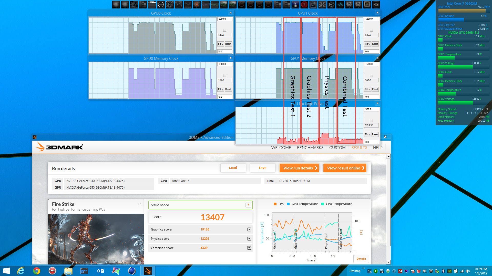

Here is what it looks like when it is in a "not throttling" mood. Nice, flat line for core and memory... the way it should always be, regardless of anything except for overheating. NVIDIA's "adaptive" trash has always been for the birds. I think they are morons for even attempting to develop garbage like that for a gaming system. It's nothing short of retarded, IMHO.
Although access to the Battery Boost might be "disabled" in the GeForce Experience UI on SLI or PEG mode, the cancer is still there, either in the drivers or vBIOS, or both, and the fact that it exists may be an explanation for the undesirable behavior. Whether it is Battery Boost or something else, there is a very strong correlation to power draw.
This short video is just one GTX 980M heavily overclocked in my R2 using Optimus mode. When it is throttling, on the days that it feels like throttling, the peak wattage you see in this video is the point that my core and memory clocks drop like a rock. The video is in a 3DMark11 Test 1 run with an overclock of about 1350/1400/1.100V. And, the peak wattage you see in this video is what my 980M SLI setup consumes running STOCK (no GPU overclock) in 3DMark 11 Test 1. Do this with a single-GPU AW17 or an M17Xr4 and a 240W AC adapter isn't going to end well either if Battery Boost is trying to save the day for the weirdos worried about using too much power.
