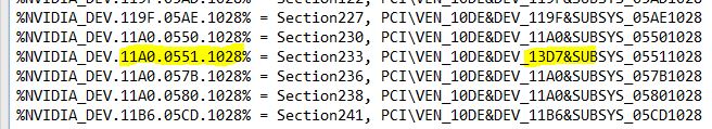

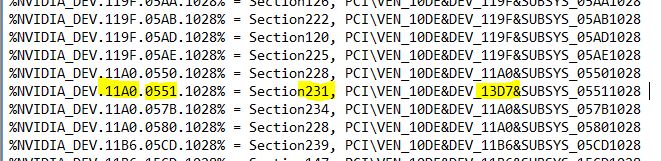

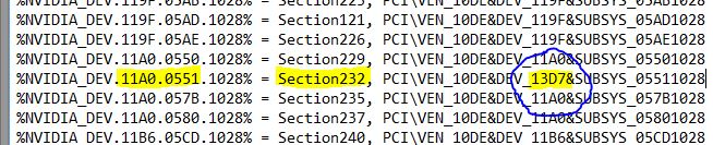

I'm not sure what Eurocom has done but the driver in this link for the R4 has ran 2 days now with no throttling and shows valid 3D Mark score, not sure what they changed exactly in the driver to make this happen but i would recommend using this driver (yes you have to use Optimus for a little longer) it works really well.
Index of /support/drivers/upgradeyourlaptop/Alienware
I'm going to compare .inf side by side to see what strings they changed

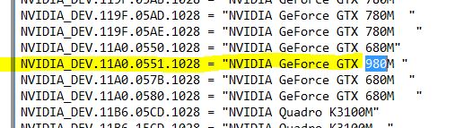

It appears all they did was change the string to run the 680m as 980m so it thinks its running 680m....

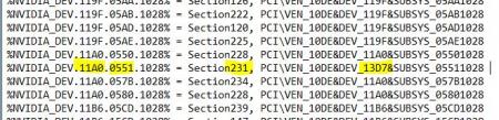

It appears all they did was change the string to run the 680m as 980m so it thinks its running 680m....[ATTACH=CONFIG]13420[/ATTACH]
%NVIDIA_DEV.11A0.0551.1028% = Section233, PCI\VEN_10DE&DEV_13D7&SUBSYS_05511028
Yep. little trick, features...:D 3DMark...:D...:D

Correct, it runs just fine with Optimus enabled, Modded the nvdmi.inf for the latest drivers 344.80 but I have to run Optimus to trick the OS to play nice and not throttle my card. Optimus I only lose about 1-3% performance in benchmarks. While gaming it appears to not hinder it at all, as I have done side by side comparisons and in some benchmarks (Heaven benchmark results were better than non Optimus). So ill deal with it for now, until that Dell Vbios comes available.
I tried to modify the strings "tricking" it to allow Non-Optimus, but without the Optimus, there just is no way of getting valid results, or a valid recognized card, which will result in the BIOS gimping the card over extended use.
