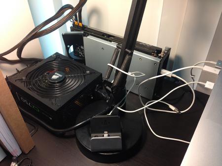

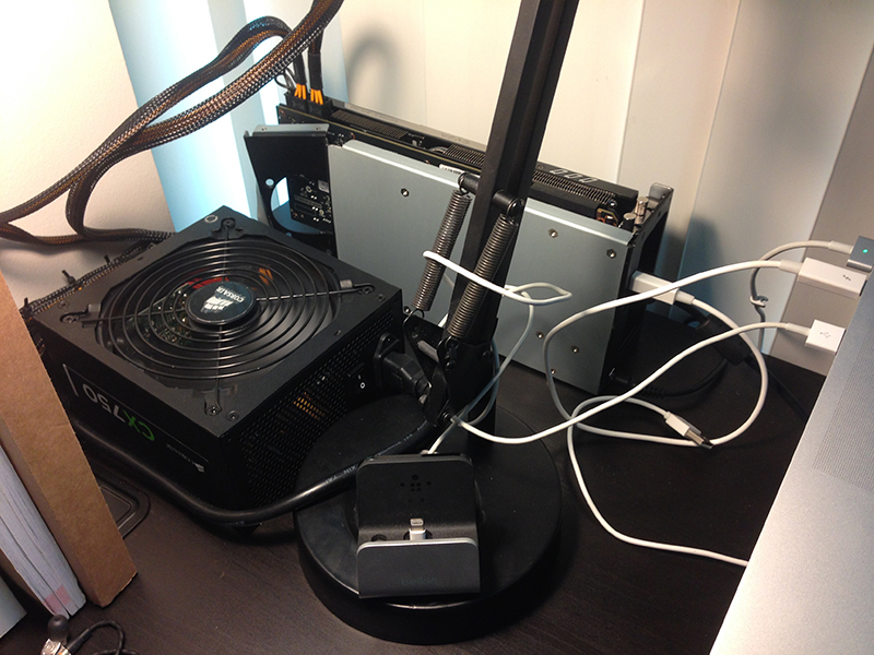

2013 15" MBP GT750M + GTX780@16Gbps-TB2 (AKiTiO Thunder2) + Win8.1 [328115208

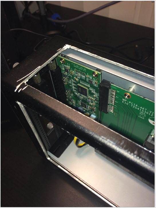

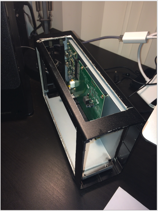

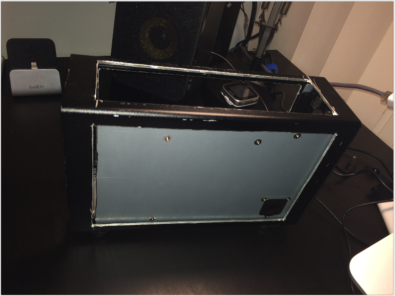

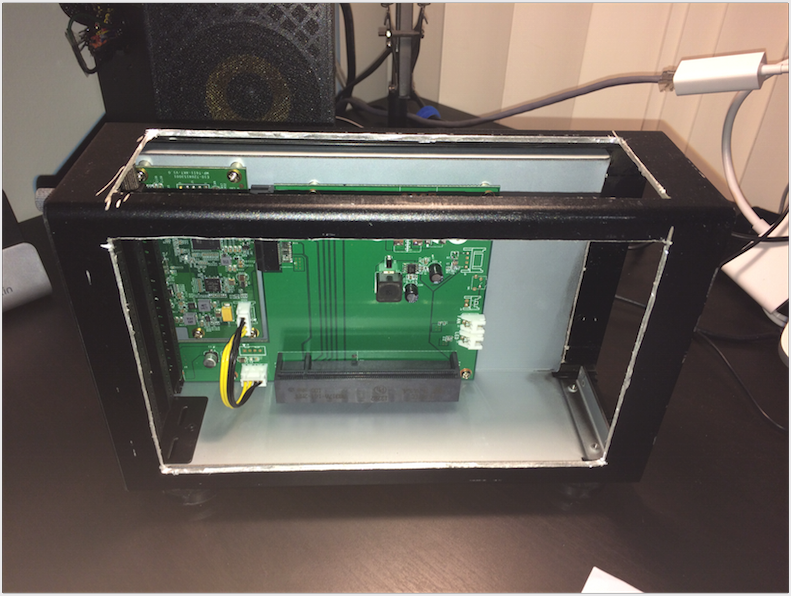

Late 2013 15" Macbook Pro GT750M + GTX780@16Gbps-TB2 (AKiTiO Thunder2 without riser)
AKiTiO Thunder2 is not big enough for ]GTX 780 get in. So I bent the box of AKiTiO TB2 :Banane45:

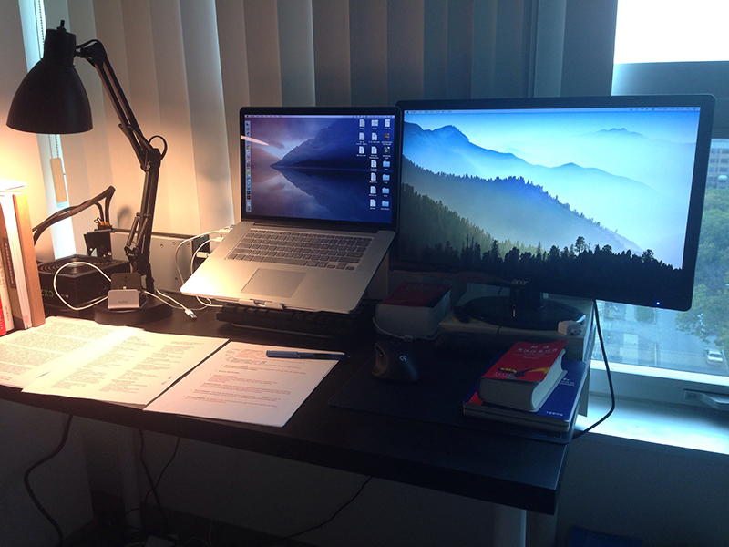

Anyone knows how to disable GT 750M? I cannot use eGUP in the inner screen.
Do I need to modify the EFi?
And in the Win8.1, Iris Pro is disabled, I cannot use inner screen with GTX 780. Using OSX 10.9.5.

I don't think anybody has found a solution to use the internal display with the 15" MacBook Pro + GTX 750M. But you have a great setup to use with an external monitor.
Yes, Apple firmware does not enable the iGPU in Windows. Without the iGPU you can not engage NVidia Optimus' internal LCD mode.

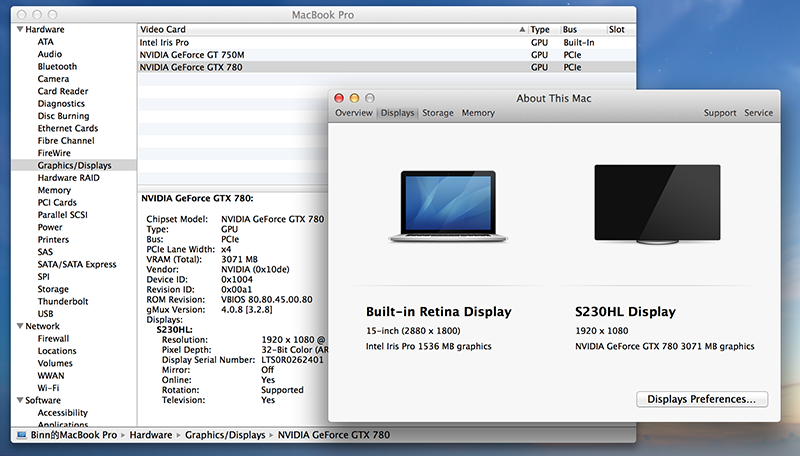

I do modify 3 kext. And the external monitor with GTX 780 does not work every time.
When external monitor using GTX 780 does not work, I disconnect the TB2. Then the OSX 10.9.5 crashed and restarted itself.
Then external monitor works.

Thanks for you clarification. You can try also just selecting restart from the main menu as Mark did. Some thunderbolt devices are hot-pluggable, but eGPUs are not. Disconnecting the TB cable will cause system crash and restart, I don't think it harms your hardware. The same can happen, when Mac goes to sleep mode and eGPU turns off. I found an interesting note from Apple regarding new iMacs and Mac mini (Late 2014) with Boot Camp:
