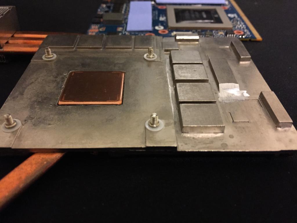

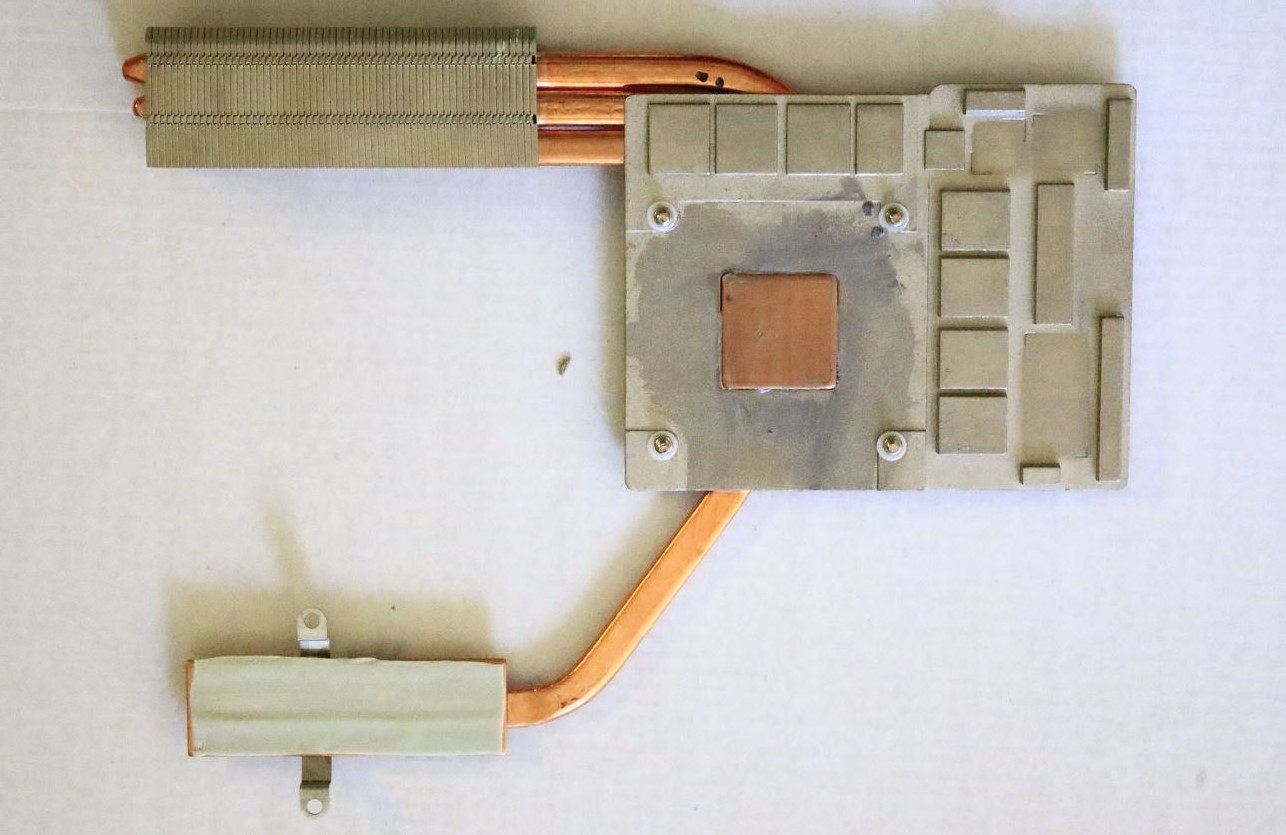

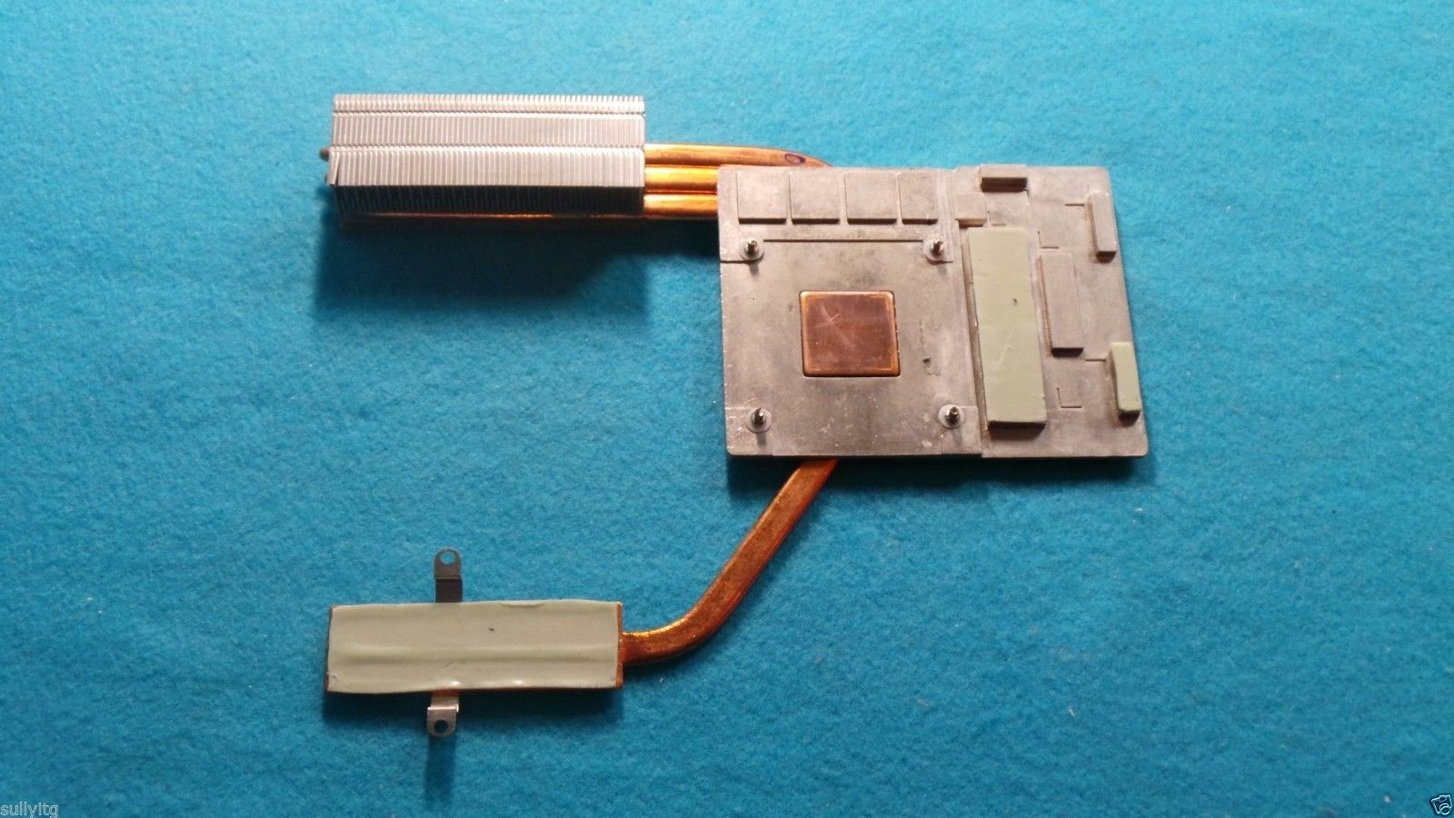

Yes, MSI use an other Heatsink for the GTX9**M Series, because the MXM Board has another Layout.
GTX9**M Heatsink:
GTX8**M / GTX7**M Heatsink:

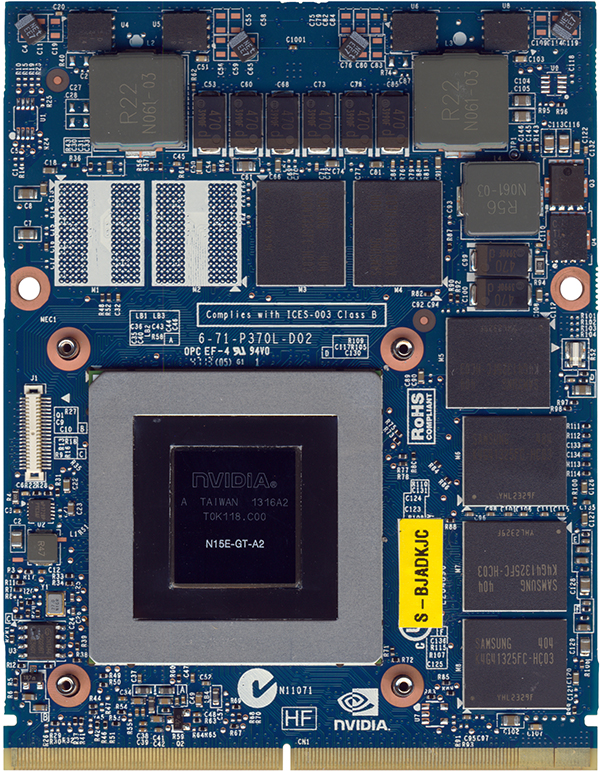

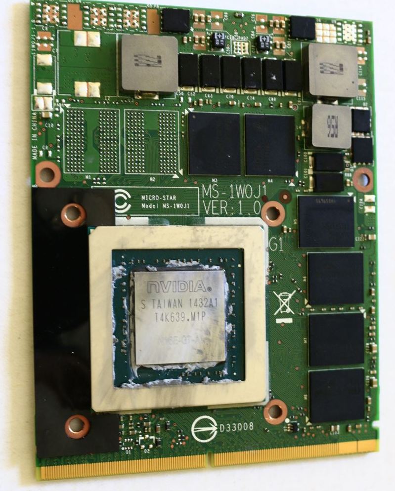

Here you see the difference between the two cards (GTX870M vs GTX970M). Anything above the RAM chips, located at other positions.
GTX9**M Heatsink:
[ATTACH=CONFIG]13005[/ATTACH]
[ATTACH=CONFIG]13006[/ATTACH]
[ATTACH=CONFIG]13007[/ATTACH][ATTACH=CONFIG]13008[/ATTACH]
