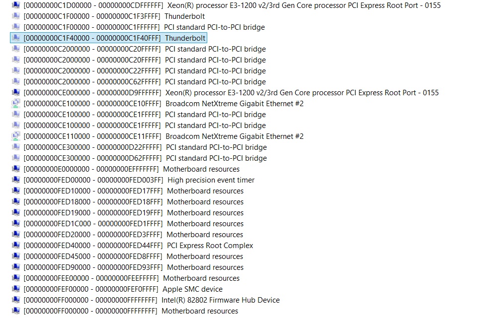

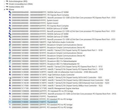

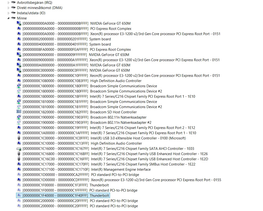

Red Onion Posted July 26, 2015 Share Posted July 26, 2015 Hi friends, I am new to this forum and unexperienced with eGPUs, so I apologise in advance for any wierd/stupid questions I might ask. Here is a list of what I'm running: Computer: Macbook Pro Retina, from 2012 CPU: i7-3820QM @ 2.7-3.7 GHz dGPU: Nvidia GT650M RAM: 16 GB OS: Windows 8.1, via Bootcamp Thunderbolt connection: 2xThunderbolt v.1 As eGPU I chose MSI GTX 980 Gaming 4G together with AKiTiO Thunder2 PCIe Box. And now, the reason I made this thread: I installed my eGPU today and encountered some software issues(?), more specifically a code 12 error that seems to be rather usual. My question is if this has anything to do with my TOLUD being >3.25 GB? I tried using the guides posted on this forum to check my TOLUD, but my Device Manager seems to differ a bit from yours. I would be grateful is someone could take a look on my pictures and tell me my TOLUD value. Secondly, if what I described above is the cause of my problem, can I fix it using the DSDT override that has been described on this forum? I found the made by Kizwan. Can I follow his procedure thoroughly to get it to work on my setup?Thank you, A confused Red Onion Quote Link to comment Share on other sites More sharing options...
