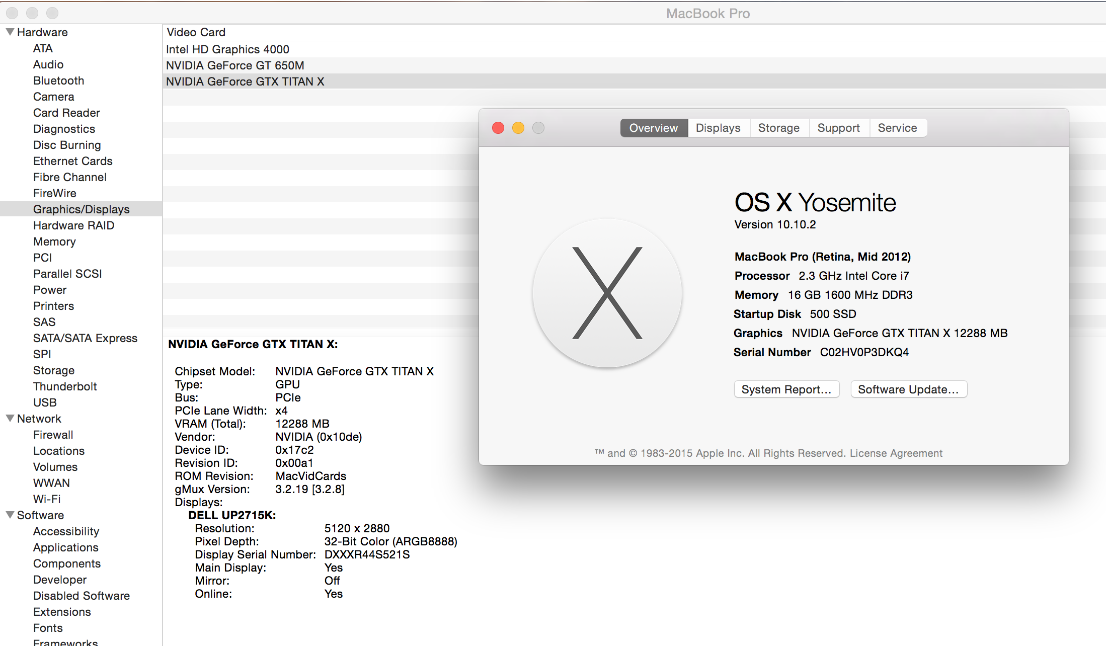

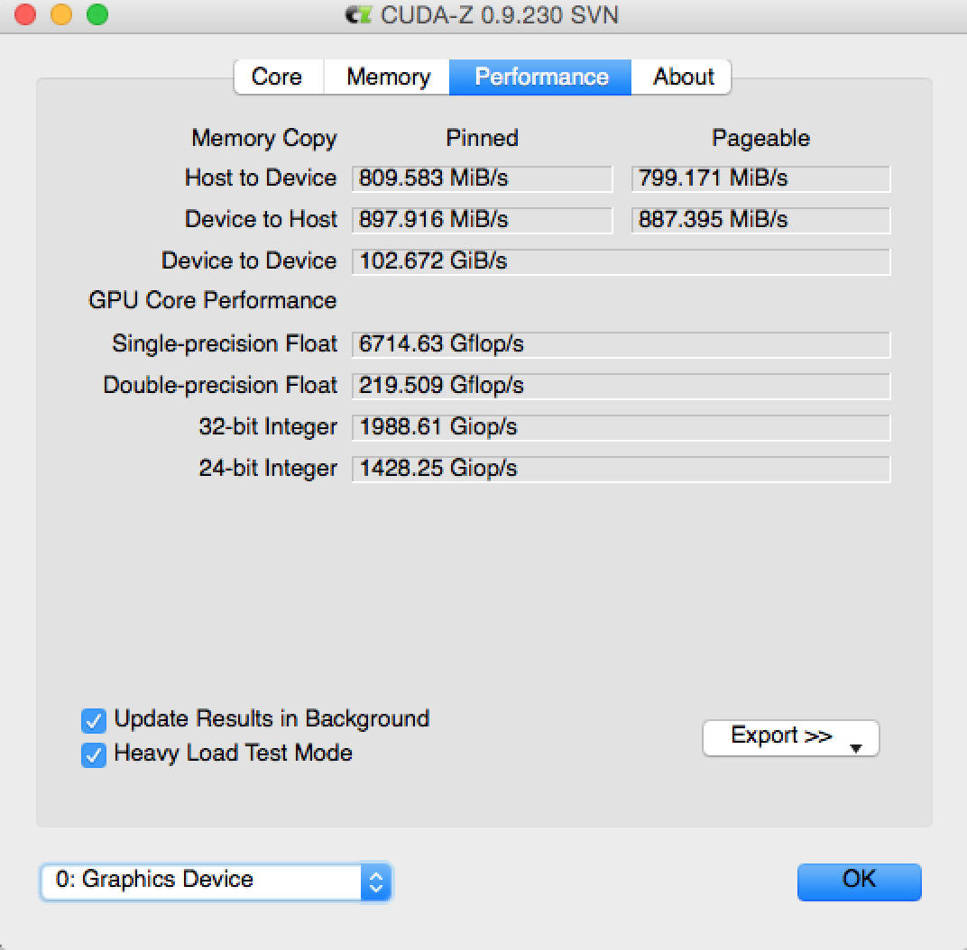

Mark Posted March 26, 2015 Share Posted March 26, 2015 FYI, got Titan-X running as eGPU with rMBP. Details and screenshots shortlyI'm looking forward to it! I've just pre ordered one as well and I'm also in the process of acquiring an Akitio box so I'm looking forward to go back to Maxwell again!Which TB2 chassis and which rMBP did you use if you don't mind me asking? Quote Link to comment Share on other sites More sharing options...
MVC Posted March 26, 2015 Share Posted March 26, 2015 as promised did I mention 5K output? Quote Link to comment Share on other sites More sharing options...
