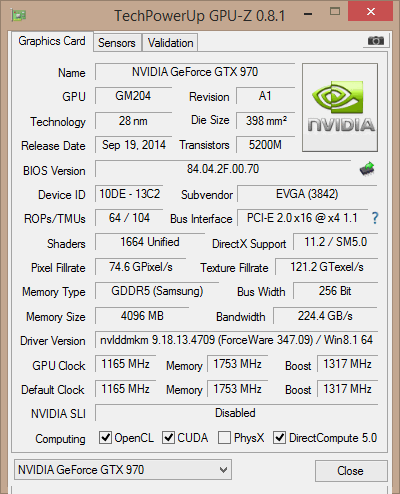

  • The EVGA GTX 970 SC ACX 2.0 is fully stable with the AKiTiO Thunder2. I managed to run a substantial suite of tests continuously for several hours without a single problem.

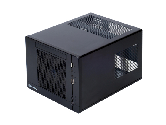

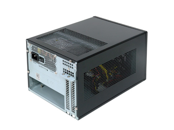

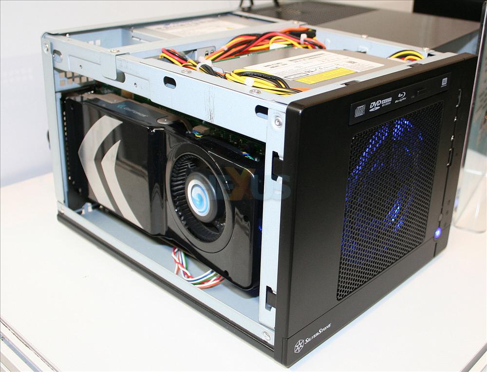

  • Enclosure - Instead of a fully custom enclosure, I've decided to go for the Silverstone Sugo SG-05. This case has a small footprint yet enough room for a 450W SFX PSU and a 10-10.5" long GPU.

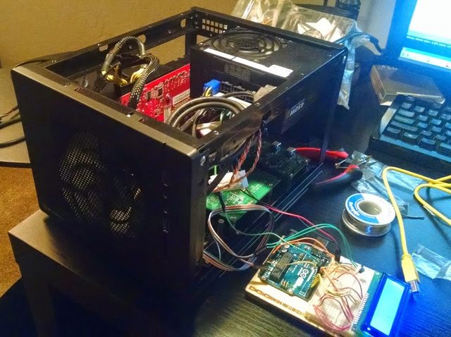

  • Mini-ITX tray for AKiTiO Thunder2 and other electronics. I'm using a laser cutter to make this out of an acrylic sheet and mount the AKiTiO's PCBs with standoffs and screws - I will post the design here once it's finalized.
  • Power and case fan speed control with Arduino. This is meant to enable power control and monitoring from the front panel buttons and LEDs. In addition to power LED and toggle switch, the Arduino will monitor temperature inside the case and adjust case fan speed accordingly. Power from the Arduino comes from the +5V PSU stand-by line.

2015-01-18: I've hooked up an Arduino Uno board to the SFX PSU using a modded 24-pin ATX connector. With some simple code, the Arduino can toggle the PSU on or off upon pressing the front power button on the SG-05 case. The Arduino is also measuring ambient temperature with a TMP36 sensor - next step is implementing the 12V circuit to drive the fan!
2015-02-24: After many fruitless attempts at stabilizing my setup with the GTX 670, I upgraded the GPU to an EVGA GTX 970 SC ACX 2.0 (04G-P4-2977-KR). Preliminary stress tests running Firestrike on a loop showed no stability problems. I will continue running a full set of benchmarks with the new GTX 970 and post the results here soon.
2015-03-01: First set of benchmark results with the GTX 970 show much improved stability and performance. I was able to run a comprehensive suite of tests over several hours without a single hiccup. My unit has considerable coil whine so I'll be returning it to upgrade it to a GTX 970 FTW+. Next steps are to run some in-game benchmarks and record some sample videos. I will also continue working on the Arduino fan/power control and will post the final design and code through Fritzing.

Sure! I wanted to be able to use the computer case's front button panel to turn the eGPU on or off. The issue is that all modern ATX/ITX computer cases come with momentary push switches to trigger power and reset but ATX/SFX power supplies require a toggle switch to connect the PS_ON pin to a ground pin in the 24-pin motherboard connector, which you can accomplish with a SWEX or using the paperclip trick. Modern motherboards accomplish this by maintaining an active circuit, even with the computer is off, and respond to a momentary press of the ON button to trigger the PSU on. Since we're not using motherboards, I needed to figure out a basic electronic circuit that would accomplish this same function so I decided that this was a good opportunity to play with an Arduino and use it to build a basic power control device for my eGPU. Since the Arduino microcontroller can be programmed to perform to a wide variety of different functions, I thought about going beyond power control and also use it to monitor temperature inside the case and control the case fan.
So far, I've put together a simple circuit with an Arduino to toggle an LED upon pressing a button (see here) and to measure ambient temperature (a barebones version of the "Lover Meter" starter kit example
). I then made a custom ATX 24 pin adapter following these instructions. I then hooked up the Arduino to the stand-by +5V supply from the SFX PSU, replaced the push button on the breadboard with a connection to the SG-05 case power switch and then I connected a line to the PS_ON pin instead of the LED. The same code that controlled the LED now switches the PSU on or off. You can't use the the Arduino's USB while it's hooked up to a separate 5V supply so I had to wire up an LCD module to display the temperature readings and the PSU state while everything is running off the SFX PSU but I'll probably remove the LCD once I'm happy with the design.
For now, here's a short video to show how the current version is working:

I replaced the GTX 670 FTW with a GTX 970 FTW+ and stability has improved by leaps and bounds. The system is now completely stable and performance is great! With the latest Windows updates (Feb 2015) the Intel GPU on the Macbook Air is no longer disabled at boot so Optimus is now possible without compromising any functionality. Here is a snapshot of Optimus in action:
