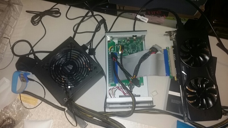

I just got everything I need for this egpu project, psu, graphics card, riser, akitio thunder2, laptop, external moniter. I have a asus g750jx laptop and a asus vg248qe moniter. The problem that I have is that my graphics card won't turn on. Anyone know of a fix for this? Evga gtx 980.post-34291-14494999673275_thumb.jpg
Yes the psu is on, the powered riser is turning on the akitio, so there's no need for the akitio psu. Yes I am using the paperclip trick. I need to use the powered riser because my graphics card needs 225 watts. I believe I have found the problem but I don't know how to fix it. The blue led on the akitio is not turning on, therefore indicating that it does not detect the graphics card, in return not giving it power. Does anyone know how to fix that?
I just got everything I need for this egpu project, psu, graphics card, riser, akitio thunder2, laptop, external moniter. I have a asus g750jx laptop and a asus vg248qe moniter. The problem that I have is that my graphics card won't turn on. Anyone know of a fix for this? Evga gtx 980.[ATTACH=CONFIG]14394[/ATTACH]
The mini yellow/black power cable connecting the two AKiTiO boards looks weird in your picture, almost like it's cut. Can you confirm that it's intact and connected?
The blue LED on the AKiTiO is indicative of a Thunderbolt link being established and it should turn on as soon as you machine boots up while connected to the AKiTiO box, even without a GPU. Try connecting the AKiTiO with its original power brick and just the Thunderbolt cable (no ATX PSU, riser cable or GPU) and try turning on the laptop - the blue light should turn on. If it doesn't then it could be a problem with the Thunderbolt connection.

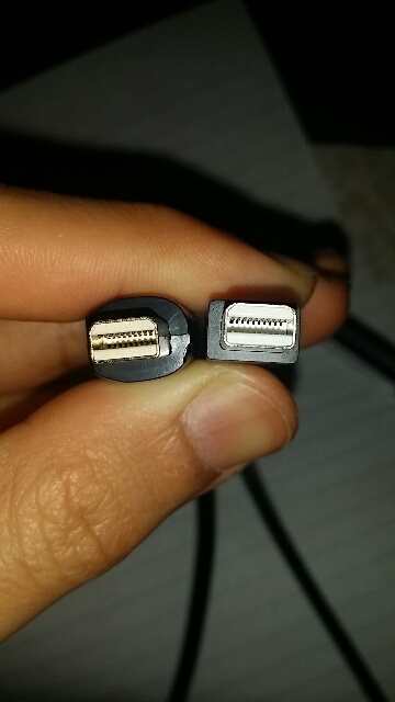

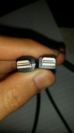

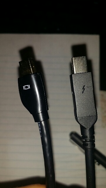

I have found out that the blue led did not light up because it needs to be connected via the Thunderbolt cable they included, I was using my own. Just wanted to let you guys know so you don't have the same problem that I did.
Are you sure your own Thunderbolt cable actually is a Thunderbolt cable? It may be a mini-Displayport cable. They have the same connector and thus look the same, yet they aren't the same inside.
Oh, your right it is a mini display port cable. I have a question, should i get a gtx 980 or a 970? The 970 is much cheaper but the 980 is more future proof. I'm stuck deciding which to get, Once i hear your responses, I will buy that graphics card and keep you posted when i get the card.

Yeah I can see why it's easy to confuse the mini DisplayPort and Thunderbolt cables - just keep an eye out for the Thunderbolt symbol on the plug.
