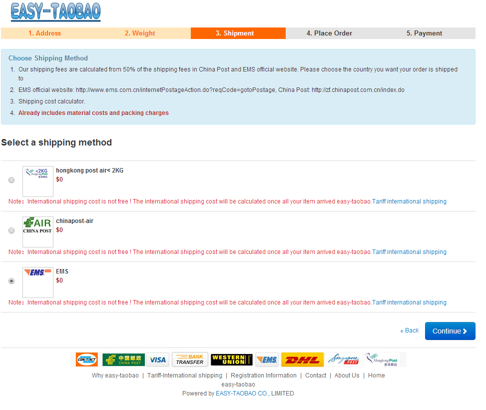

noric Posted May 30, 2014 Share Posted May 30, 2014 Free shipping?EXP GDC Laptop External External PCI-E graphics card Expresscard Set - China shopping? taobao agent ?Buy from China shop online website Quote Link to comment Share on other sites More sharing options...
jacobsson Posted May 30, 2014 Author Share Posted May 30, 2014 Free shipping?EXP GDC Laptop External External PCI-E graphics card Expresscard Set - China shopping? taobao agent ?Buy from China shop online websiteDamn, I'm checking this right away, if true: nice find buddy! Quote Link to comment Share on other sites More sharing options...
noric Posted May 30, 2014 Share Posted May 30, 2014 It's cloudhero, as usual. The product appears to be the complete set (with Dell DA-2), if you click the link to taobao provided in that page. The only thing is that it says 500g as weight... Quote Link to comment Share on other sites More sharing options...
jacobsson Posted May 30, 2014 Author Share Posted May 30, 2014 It's cloudhero, as usual. The product appears to be the complete set (with Dell DA-2), if you click the link to taobao provided in that page. The only thing is that it says 500g as weight... No they are just trolling, the shipping will be calculated after the item arrives at Easy-Taobao: Quote Link to comment Share on other sites More sharing options...
noric Posted May 30, 2014 Share Posted May 30, 2014 That 0$ EMS shipping looked a bit suspicious... Quote Link to comment Share on other sites More sharing options...

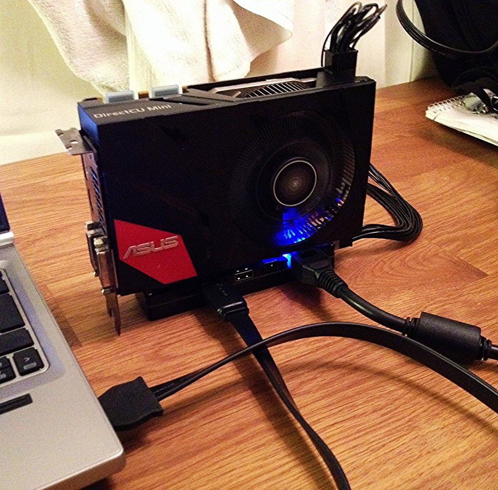

rubayethk Posted May 30, 2014 Share Posted May 30, 2014 @rubayethk1. Yes, the dGPU needs to be disabled in order to have Nvidia Optimus compression, aka x1.2opt.2. Depending from system to system it can vary in which stage you are supose to connect the eGPU:NOTE: I'd start with connecting it inside windows first and see if it recognized, secondary would be after BIOS post screen, or halt at win boot logo and start eGPU from there.3. After the 'standard VGA-adapter' gets installed it'll require a reboot, but first unplug the EC-card (or read NOTE), then reboot to system to windows again, insert EC-card again and install NVIDIA drivers.NOTE: There is a 2-way reset-delay switch on the EXP GDC (look at front-top-left side), one of the settings should enable you to reboot w/o ejecting the EC-card.4. Good to hear about the TOLUD, with a large TOLUD you won't have to do any DSDT override. Sounds like you have a plug n play setup here.--------------------------------------------------------------Post your here results later on =)GLHFEDIT: I'd warmly recommend to buy a Asus mini GTX670, covers the adapter perfectly =)[ATTACH=CONFIG]11744[/ATTACH]Thanks for the info. One more question. Do connect your external monitor from your laptop or from the egpu ? Does it make a difference ? I don't see a connection in your picture. Thanks Quote Link to comment Share on other sites More sharing options...
jacobsson Posted May 30, 2014 Author Share Posted May 30, 2014 Thanks for the info. One more question. Do connect your external monitor from your laptop or from the egpu ? Does it make a difference ? I don't see a connection in your picture. ThanksThe picture displays internal screen usage. Using external screen gives much better performance since the data signal only travels one way: System -> eGPU -> External monitorCompared to internal screen round trip:System -> eGPU -> System -> Internal screenYou can see here that the bandwidth gets rather limited due to counter traffic at the same link. Quote Link to comment Share on other sites More sharing options...
