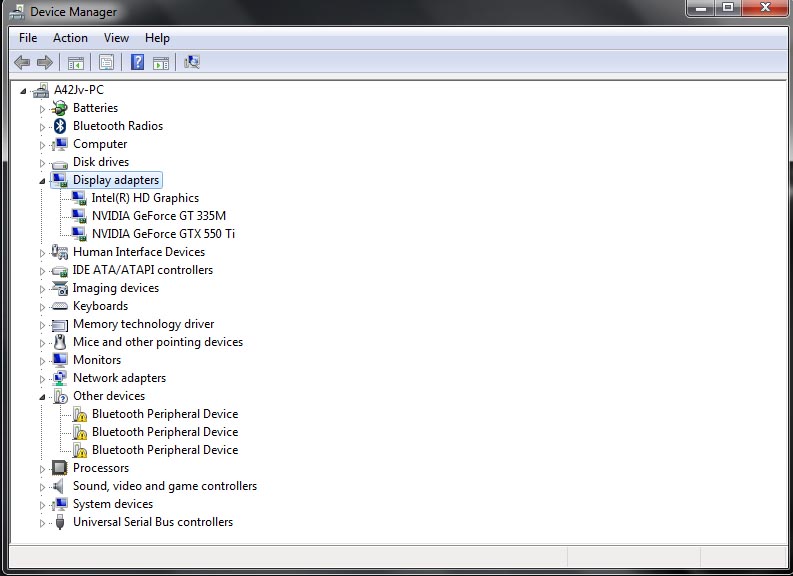

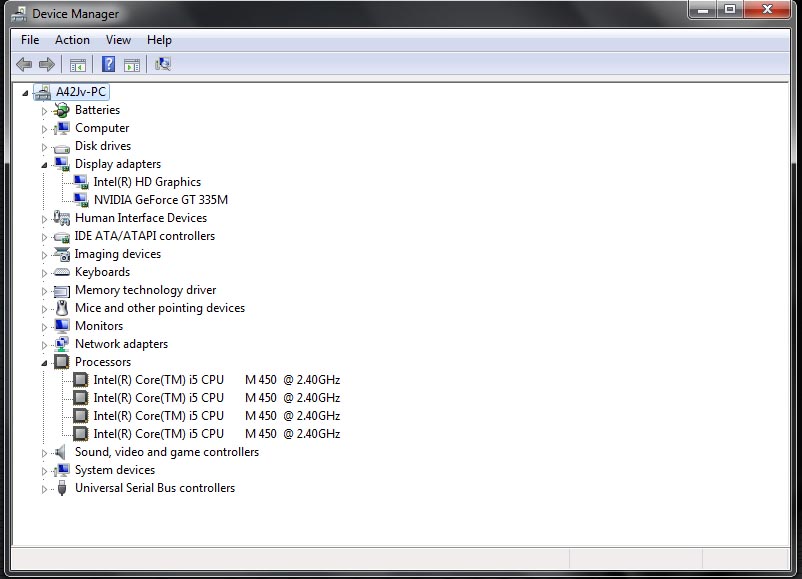

Thanks Mr_Western for the reply, here is my laptop specs:
Asus A42Jv
Intel i5 450M 2.4Ghz
8Gb ddr3 ram Kingston
120GB Kinsgton SSDnow
Intel HD Graphics (1st Gpu)
Nvidia GT 335M (Secondary Gpu)
Link : http://www.laptopspec.net/2010/05/asus-a42jv-vx040d-14-inch-laptop-with-core-i5-450m-geforce-gt-335m/

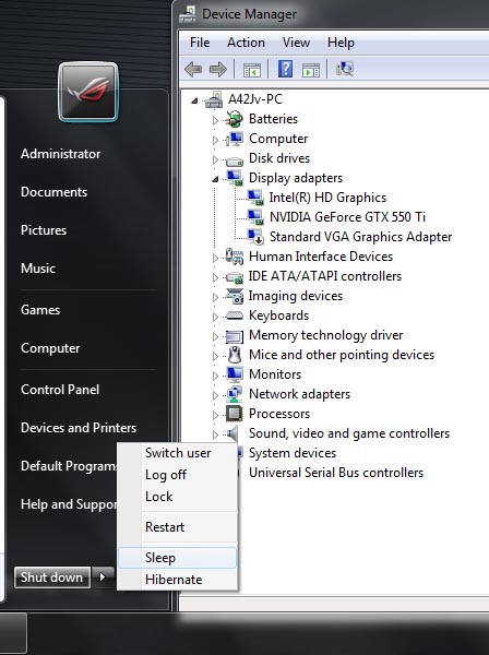

UPDATE1:
UPDATE2:
Now my laptop can sleep and the dedicated gpu (gt335M) disabled completely. Right now I just want my laptop display to use the external gpu (gtx550ti). Does anyone can suggest how to do this. Thanks in advance.
Edited by tiubxray
update

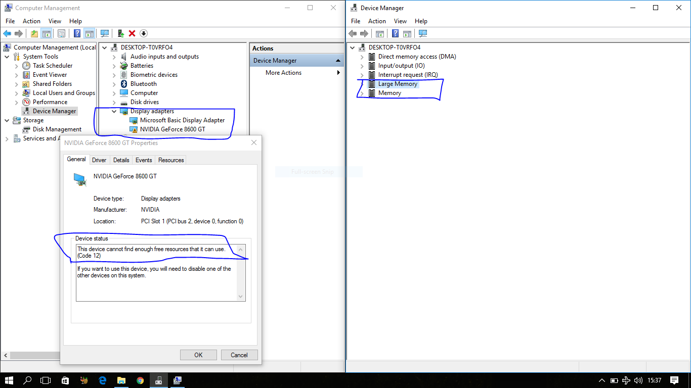

Hello, I've been having a weird issue with my EXP GDC BEAST (Expresscard), some GPUs for whatever reason, don't quite work.
So far:
8600GT: Works - Code 12
9600GT: Doesn't work
HD 6750: Works - Code 12
GTX 750 Ti: Doesn't work
GTX 680: Doesn't work
When I say doesn't work, it doesn't detect under windows and the fans spin up to the max RPM.
Also, I used two methods of doing the DSDT Override (not using setup 1.30) and none of them worked, I still have the Code 12 error for whatever reason. (Yes I have large memory enabled and Test mode).
I got someone who has set it up once for his laptop troubleshoot it with me and no luck yet.
HP Elitebook 8570P | Core i7 3610QM | 8GB DDR3 (4x2) | 192GB Toshiba SSD | Intel HD 4000 | Windows 10 Pro 64 Bit
Any help would be appreciated. Thanks!
@tiubxray
Are you sure your laptop GPU is properly disabled, if you are seeing it in your device manager it is not disabled properly. However, to display to your external screen, press (windows key + P) and select external monitor; or you can go into NVIDIA control panel and select the external display.
On 1/30/2017 at 5:04 AM, Mr_Western said:
@tiubxray
 Yes, the dGpu disabled completely. The gtx550ti works well via external monitor, but I want to use laptop display as primary display. Any suggestions?
