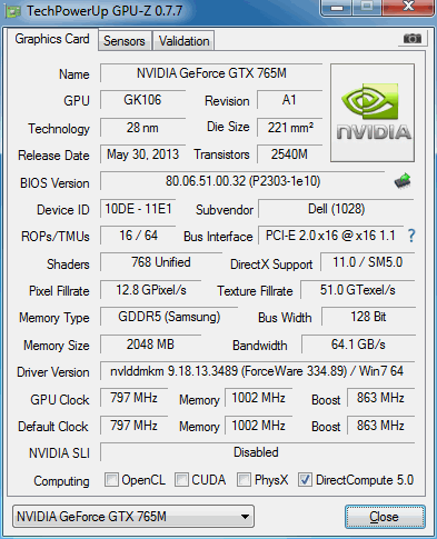

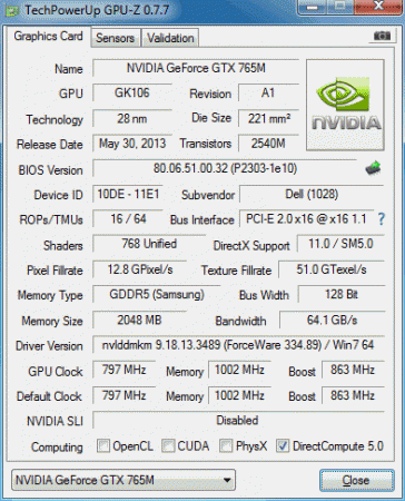

Kephra Posted March 23, 2014 Author Share Posted March 23, 2014 Appears I might not be quite as successful as I thought. Ran a citrix session, and locked the computer up with a grey screen after the remote system seemed to be loading fine. And when I look at GPU-Z (thanks, btw!) I seem to be missing physx and cuda support (which I thought sure the 765M could do). Here's my output: Worse, that side's fan doesn't seem to be working. I looked at the graphs in Z after looking at a brief game session (to see if games were working) and noticed the temp was at 53, and the fan 100%, but I didn't hear much fan action. Checked with my hand and the CPU side fan was running but the video side was not and the vents were hot to the touch. Flipped it on its side, removed the base cover, and the fan supporting the video heatsink is not spinning at all. Wires look fine. Ideas? Quote Link to comment Share on other sites More sharing options...
svl7 Posted March 23, 2014 Share Posted March 23, 2014 GPU-Z doesn't display correct fan readings for notebooks. Can I get a copy of your vbios? Quote Link to comment Share on other sites More sharing options...

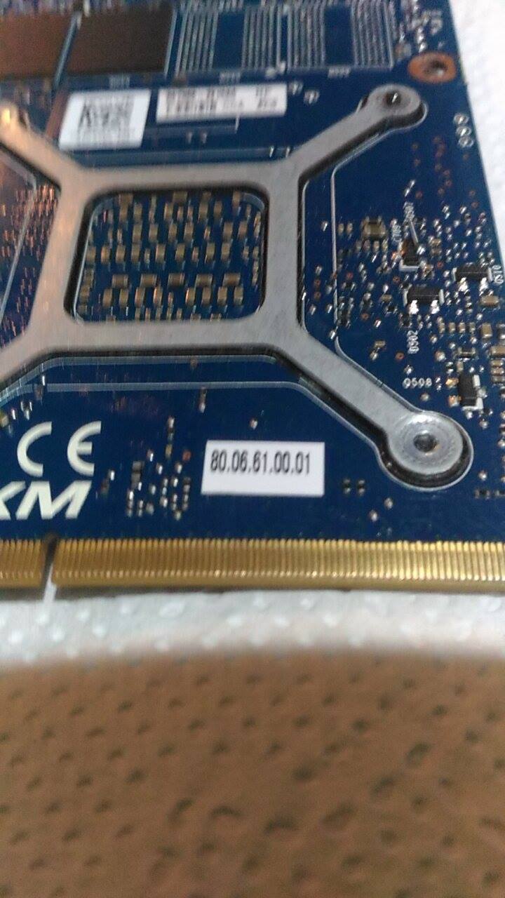

azshalsa Posted May 3, 2017 Share Posted May 3, 2017 (edited) On 2014-3-13 at 1:57 PM, Kephra said: Process Installed unlocked A12 BIOS after restart: uninstalled IDT audio package from control panel->programs->uninstall Rebooted Shut down, went to bios, disabled integrated HD audio. Set video from SG to PEG to disable integrated HD3000. Hello, i'm stuck on this part. i got alread disble hd audio, set video from SG to peg and put 765m on it. But i could even get on bios, just 8 beeps any idea? This 765M is fully working, was used on my m15 R2, on my m17x R2 and no on M17x R3. Never updated Vbios. @svl7 sorry about tag u, but this topic is so dead. And maybe u could help me i tryed motherboard reset, pushing powerbutton without power. And now I just got black screen, no beeps anymore. And i noticed this 765m Vbios are different from yours, this could be the problem ? Look that labe behind gpu, that is my vbios. Edited May 4, 2017 by azshalsa Quote Link to comment Share on other sites More sharing options...
Zoldago Posted May 4, 2017 Share Posted May 4, 2017 Have you disabled the integrated Intel graphic? Quote Link to comment Share on other sites More sharing options...
azshalsa Posted May 14, 2017 Share Posted May 14, 2017 yes, i did! Quote Link to comment Share on other sites More sharing options...
